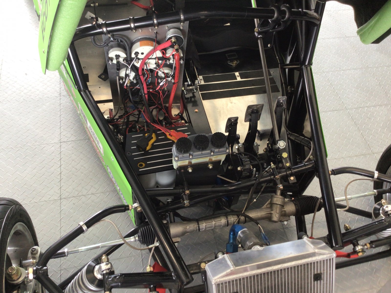

which one did you get, there are so many different ones.
This is what I'm running right now. It fits on top of the steering column and below the hood.
