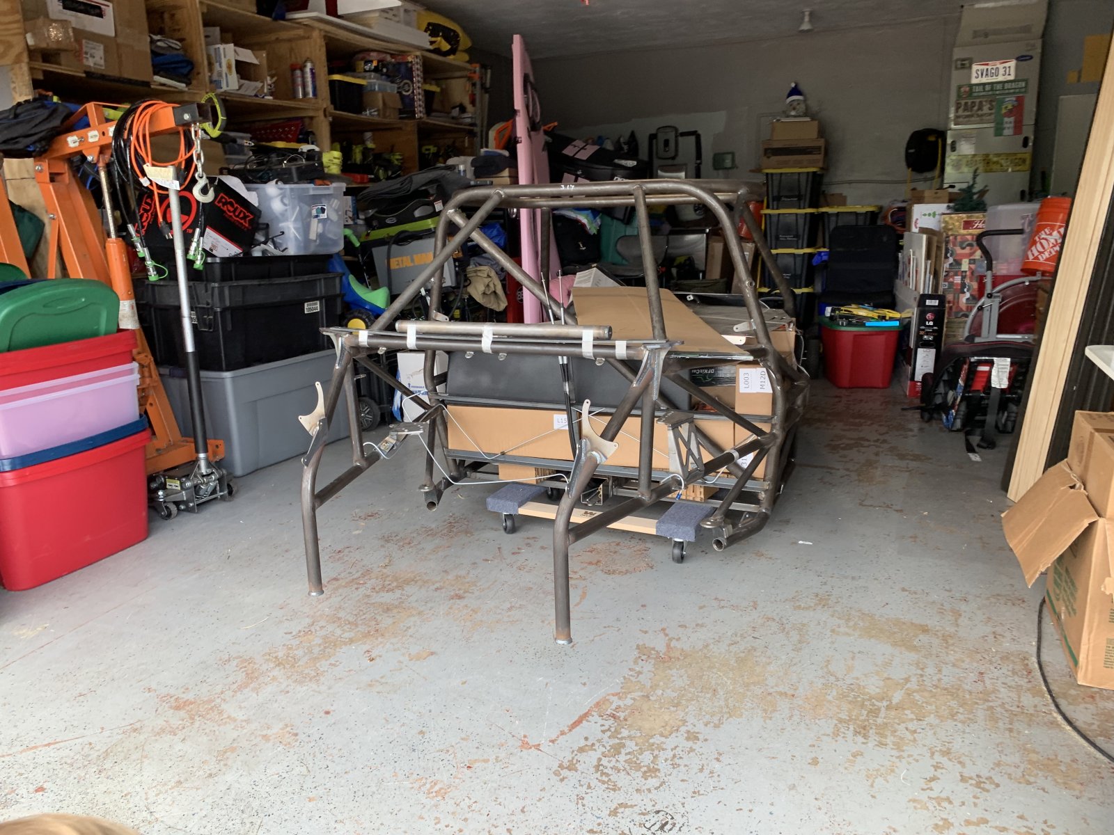

I have always wanted to build a car from scratch, but only recently have felt like I could actually do it. I found the Goblin by pure accident. The first time I saw the Goblin was in early 2020. I wasn’t looking for a kit, I just happened to stumble upon it. I don’t even remember what I was looking for, but I found the Goblin web page and bookmarked it. I started reading up on it and decided it was a kit I was going to build.
I joined the forum in September of 2020 and bought my donor in November of 2020. I ordered my kit in December of 2020, and then when DF called to let me know my time had come, I couldn’t do it. My life had taken quite a few turns in that 3 months and the timing just sucked. (Read about that HERE). But the folks at DF held my frame #, were very gracious and now, almost a year later, my time has finally come.

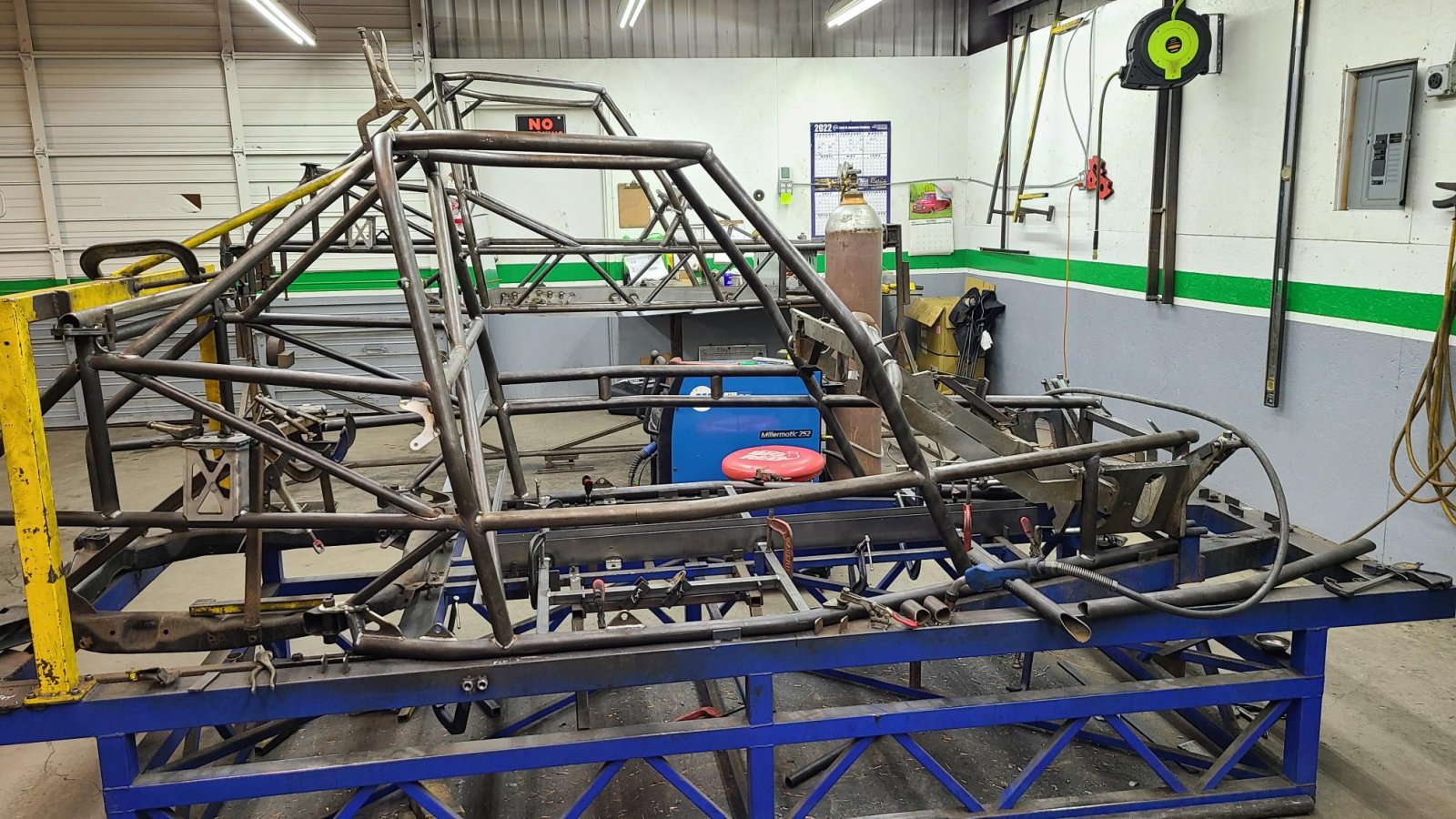

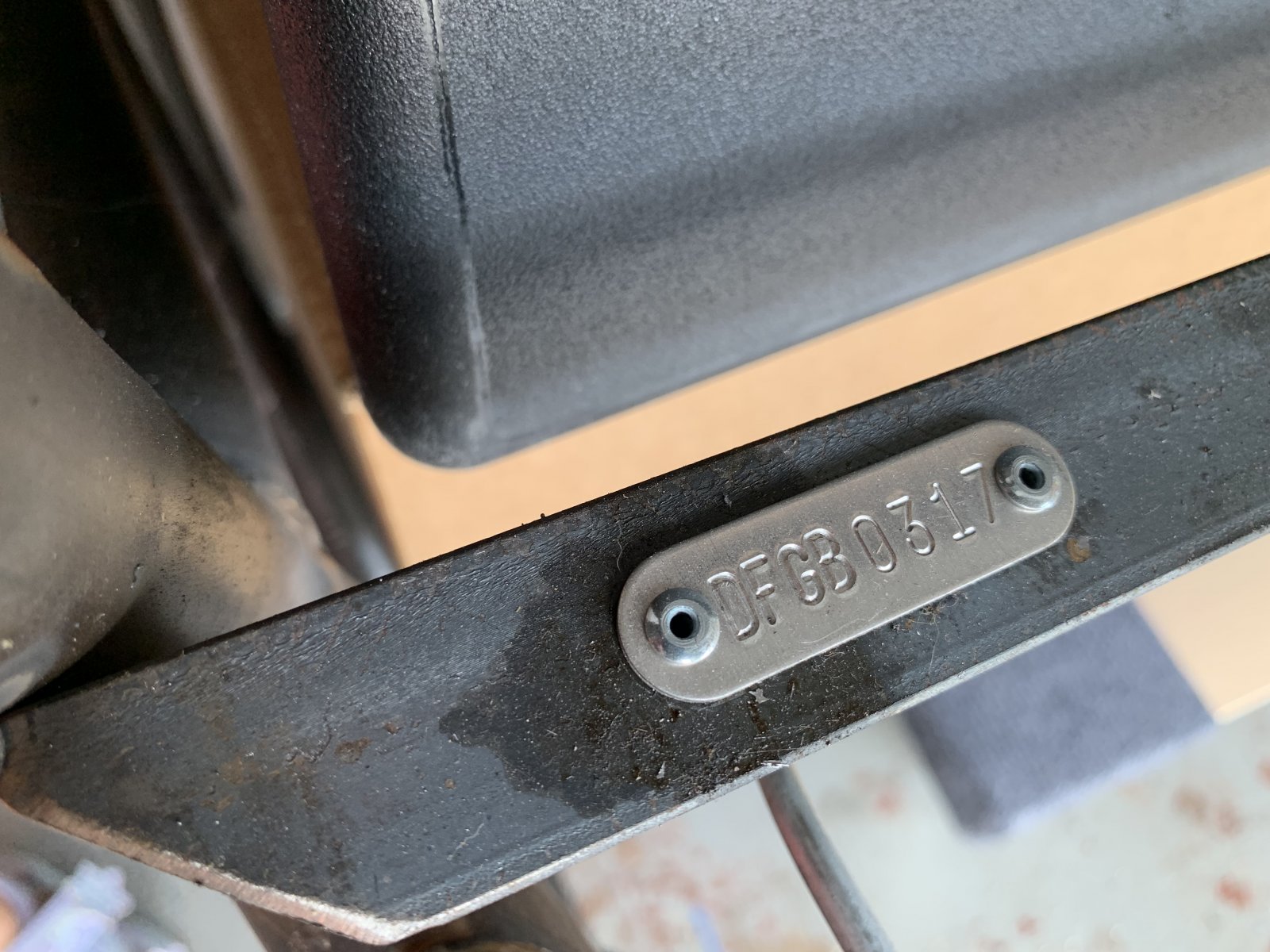

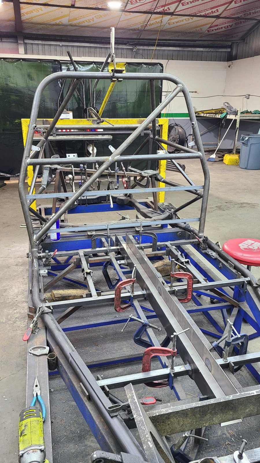

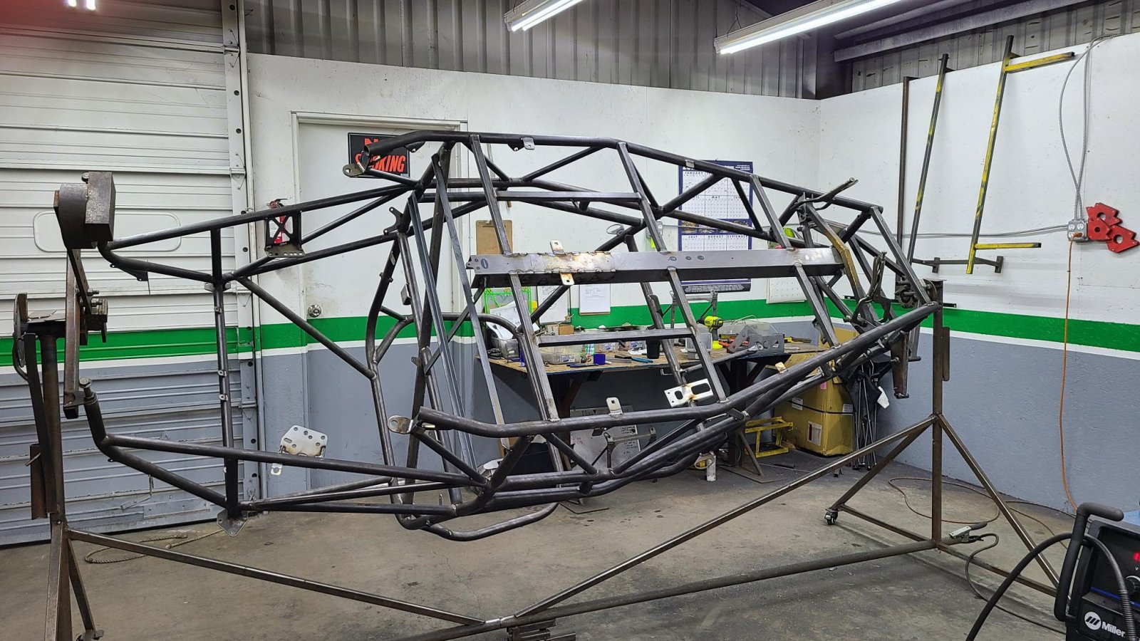

Kit #317 is mine and it hit the Jig TODAY!!
31202
31203
Now it’s time to GET TO WORK breaking down the Cobalt!!

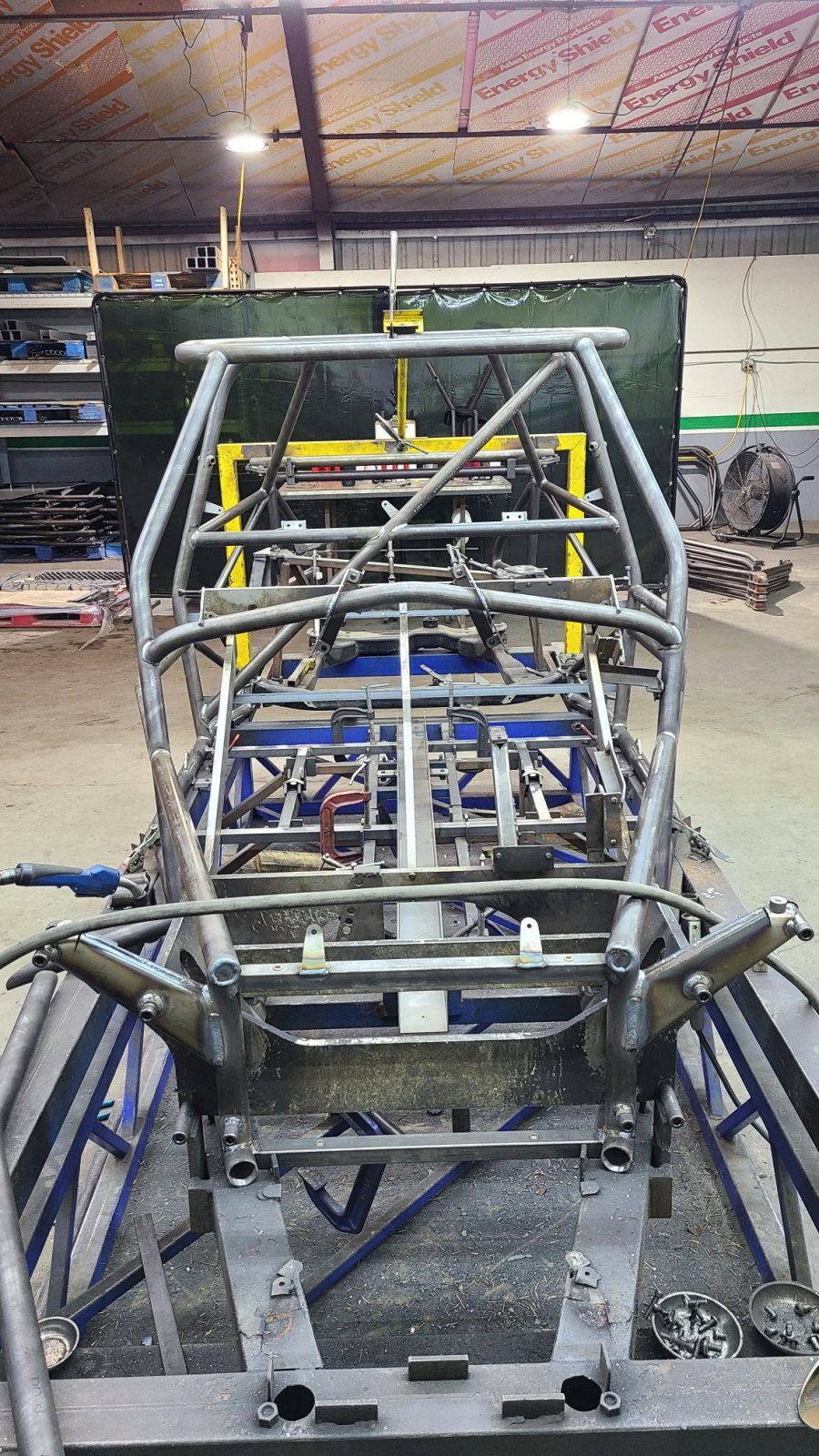

PaulPerger
She graduated from the table jig to the rotiserie... I showed my wife the photos last night and reminded her that I will be making a large payment very soon. "You and your silly cars..." was her only response. My daughters however CAN NOT WAIT to "help" Papa build the car!
31267

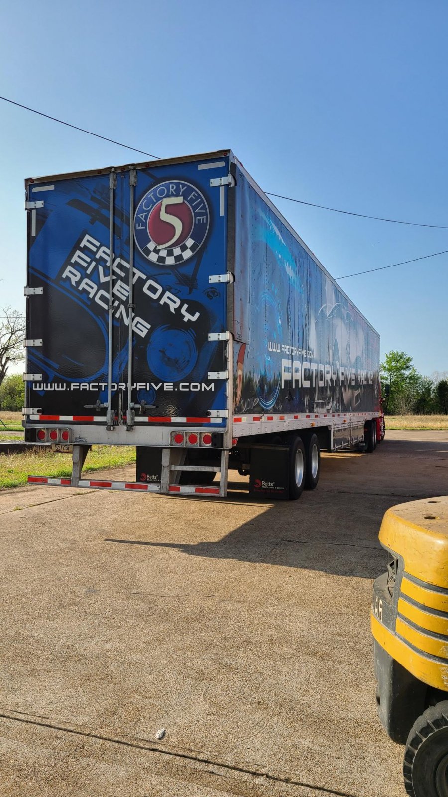

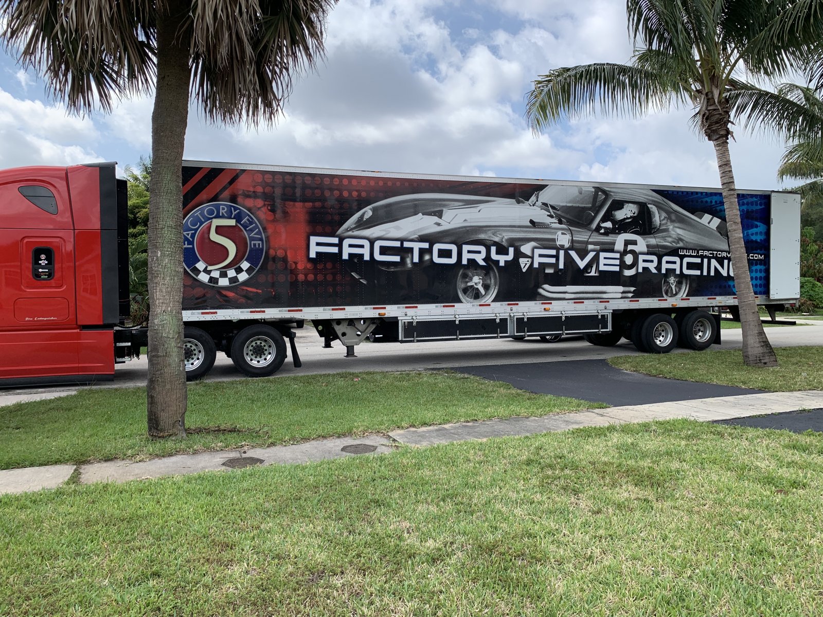

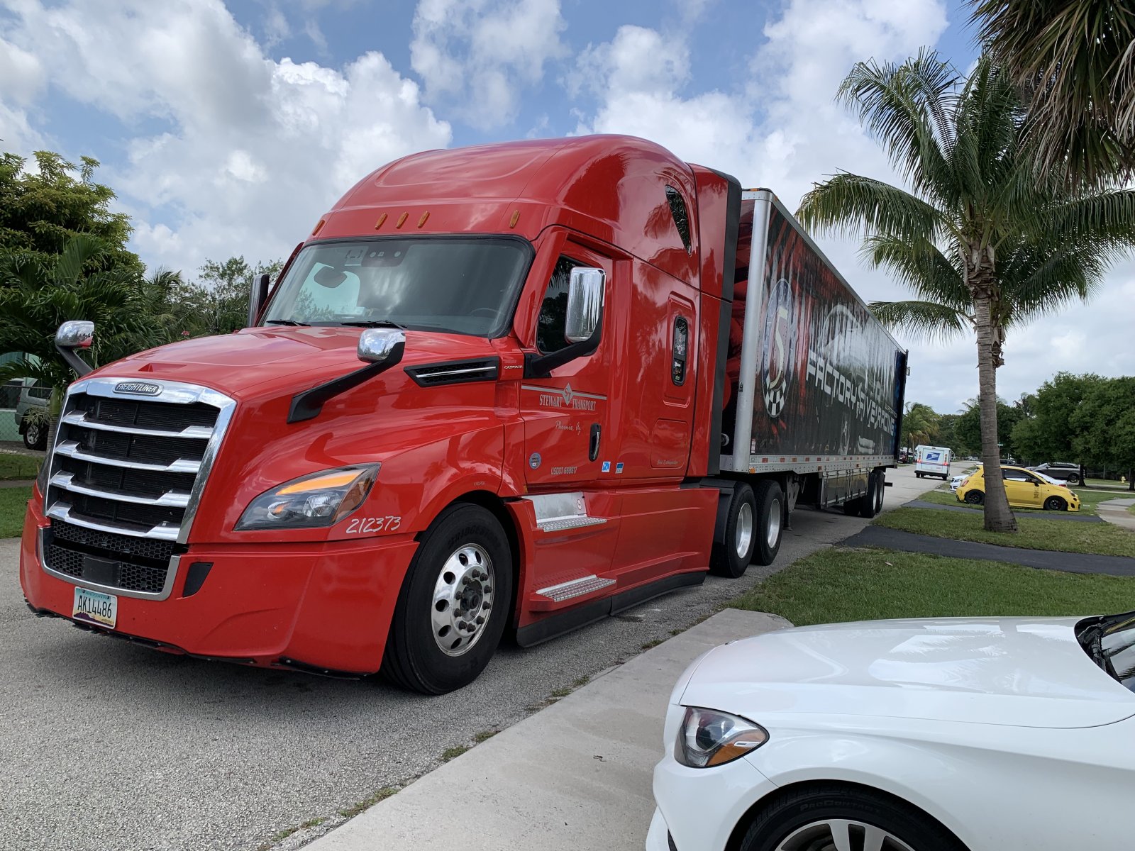

We have a GOBLIN IN THE HOUSE!!!!!
The driver called me this morning and told me he would arrive between 11 and 11:30. So I headed home at 10:55. Of course, as I am approaching a draw bridge, the light turns red and the gates start coming down. I say to myself, "it's OK. Drivers are always later than they expect to be..." Just then my wife calls and says, "There's a Factory Five Racing semi in front of our house. I told the driver he could just take it back because you aren't here to receive it!" (She will never understand my infatuation with cars like I will never understand her infatuation with JLo... She is a HUGE JLo fan.)
Unfortunately, it's going to sit for a few weeks before I attack it. I am finishing the shed in my back yard this weekend where a lot of the stuff from the garage will go to make room for working, and then I am out of town for three weekends in a row, Denver CO the 16-17, and then Cozumel Mexico the 22 - 30th, and then I will be at the Hard Rock in Miami for three days for the Miami Formula One race. So, it will be another good month before I have a real work day on the Goblin. I'll start working in the evenings. I think I can complete the breakdown of the Cobalt SS in the evenings between now and May 13th, the first day I'll be able to spend a whole day working on the car.
The obligatory Truck at the house photos:
32132
32133
32134

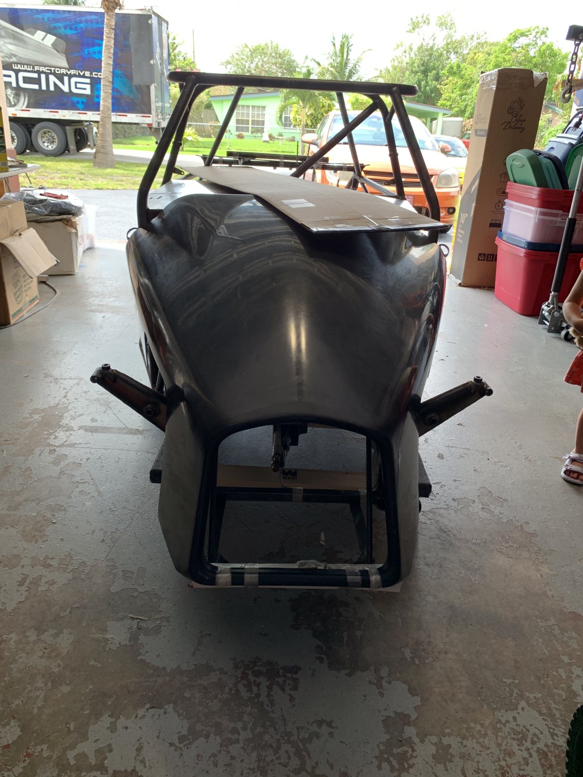

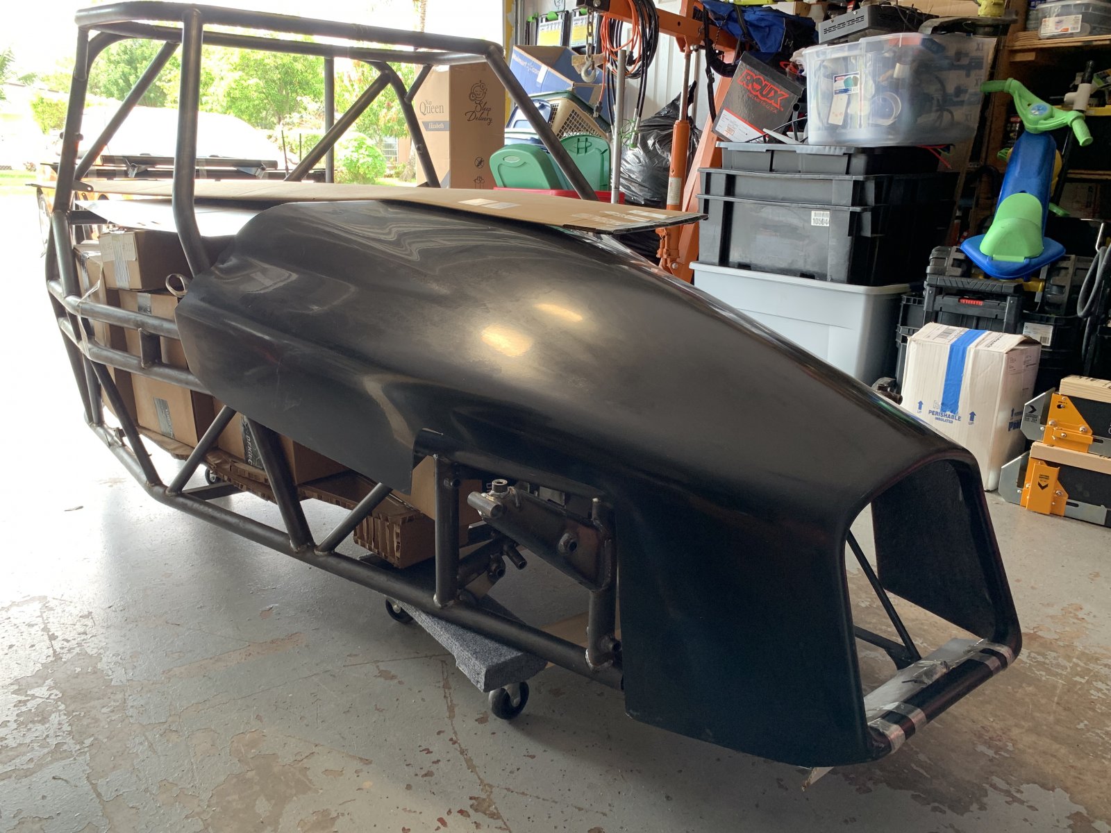

And some Just Arrived Kit in the Garage Photos... Ignore the stuff in the background... Most of it will be gone next week.
32135
You can see my donor in the background of this one.
32136
32137
32138

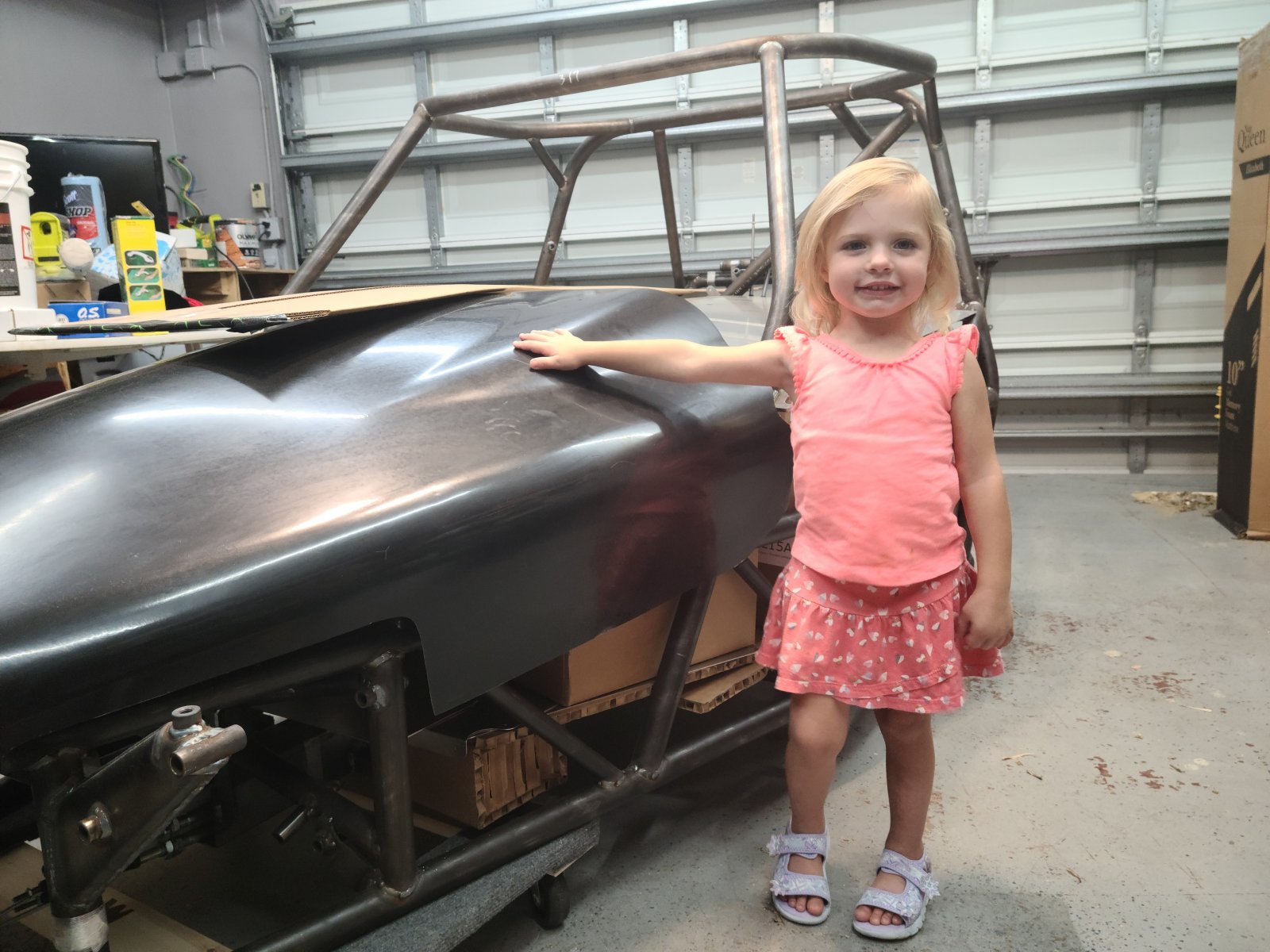

Kenna Approves... She wanted me to empty it immediately so she could "get in"... She is going to love being in the garage with me...

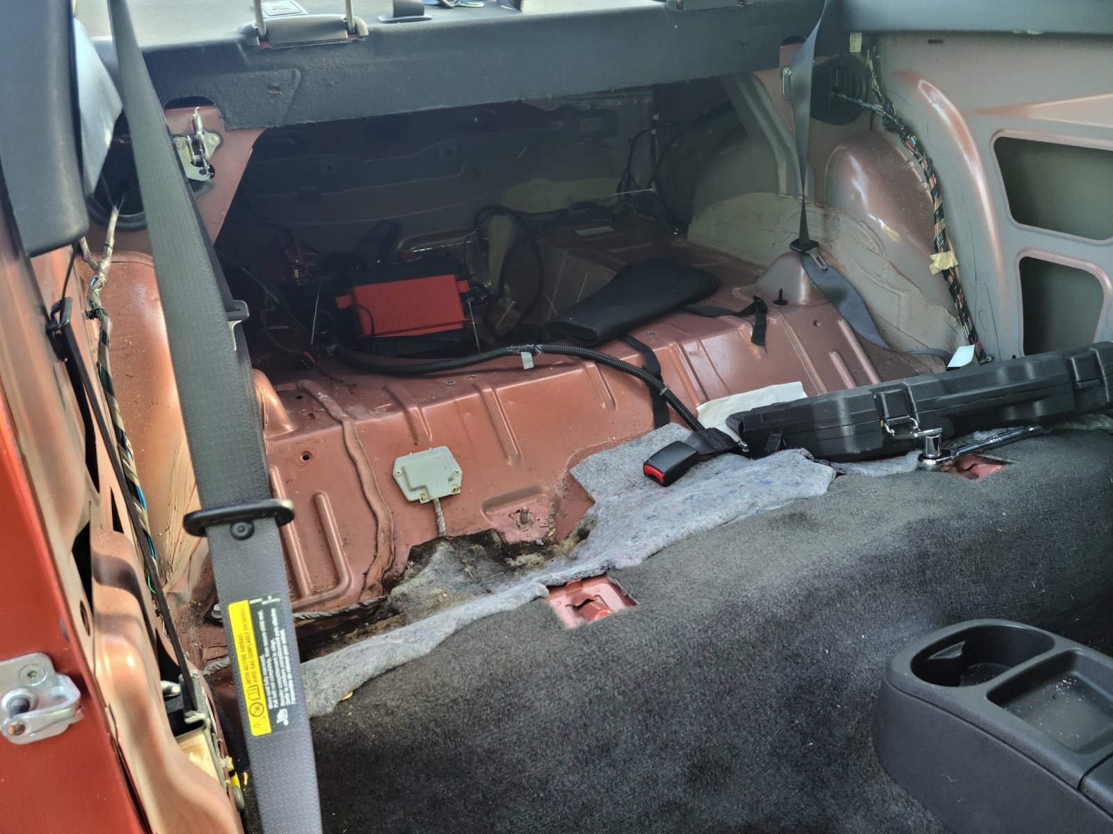

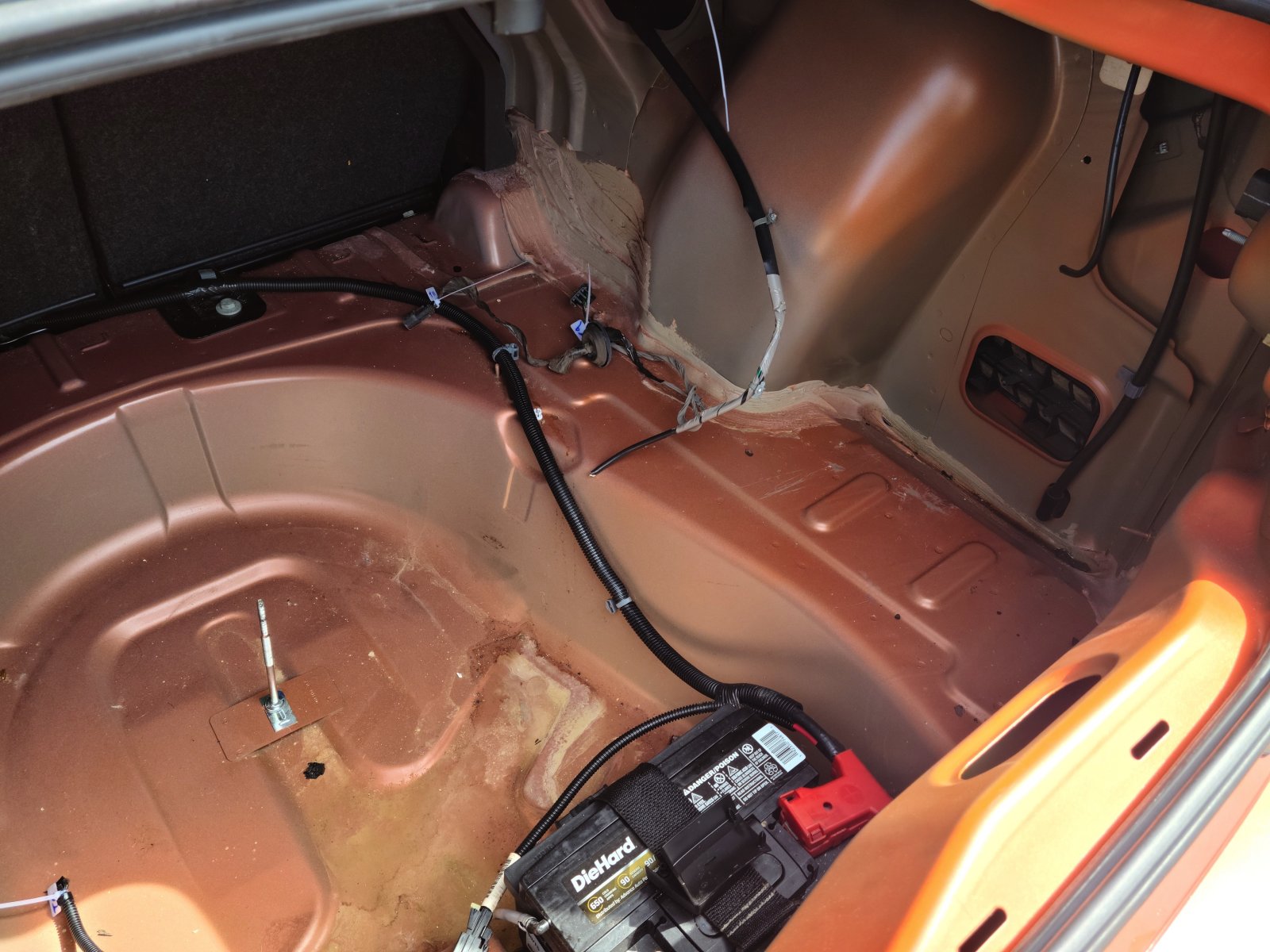

Today... The teardown began.
I still have a lot of things to do in the garage to prepare for the full tear down that I couldn't do today, so I decided to start working on the teardown of the SS. I posted a few parts on Facebook Marketplace in the Cobalt Parts & Sales page and sold the Catalytic converter (which I didn't even list) within an hour. So I added a Credits section to the Cost breakdown in the first post.
I expect the seats will go for top dollar. I, of course, had the immediate "I'll give you $50 for both front and back seats" BS. I just delete those replies. I also have two offers of $400, but neither of those folks have responded to my response yet.
I plan on doing some video recording of the process and putting it on YouTube, but I didn't record anything today. I'll record everything once I'm in the garage, but today I worked on the interior of the car in the driveway, so some photos will have to suffice.

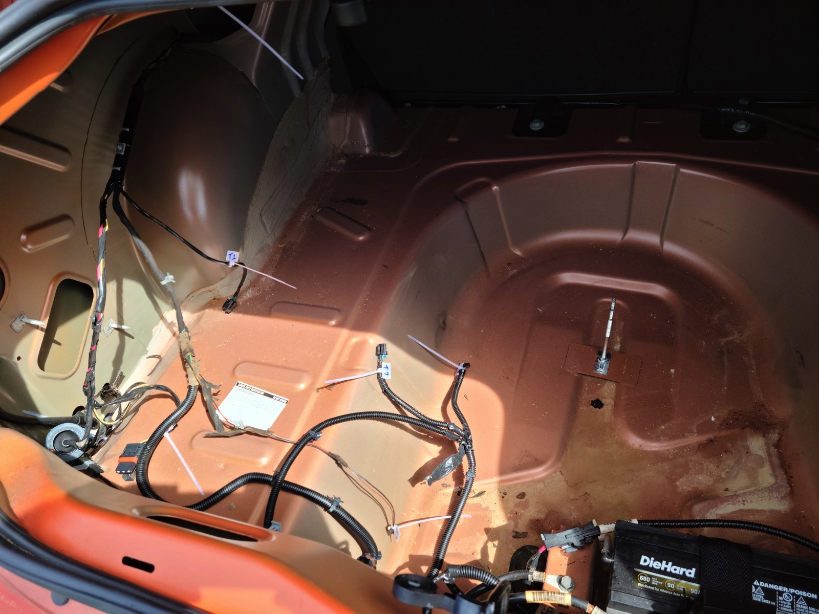

I am trying to get in the habit now of labeling every single wire connector.
Stripped the trunk... Labeled a bunch of wire connectors...

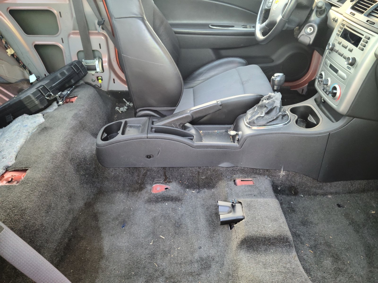

Zelda wanted to sit in the seat one more time before I pulled it out...
32231
Removed the rear seats, rear plastics, passenger seat and loosened the driver's seat in case someone calls and wants to come pick them up...
