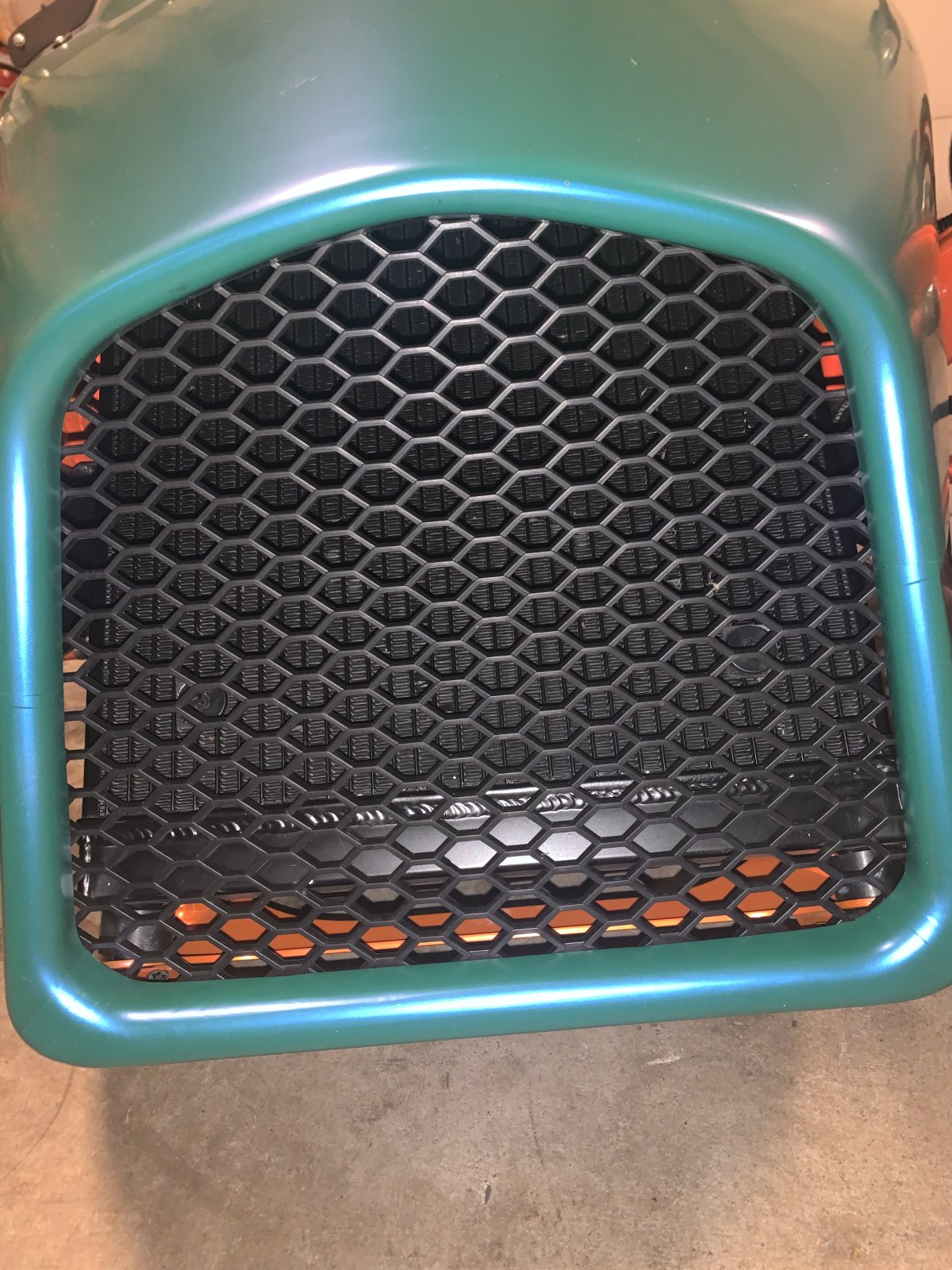

I used 1/4" washers and epoxied them in standing up in the rounded areas of the front of the nose every 3-4 inches. The nose has a curve, you will need more anchor points than you think. I then just used zip-ties to hold it in... I used a mesh from Amazon.

What pattern did you go with?
I have the same pattern as Lonnie below...thanks for the info!!
