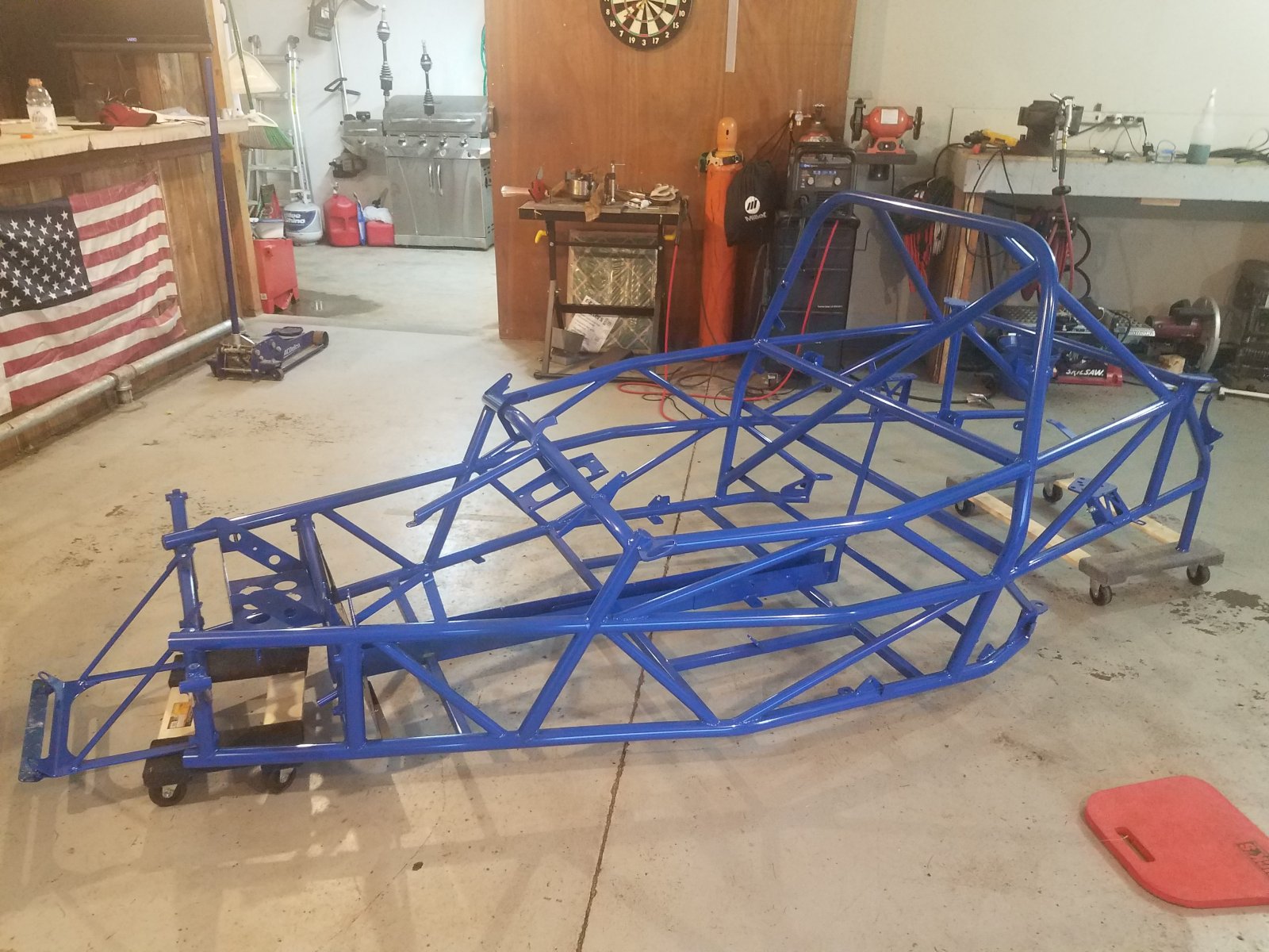

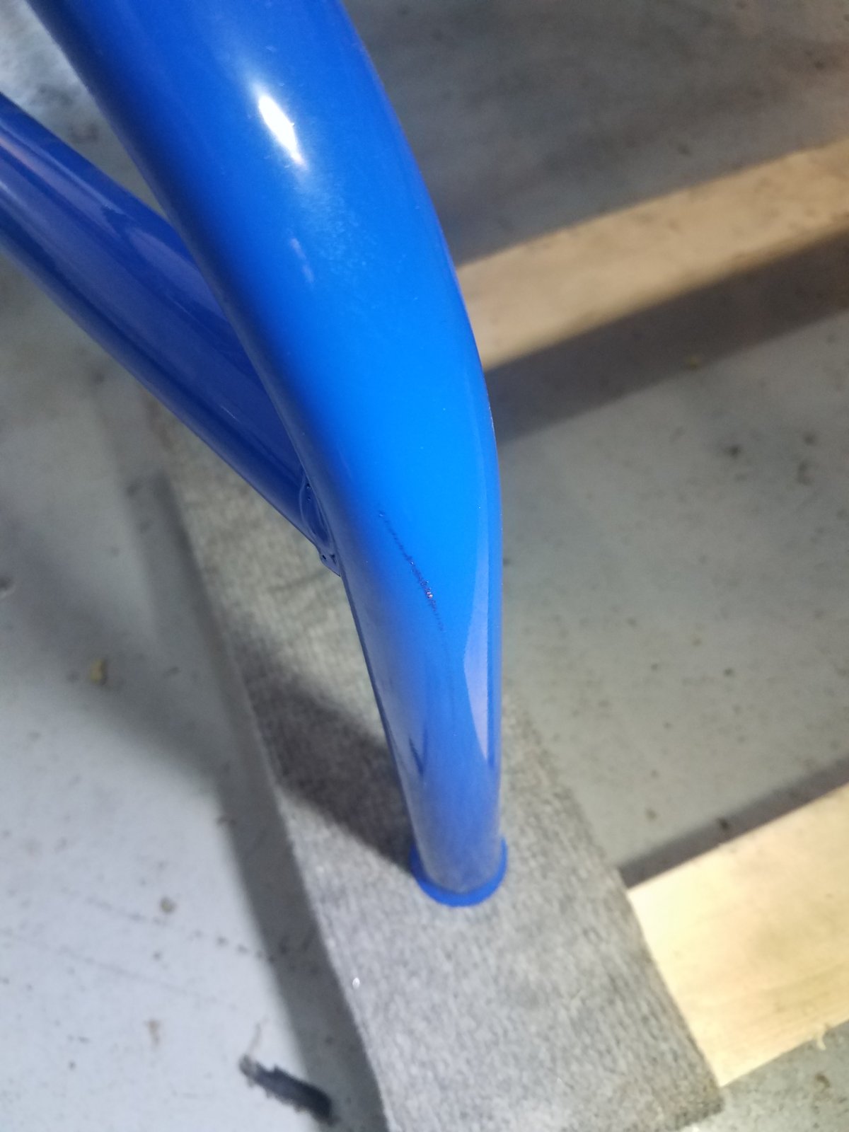

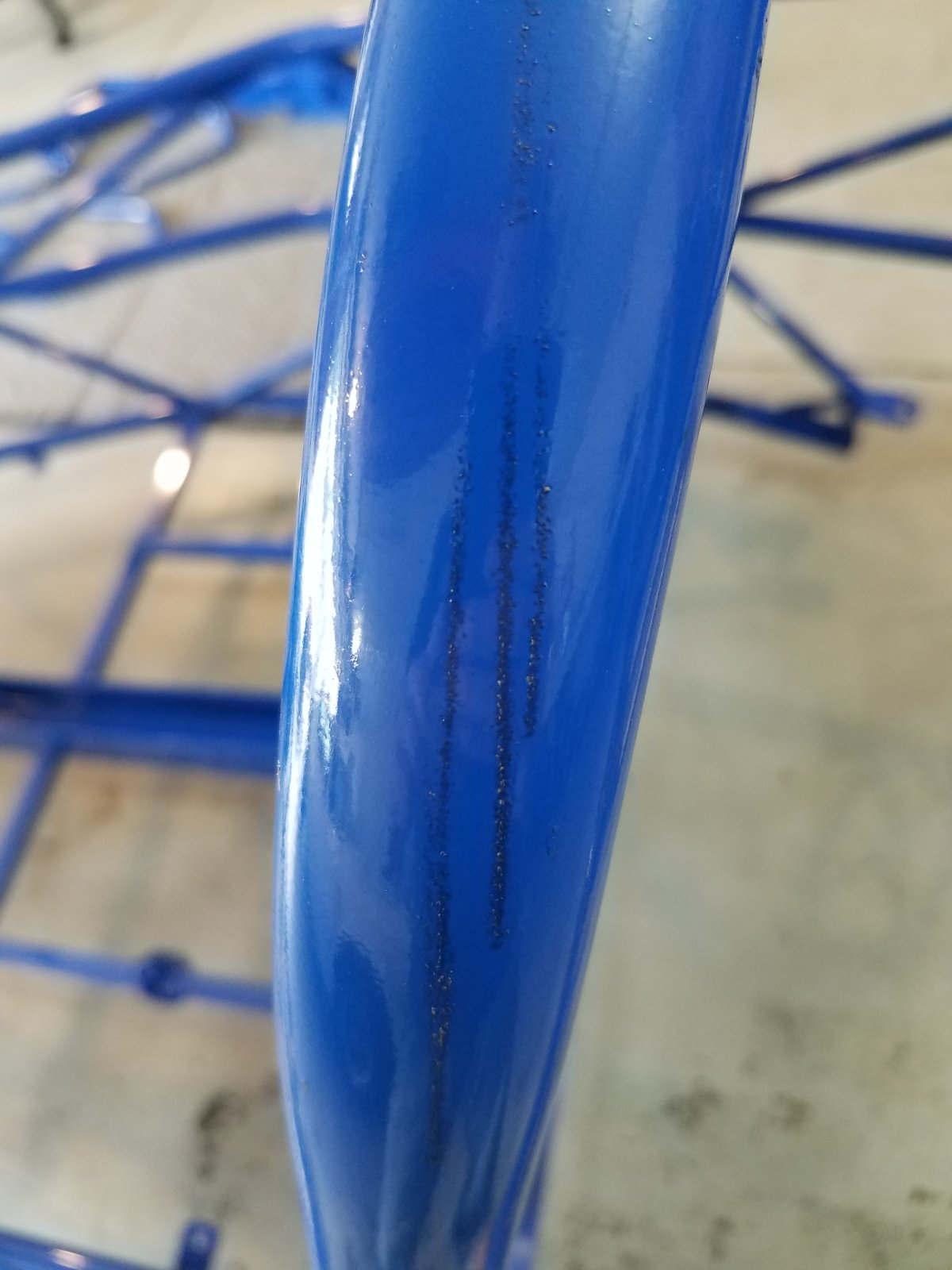

I am currently struggling with the shop I had powder coat my kit. It took 61 days from the time I dropped my parts off til they were ready because they had major issues with their new oven. When I got the frame home I noticed nasty lines in the coat.
Because powder coat cannot be touched up like paint, the whole chassis has to be basted down to bare steel and recoated.
Other than these spots I love the look of a good powdercoat job. He only charged $450 for coating everything but I wish I would have had it coated by DF. Just my personal experience is all.
