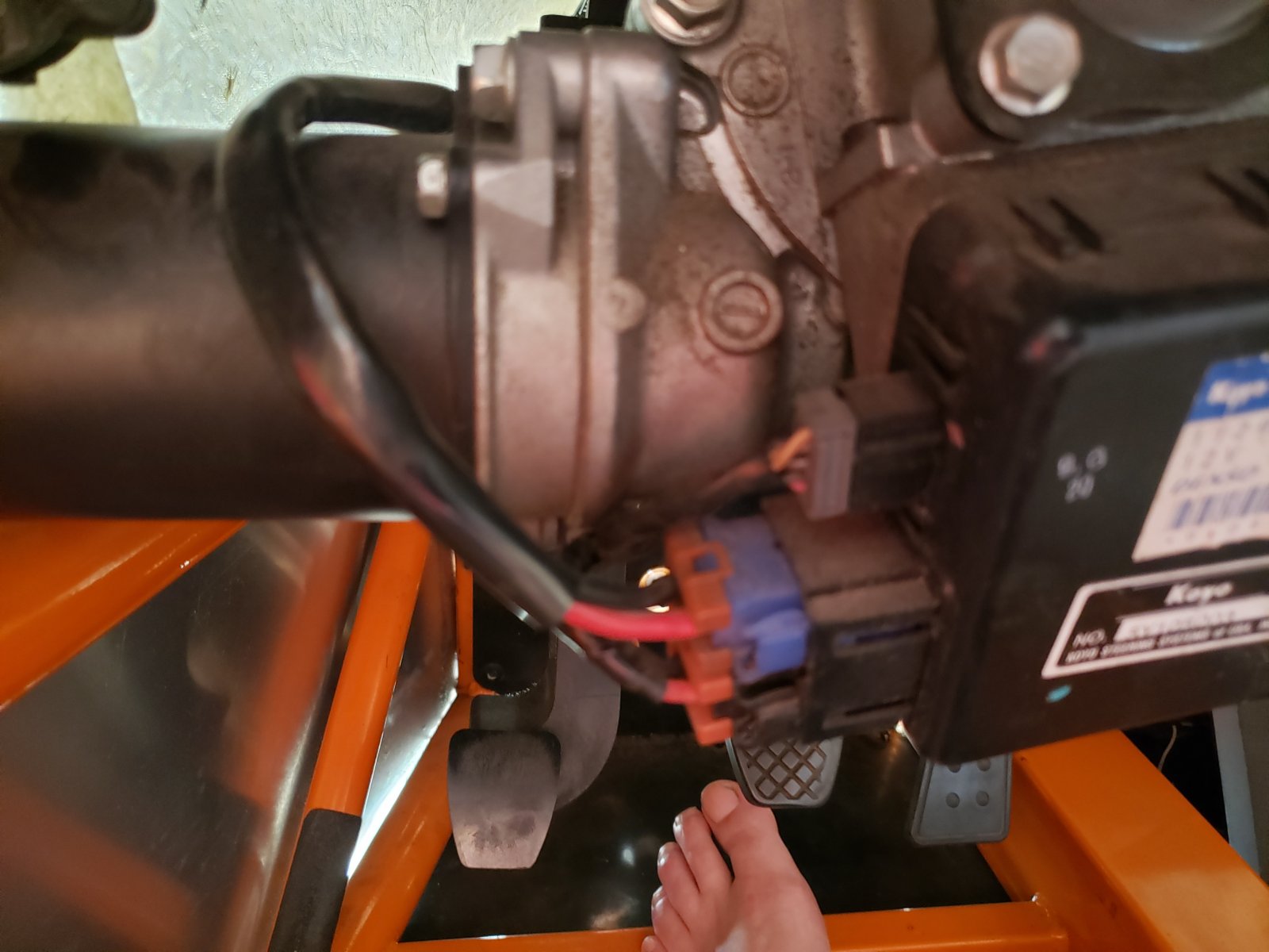

Bare with me on the stupid question. Do I disconnect the middle power steering connector with black & red wires or the small top one or the bottom one?
This small top one?

Yes. Your power steering looks a little different than mine. Probably a newer donor car.
Just unplug all of them. It won't hurt anything and will be sure to accomplish what they are thinking it will do. For myself, I'm not sure what they are thinking it will do that disconnecting the battery won't do.

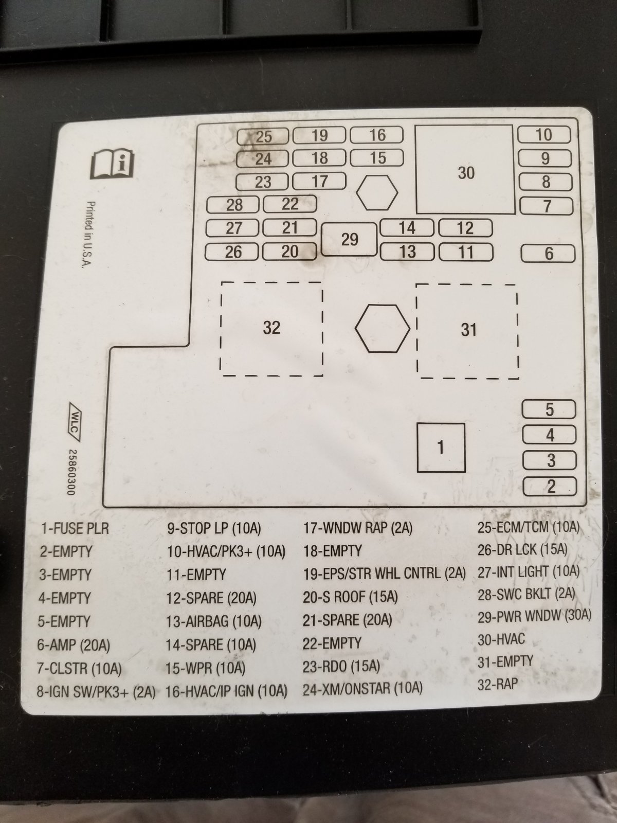

The 'logic' fuse I think is in the BCM - under the passenger kick plate - and the high power fuse is in the main fuse box in the engine bay. I'm looking for the BCM photo now but can't find it - I will send if I find it.
Ok. I already scratched up my back engine cover. Is there a trick to getting to the rear fuse box without taking off the engine cover?
I think Lonny’s car started as a SC car that was temporarily made a TC, then swapped back to SC? If so the wiring and the fusing will be a little different, although I don’t know how much that affects the EPS circuits.
