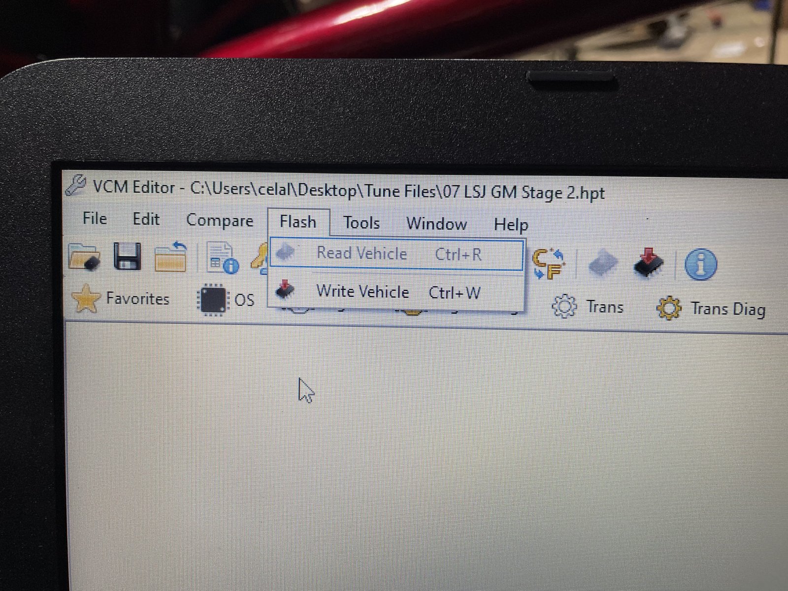

I tried to pull my base file out of my ECM tonight and the ‘Read’ option was greyed out. Any ideas?
I did register my MPVI2+ on the HP Tuners site and re-sync’d the unit. If I open the Scanner program it will recognize my vehicle with year, model and VIN. Also, the previous owner says it has the GM Stage 2 tune.
Thanks! I had a tune file already opened and needed to close it. I had heard the ECM’s from could be tune locked and was worried that might be my situation.
