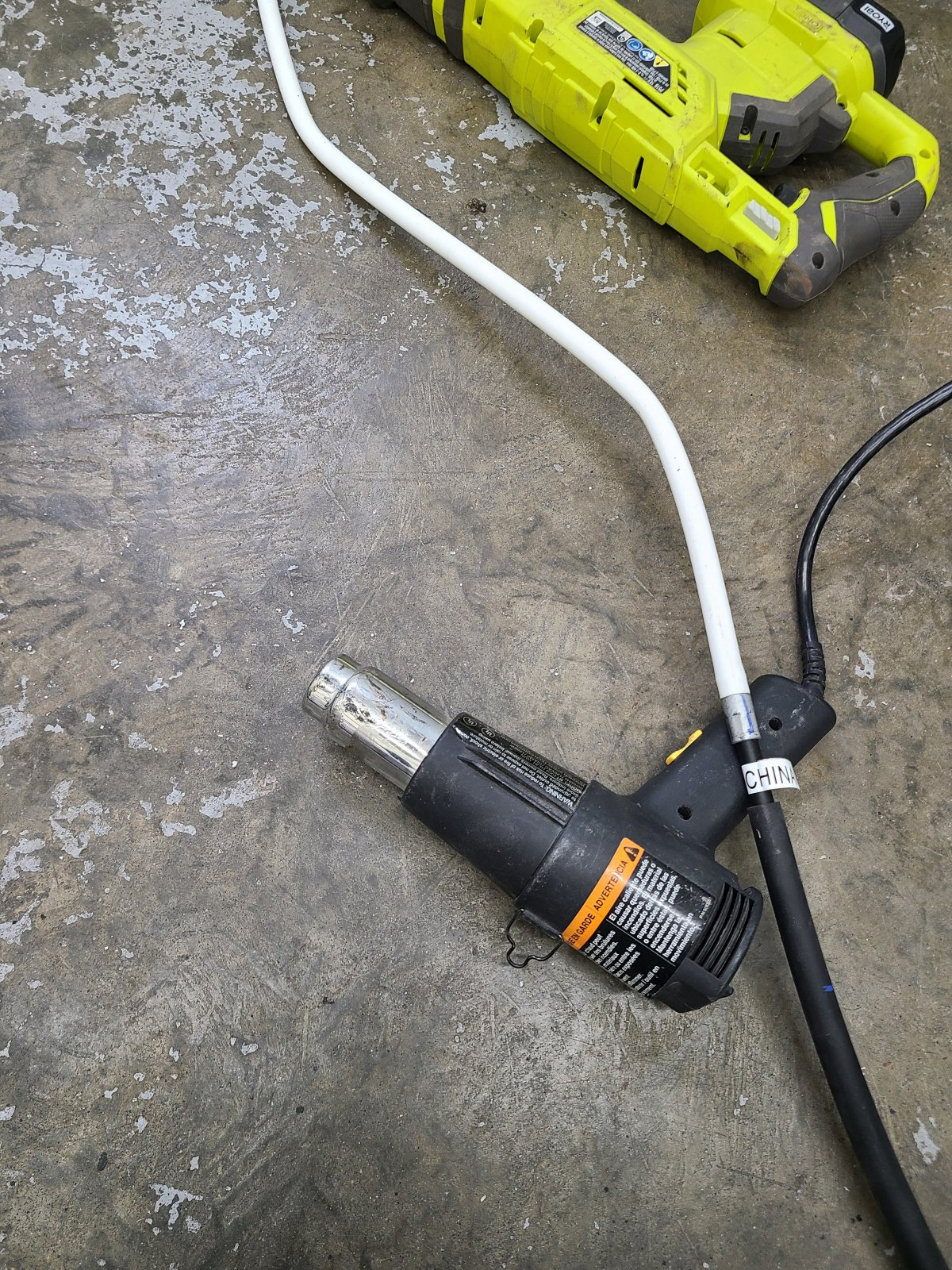

As I see in past posts, you did coat the calipers and did make your own cable guide tubes. Can you push and pull the cable through the guide tubes once they are installed on the car? Perhaps the PEX tubing creates too much drag to release even though you have slack at the handle.
