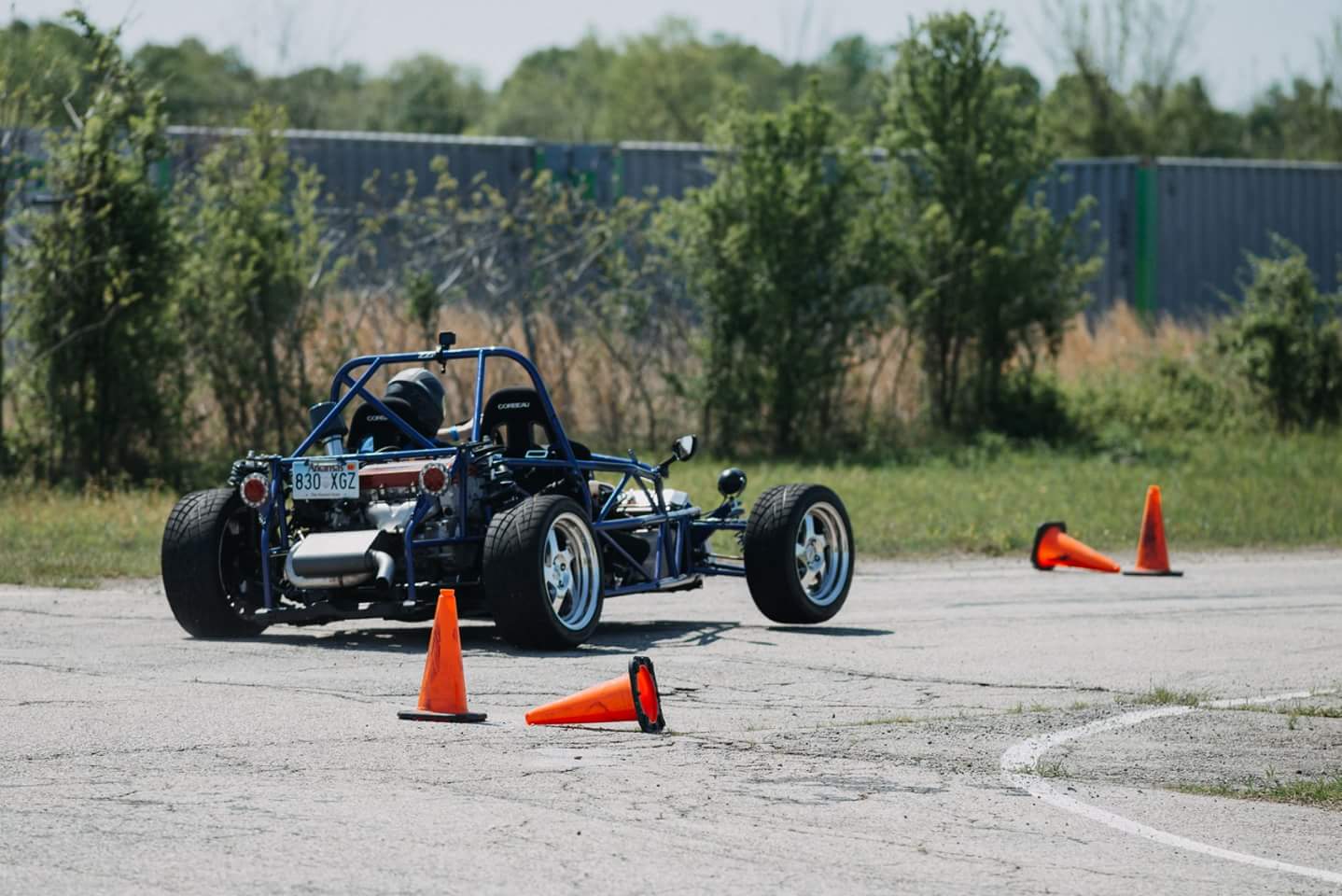

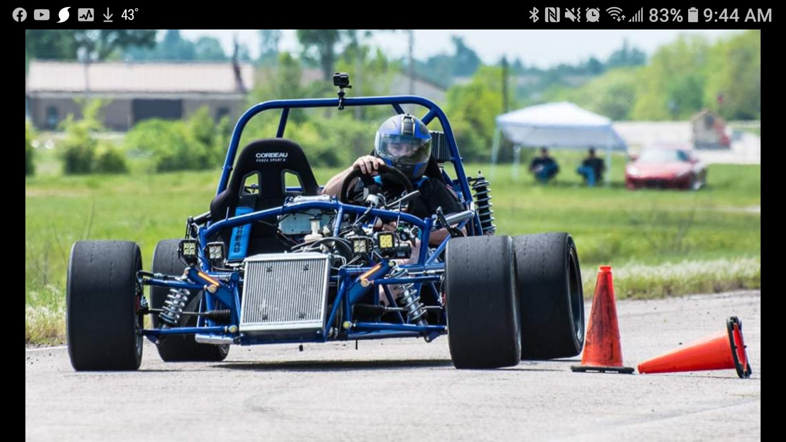

How are you doing raw times locally ? What ride heights are you running ? First auto-x I did I had the ride height set too low and the guys said I was getting positive camber in the rear. My goblin is really twitchy in the rear and is difficult to keep from sliding.
I may need to slot my rears and try more camber, wish it was not winter already.
JERMzSS
Locally I'm the fastest but I'm running against full bodied cars. 61.25 was my fastest time this year. I'd say 69 to 71 was a good average time with a low 66 was the fastest by a modified Miata. They made a special class for me lol
You have rear coilovers? I had that issue when I had factory struts in the rear. I'm in Houston now and will be back home next week. I'll get you some specs then. I love these pics cause they show my set up is now working lol.
Before rear coilovers and after.
