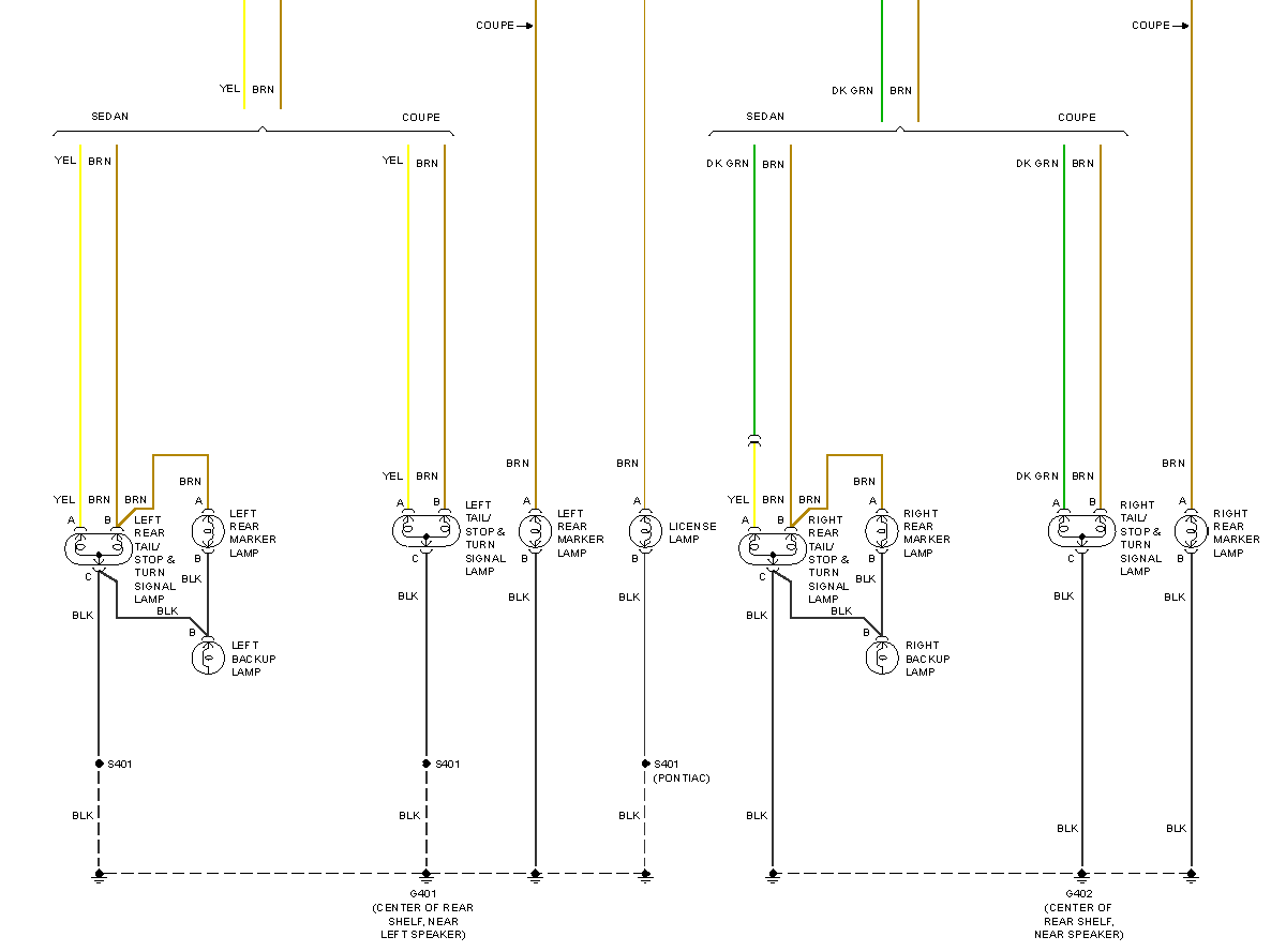

Brown is all of the marker lamps (side markers, tail light, etc). They are all the same and all wired to the BRN wires. They turn on with the headlights.
The Brake lights are the same as the Turn Signal but differ depending on the left or right side. Left Turn (and Brake) is YELLOW. Right Turn (and Brake) is GREEN. All use black for ground.

Ok with the yellow and green turn signal wires function properly with the blinker but then are a constant 12v when I turn the blinker off. I have the Brown as the “running lights” and they turn off/on with headlights correctly.. the problem is if the blinker/ brake wires are a constant 12v I have no brake lights cause they are on constantly..

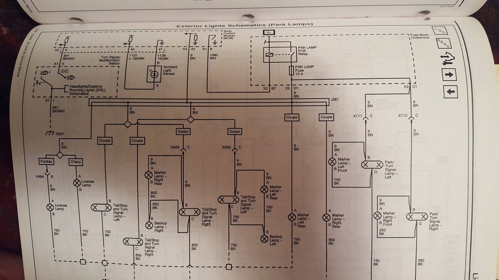

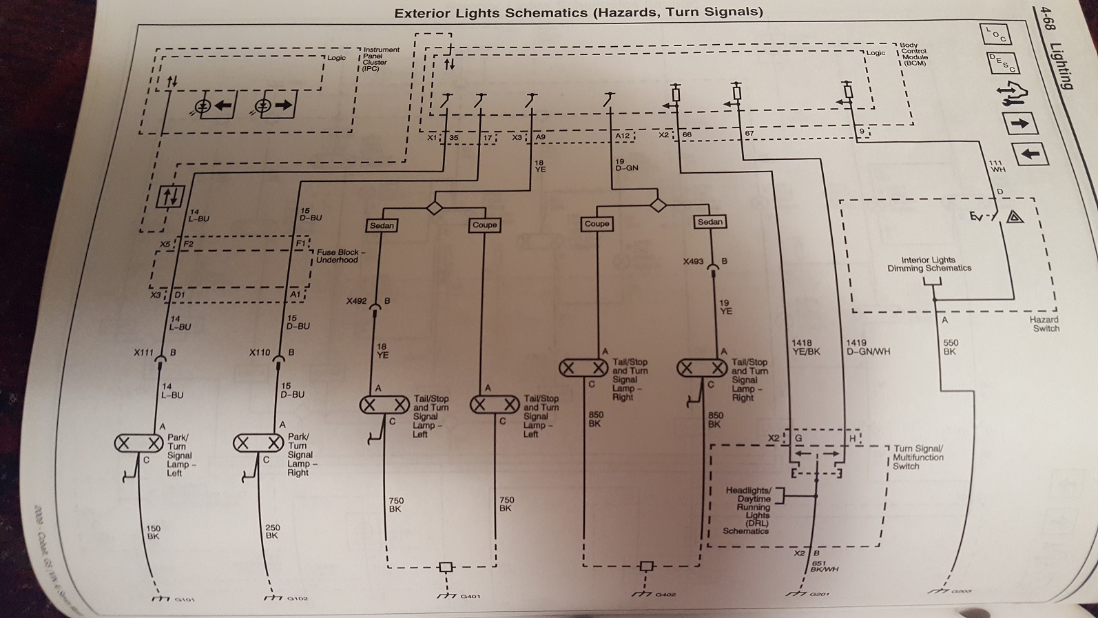

Hope you didn't wrap it up already. Sounds like you'll need to trace the circuits back to the sources. The diagrams are from my '09 service manual so they're the same as what you have.

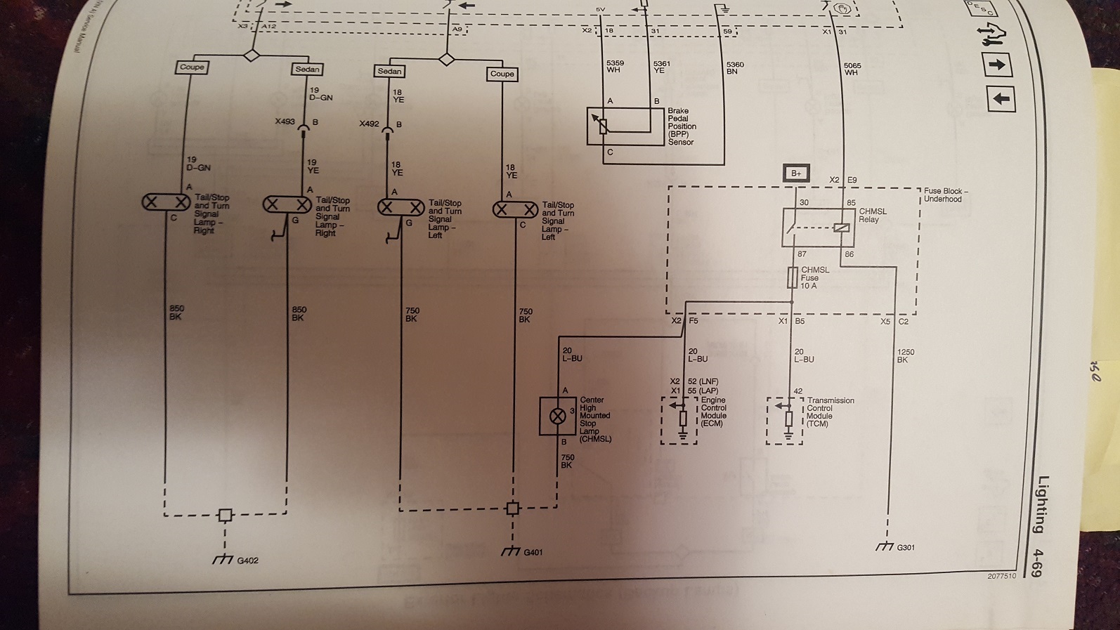

Does the light blue wire from the 3rd brake light actually get used? I don't see a purpose for it with the yellow and green wires.

Does not have to but in some situations, I remember some having issues with the cruise control not working if the CHMSL (3rd Brake light) is not connected to a bulb. Our cruise control works fine without it.

Just spoke to Lonny about this yesterday. Early models didn’t require it. Later models require the CHMSL to be grounded through a resistor. This is why some goblins require it and some don’t.

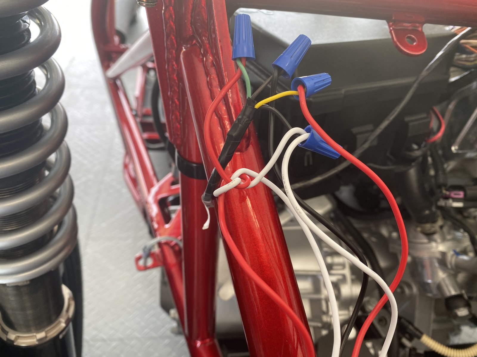

I don’t know if this helps, This is on a 2009 Turbo
dastrups
I think I had everything the same except for the dark green was with red and the brown with black for the passenger side. I could try changing that and see. I don't have blinkers or headlights wired up yet and I don't know if that makes a difference. I also don't have the third brake light.

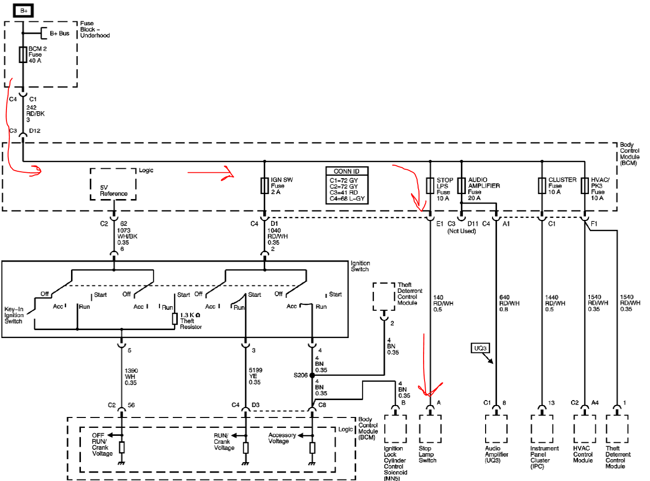

Trying not to start a new thread...
But I am not getting any power to the turn signals or brake lights.
I have checked the brake switch (5V in, ground, and 0-5v Out depending on position) and the wiring from the BCM to the tail lights.
The BCM is not sending 12v out on Circuit 18 or 19 for either the brake lights or the turn signals.
I'm 99% sure all my ground are in.
When I put a volt meter on the circuits, I get about 200mv with the blinker off and some small changes when I turn the blinker on.
The cluster does show the blinker on, but I do not hear any relays clicking (not sure if there should be one)
Any ideas?
Corgithulhu
Is the 5V you measure at the brake switch on the red and white wire? That's fed by a 10A fuse in position 9 on the BCM. It should always have 12V on the red and white wire, as long as the battery is connected. That fuse gets power from the big 40A BCM fuse, which is directly off the battery.
If you get 5V on the red/white wire for the brake switch, your issues might be further up the wiring (or a low battery) since it should be basically direct battery voltage.
