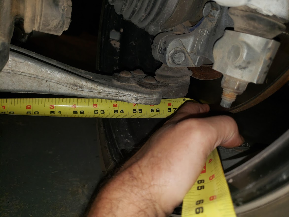

Can someone with a finished Goblin do me a favor and measure the width from the left side ball joint to the right side ball joint, please. Need the center (roughly) to center of the ball joint, measured under the back end where there is no obstructions to bend around. THANKS!
I get 57.5" from the outside of both ball joints, since the ball joint is 1.5" in diameter, the center to center distance is 56".
My tape measure was almost straight... couldn't get the measurement without the subframe getting in the way.
