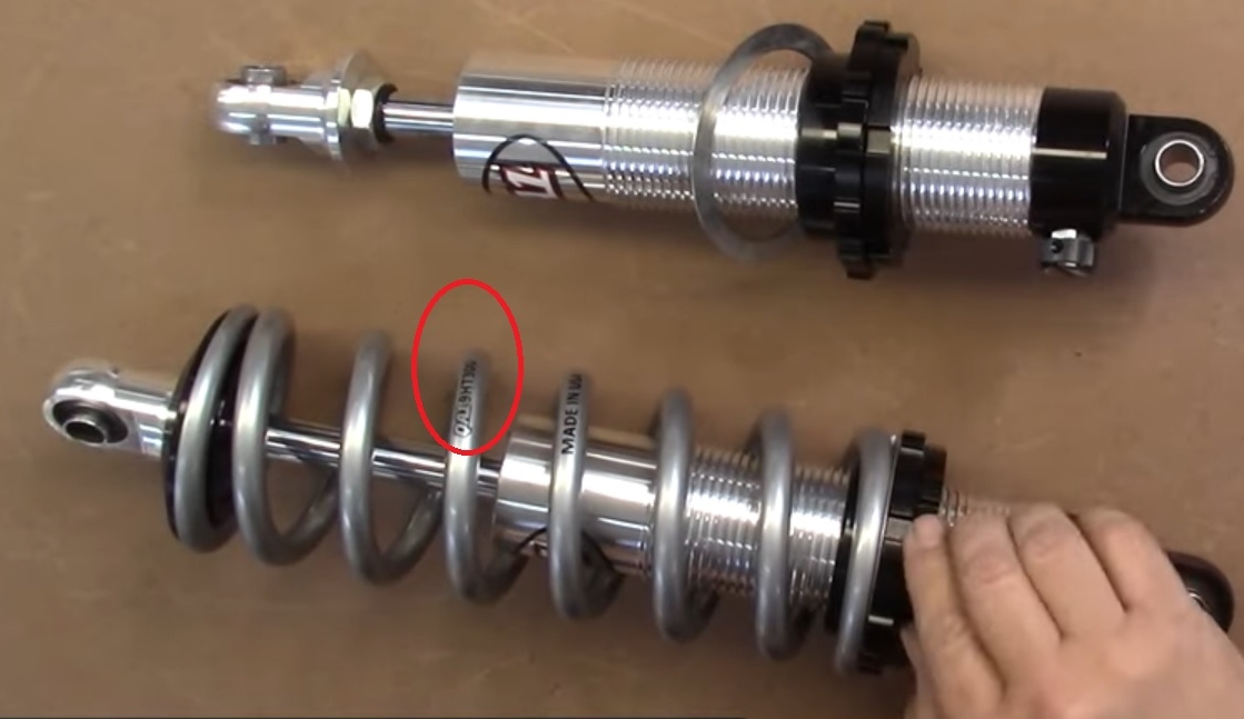

There is a ton of conflicting information on the spring setup. I have the #300 springs up front (as shown in the video) and the #400 in the back. Seems to make sense since the majority of the weight is in the back. Yes, I need to adjust shock height.

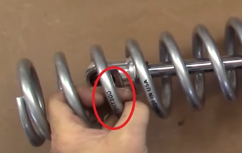

Right out of the video (#23). It says 300 right on the spring.
