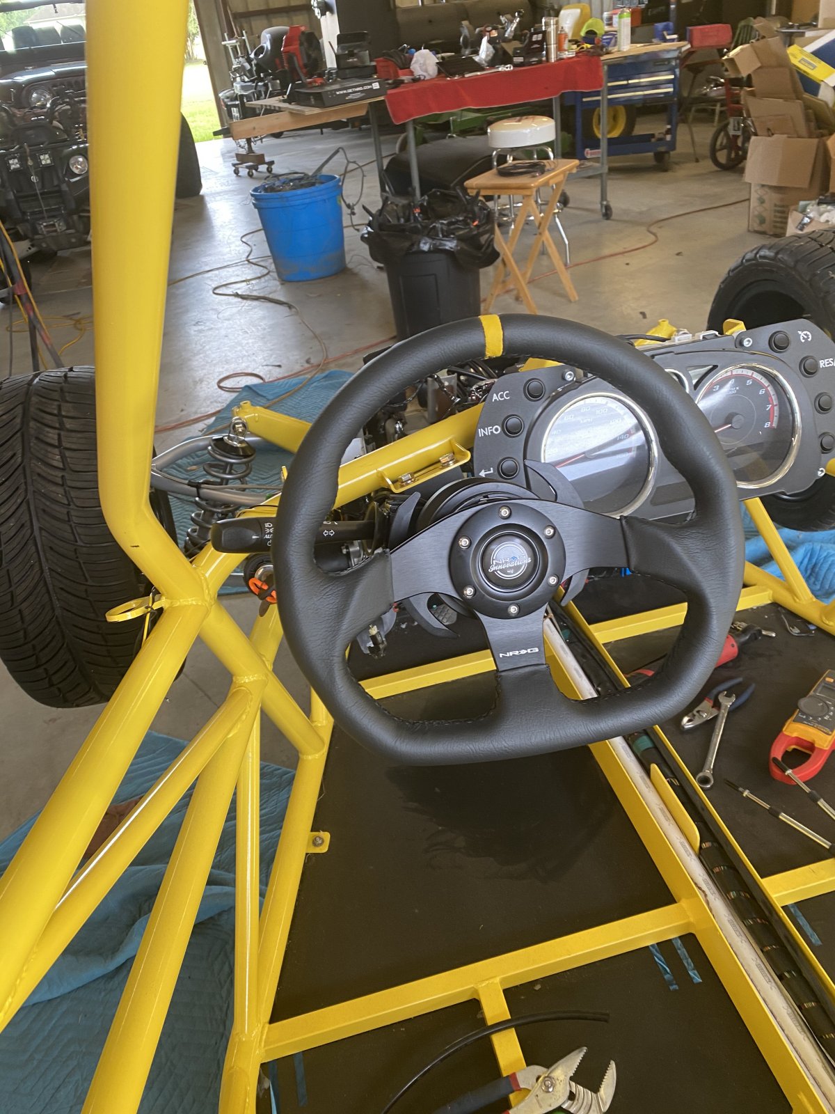

I'm a big fan of mine. Must-have upgrade.

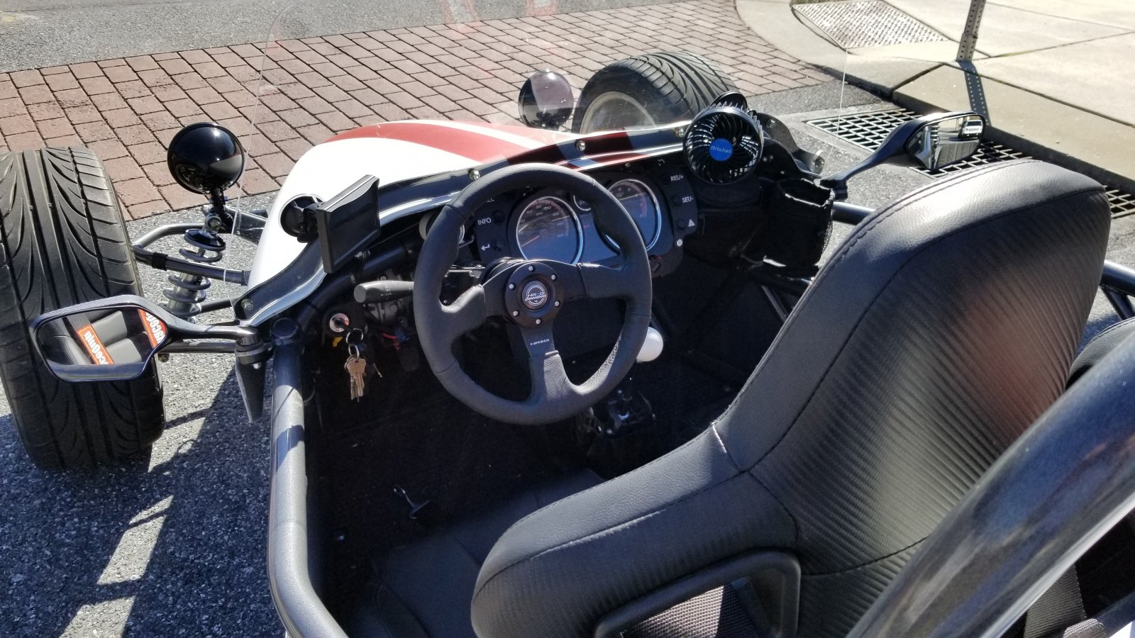

It's about an inch, maybe an inch and a half, closer to the driver. That was my primary concern and why I went with a "flat" wheel rather than an deep dish type. It's comfortable for me, but then I am 5' 10" and about 190lbs, so YMMV.

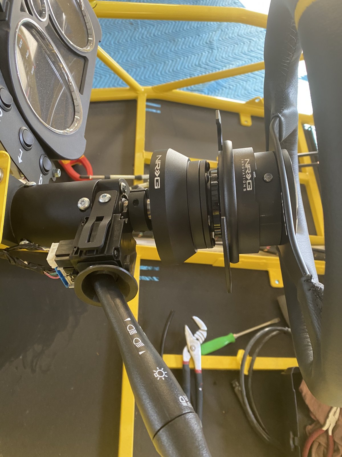

I know NRG offers a more slim wheel hub you could use.
The combinations of the hub and steering wheel will determine how close it is to the driver. The DF steering wheel is a dish-type while the one we use is a flat steering wheel. Going to the flat allowed us to use a removeable hub without pushing the steering wheel into our chest.

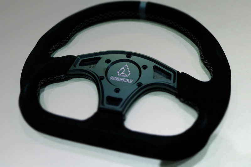

This is the steering wheel we used. It's primarily designed for UTVs but can be used on this car.

mine is all NRG stuff.
