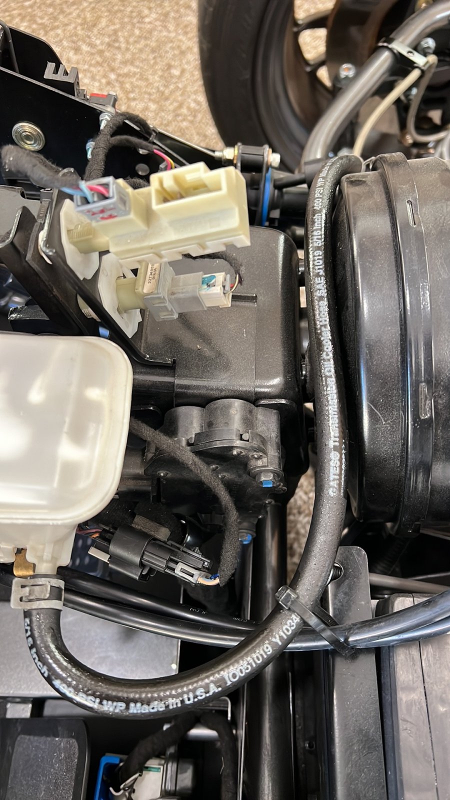

RITDR Active Member RITDR Active Member Dec 1, 2021 #1 What type of hose/line are you guys using to run from the brake reservoir to the clutch pedal? The one on my car is seeping fluid through the hose. Attachments A06C6602-8517-48EA-9E3E-1A1C474C7660.jpeg 264.9 KB · Views: 392

DCMoney Goblin Guru DCMoney Goblin Guru Dec 1, 2021 #2 Tygon 2375, 2+ years, no weeping, swelling, etc. McMaster-Carr McMaster-Carr is the complete source for your plant with over 595,000 products. 98% of products ordered ship from stock and deliver same or next day. www.mcmaster.com

RITDR Active Member RITDR Active Member Dec 1, 2021 #4 DCMoney said: Tygon 2375, 2+ years, no weeping, swelling, etc. McMaster-Carr McMaster-Carr is the complete source for your plant with over 595,000 products. 98% of products ordered ship from stock and deliver same or next day. www.mcmaster.com Click to expand... It looks like that is only pressure rated to 25psi. I assume that’s ok for this line?

G Gtstorey Goblin Guru G Gtstorey Goblin Guru Dec 1, 2021 #5 Yes, reservoir line doesn't really see pressure. Here is another option also. About the same price by the time you pay shipping through McMaster-Carr. Tilton Engineering 74-214 Brake and Clutch Fluid Hose 24" Long | eBay
