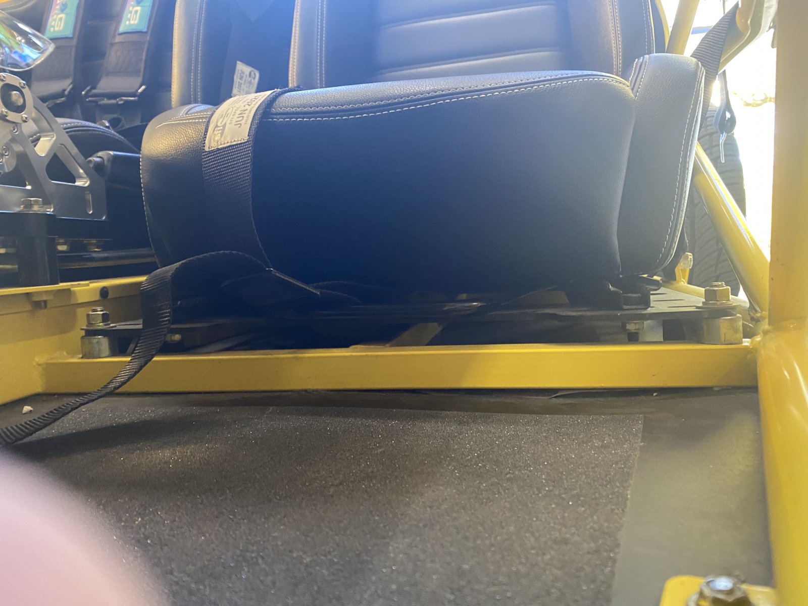

We used the sliders out of the donor and custom made and adapter plate to work with the seat. That doesn't help you much, but trying to give a response.

I have the Planted Tech brackets. They fit fairly well aside from the notch on the front. It needs a spacer as the notch is larger than the square tubing on the chassis.
My only complaint with them is once you add the sliders, the seats sit higher than I’d like.

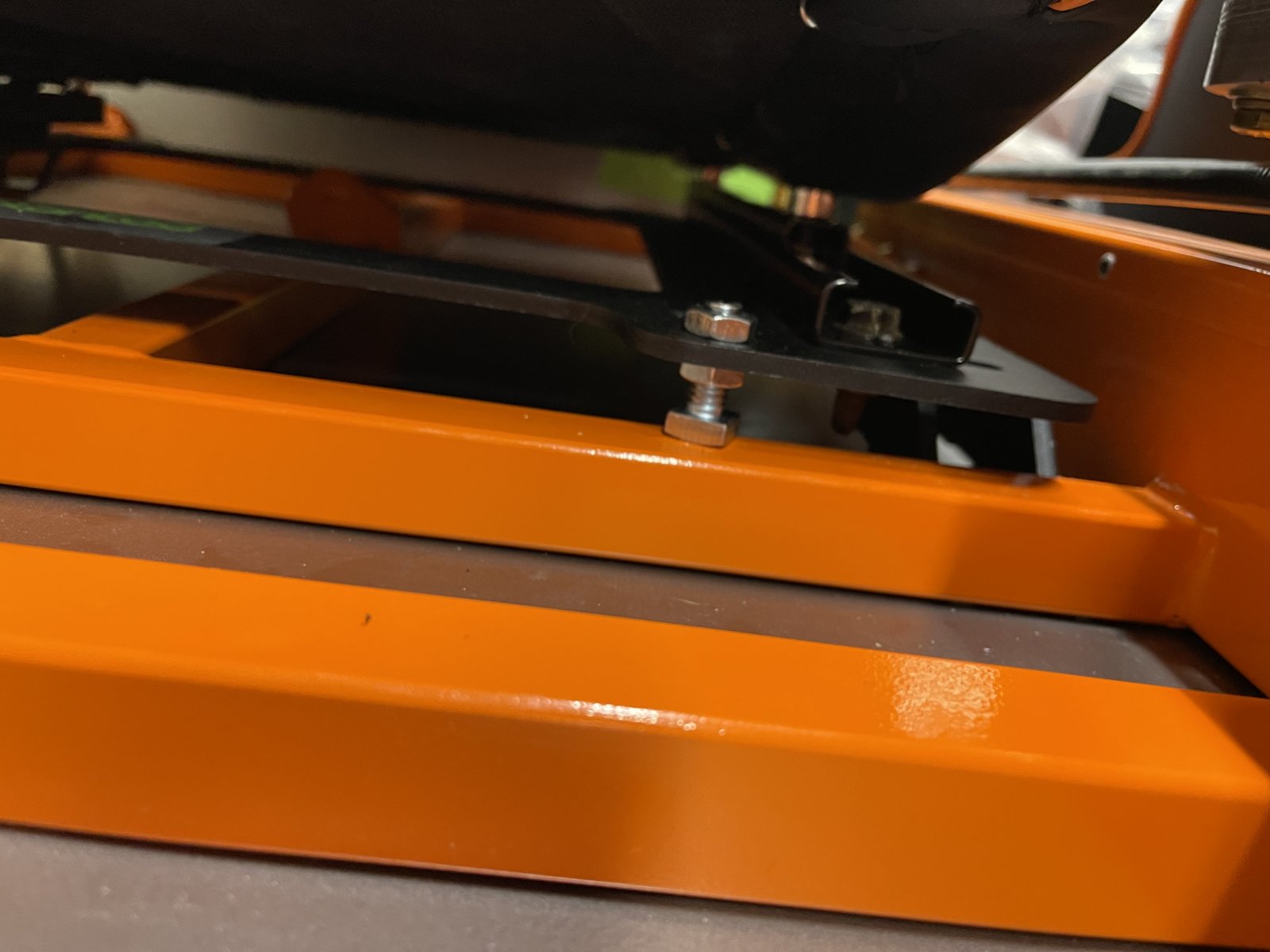

I added 2 bolts (going to add 2 more) threaded from the bottom up. It takes up the gap on the planted tech brackets. It made it adjustable.
