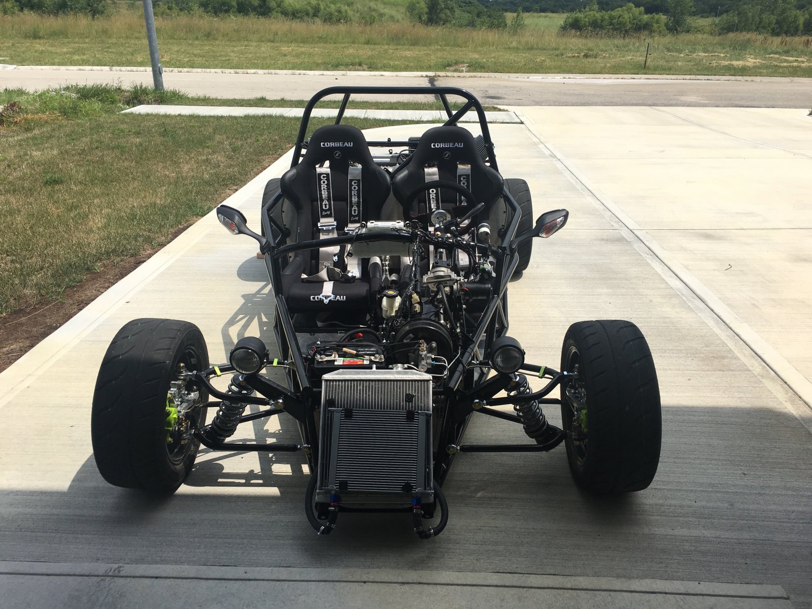

My frame should be shipping in the next few weeks and I need to make a decision on seats and get them coming.

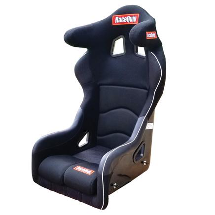

My current front runner is the RaceQuip Full Containment seat. (Large)
My question is will they fit in the Goblin

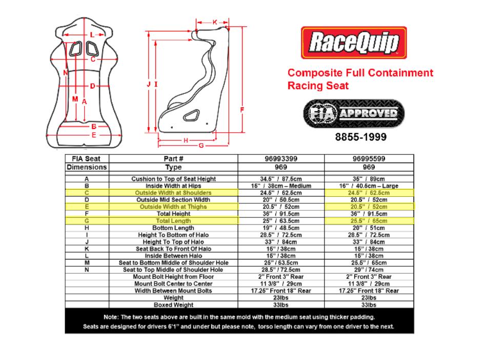

Using the the Corbeau FX1 seat as a baseline (because we know it works) The RaceQuip seat would be 1.5" wider at the shoulder balusters and 1.5" Narrower at the thighs. The RaceQuip is also about 7.5" longer in the overall length.
Probably the simplest way to answer this if someone with the FX1 seats (not the pro) could tell me how much space is between the two seats at the shoulder balusters.
Or, if someone is using different seats and can share their information I can compare it to my pick to see if it might work.
