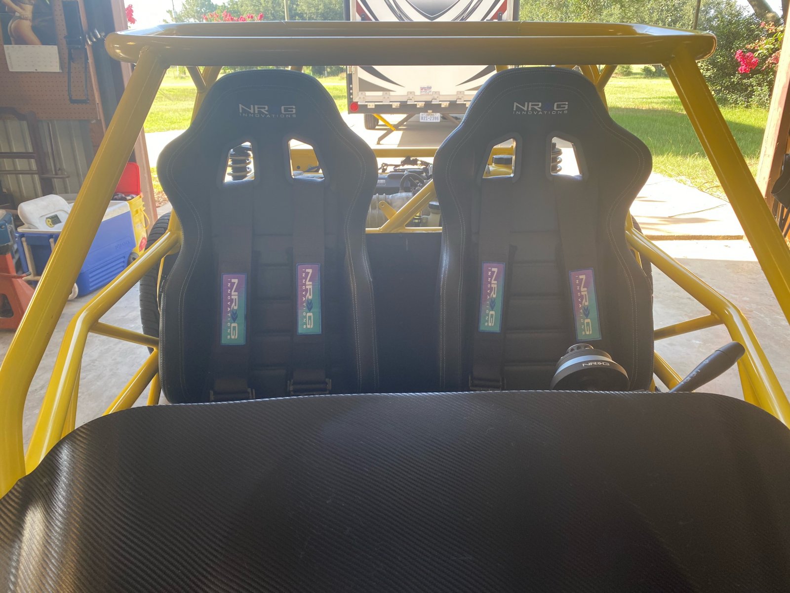

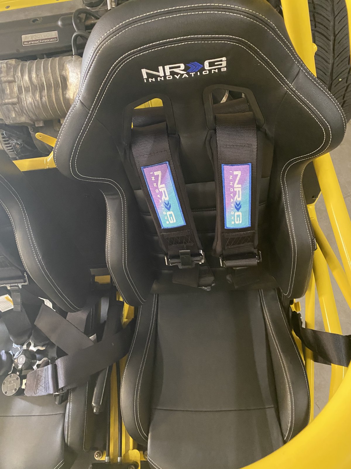

I love my NRG seats that recline and slide. Bought the cobalt mounting brackets and it was an almost perfect match.

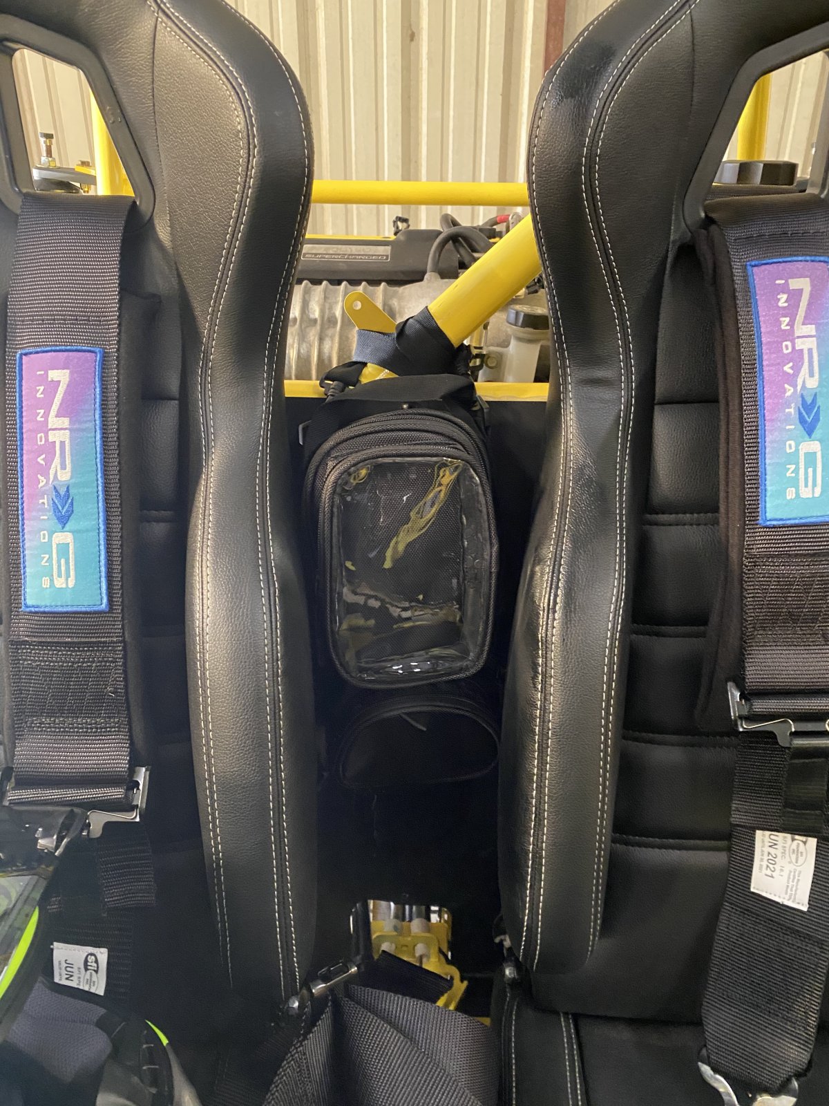

Sure. There a gap in between the seats to add storage like a motorcycle tank bag. Both seats recline and slide. Pretty comfy for being race seats.
NRG innovations RSC-208L/R

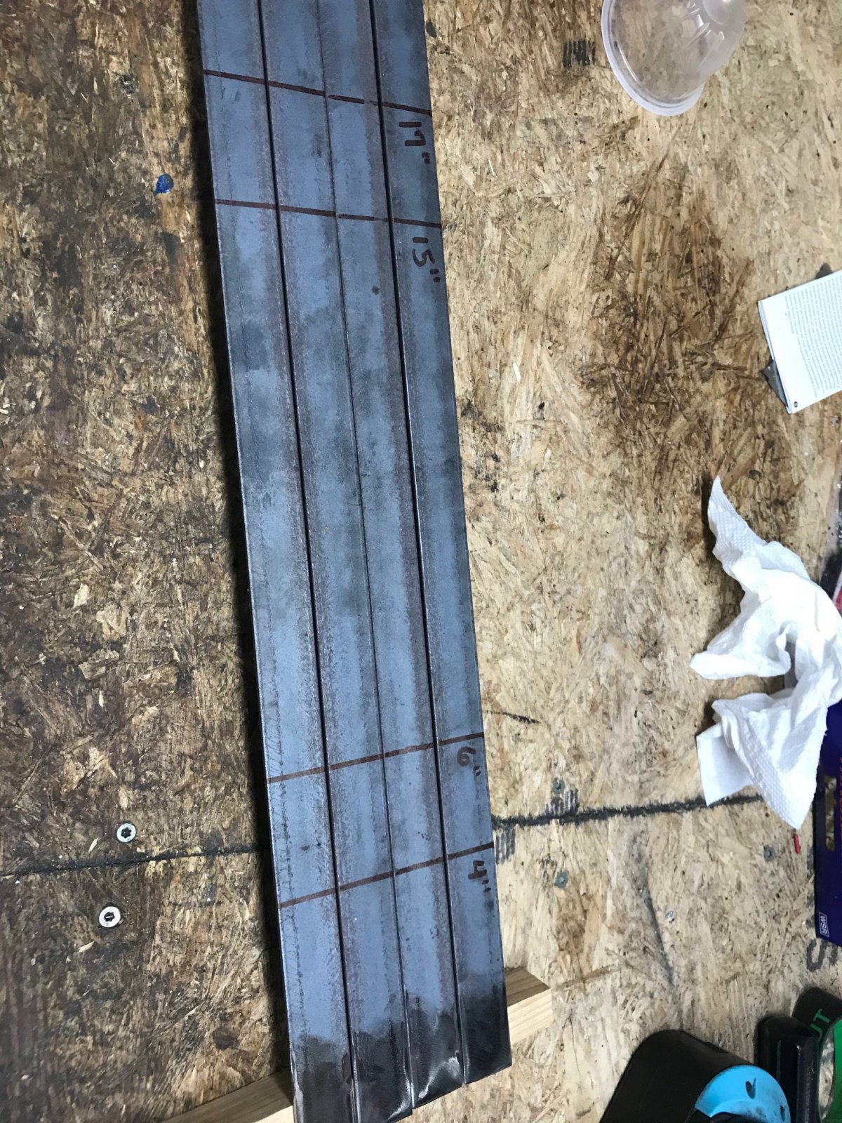

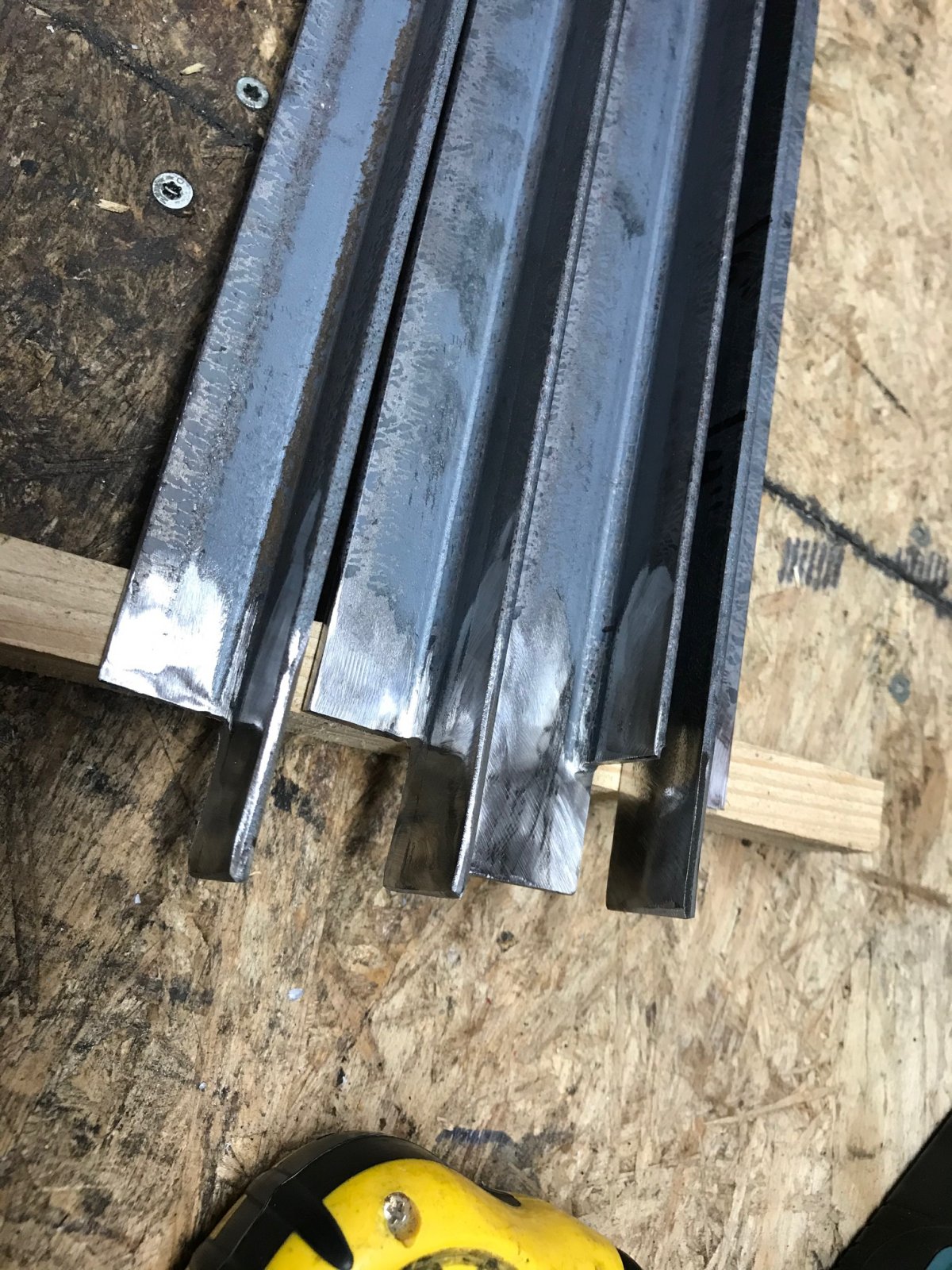

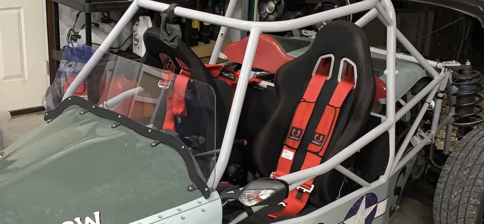

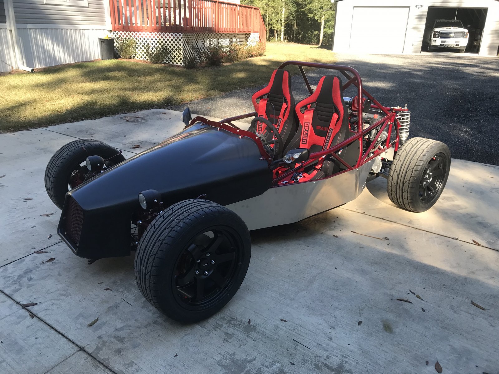

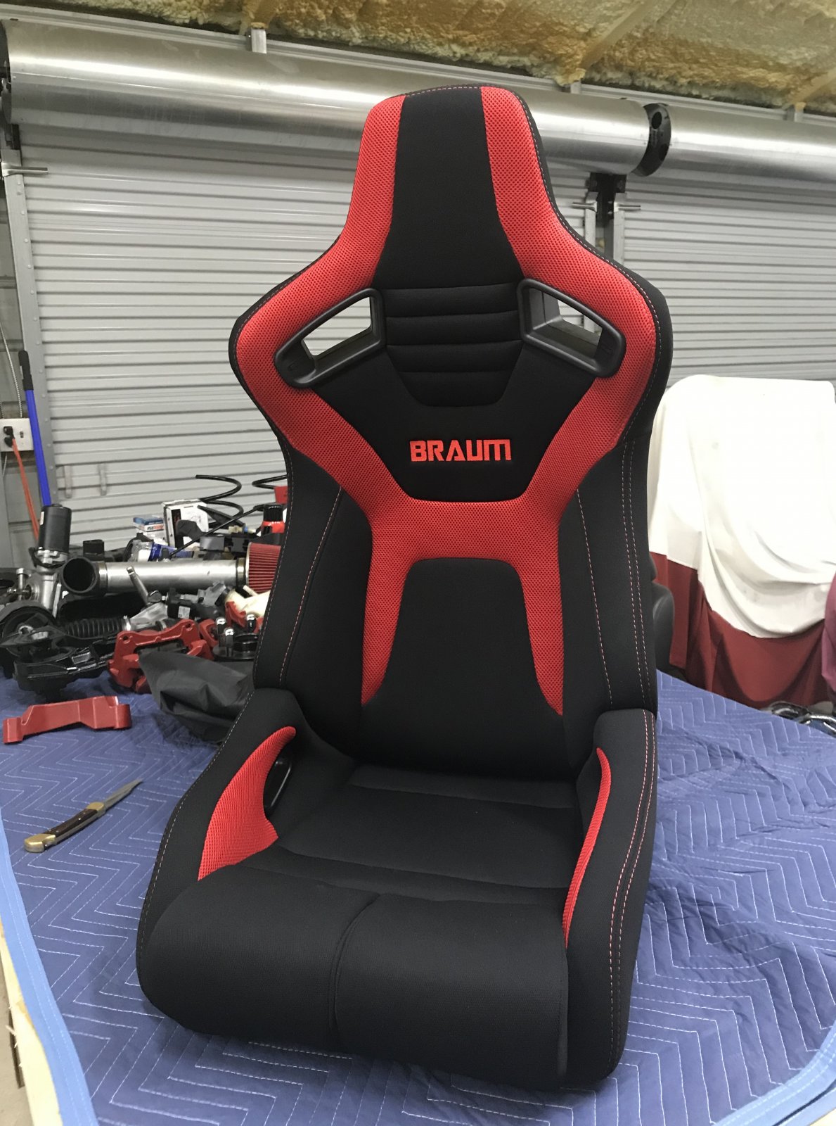

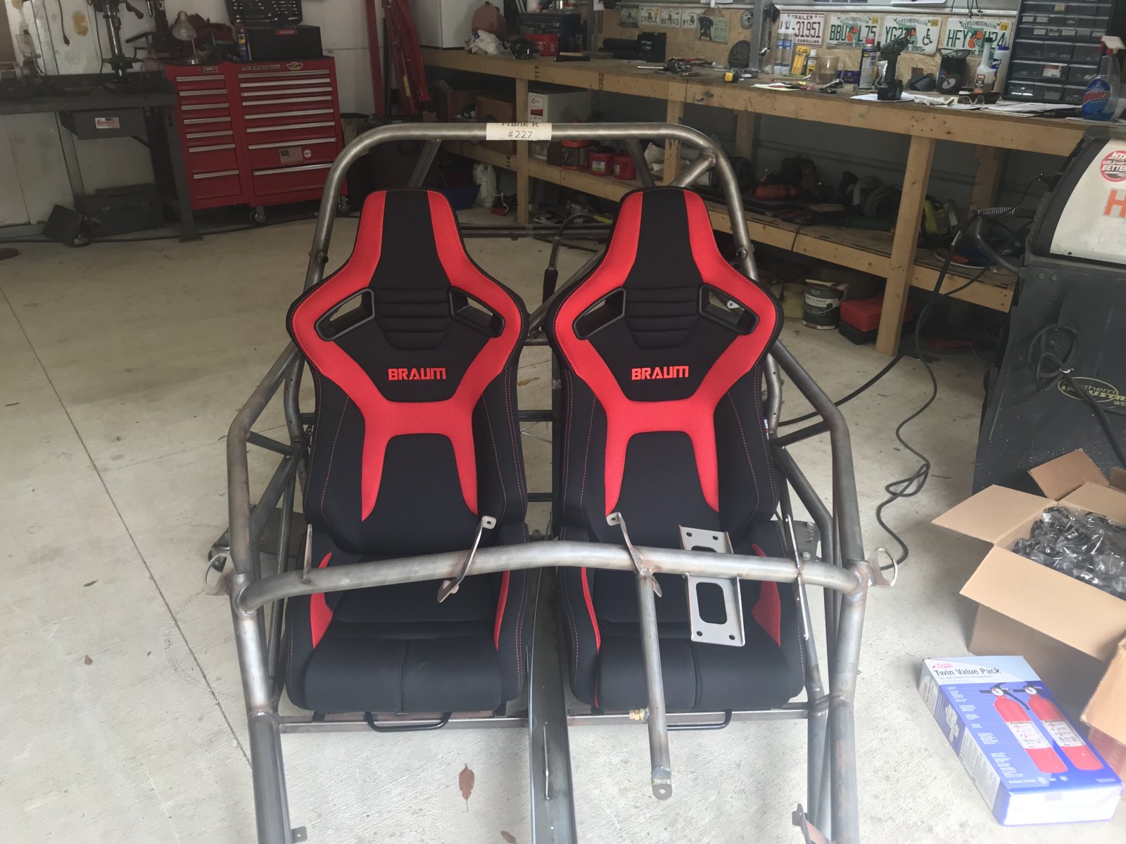

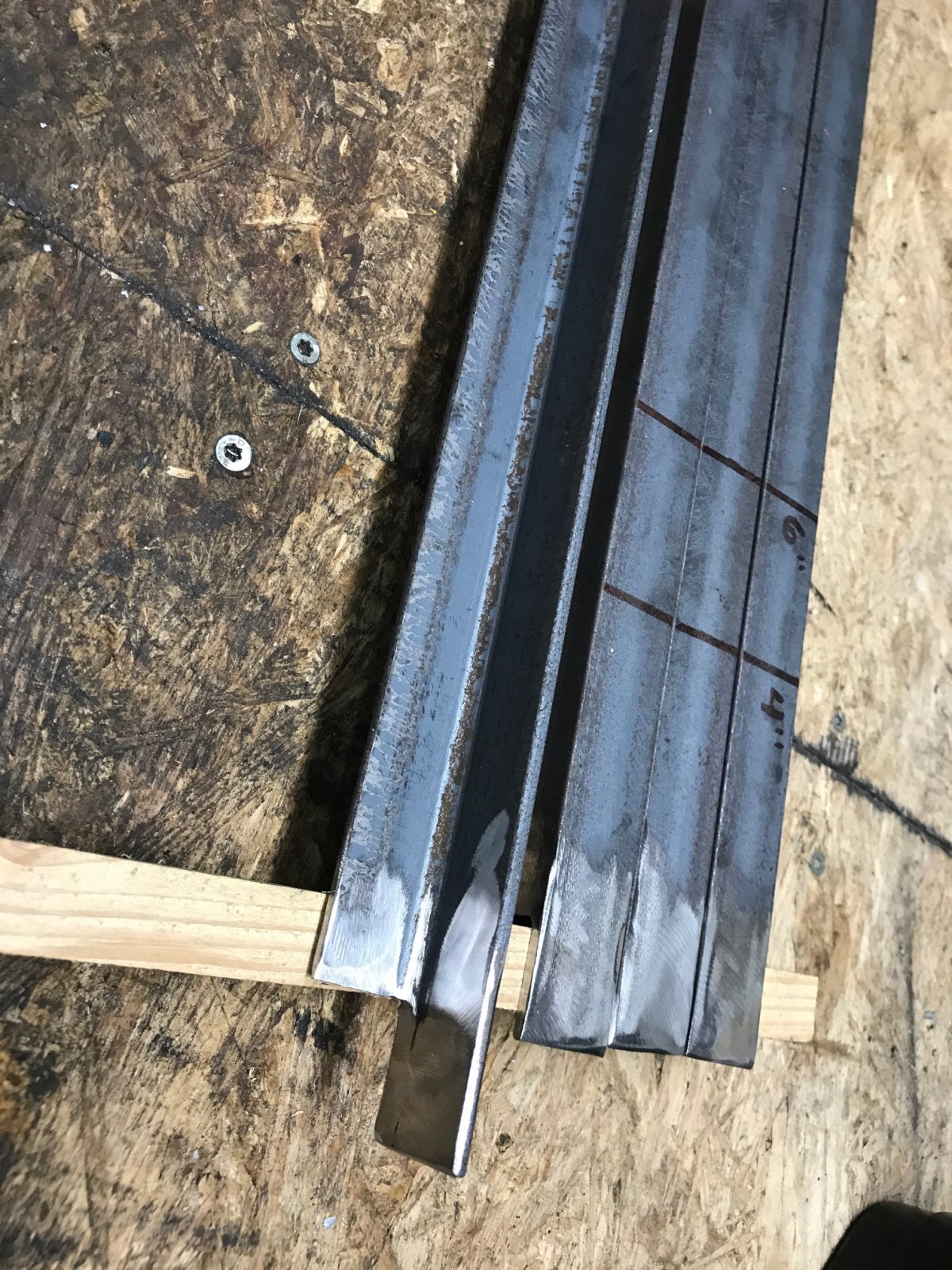

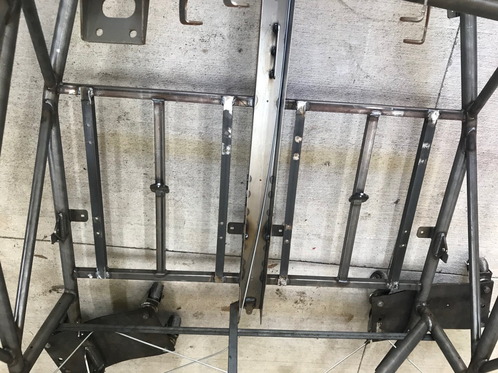

I went with Braum Elite-R seats. Fit well, have sliders and also recline. I welded in my own seat rail brackets. After the first install I felt the seats were a bit low so raised them another 1-1/4 inch with some "U" channel Aluminum. Very happy with how they turned out.

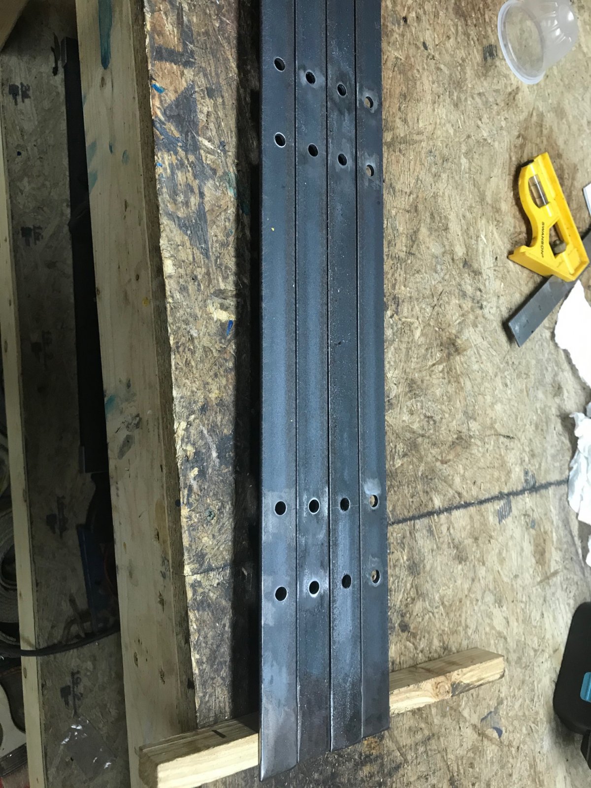

Not enough holes in those seat brackets you made. :p;)
Since I had sliders I really only needed 4 mounting holes per seat. The first set of holes was for the original mounting of the seats. I could not get the seat to slide fully to the rear so I drilled another 2nd set of holes and re-mounted them. Much better !

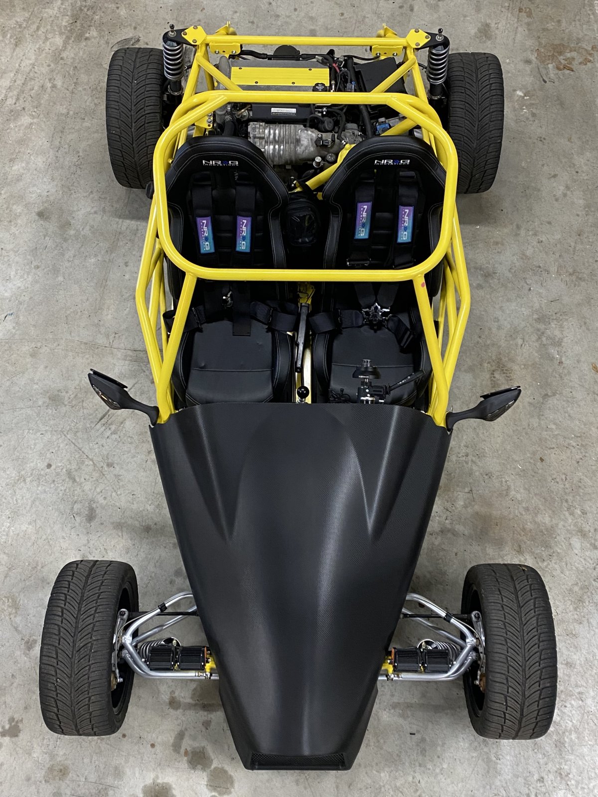

If the outside dimension is wider than about 21 inches the seats become a tight fit in the cockpit space. Seat mount adjustments will be needed to move a seat laterally to squeeze it in.
Would that 21” dimension at the bottom “D” point be the one or will the upper “E” dimension at 22.5” be an issue.
