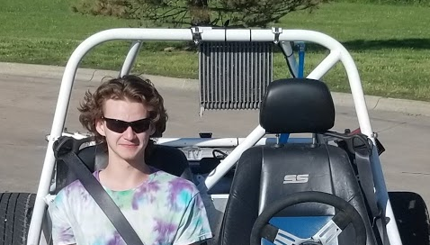

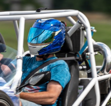

Hung it up high, no fan needed. Tried it behind the drivers head & near the middle, no heat issues.
