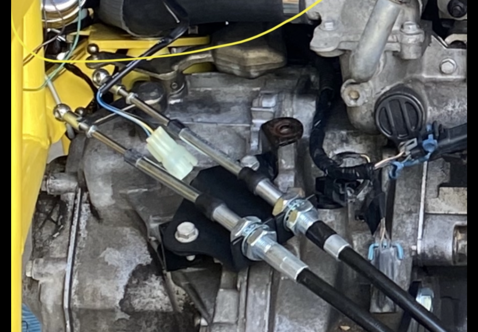

For those of you that used a SS/SC donor, did you get a mount in your kit to attach the shifter cable to the transmission or did you use the one off your donor?
I'm swapping from a base model donor to an SC but the donor's mount is too close to the shift levers on the transmission. I'm not sure if the shifter cables are different between the kits or if the SS kits come with a different mount.
Uses stock mount with an added piece from Df
jennam
@Rttoys one more question. Which shifter cable connects to which side of the actual shifter? I see the right hand cable in your previous post has black tape on it.
Ya. I marked one cable so I would get them backwards.
I’m trying to find a pic, but I believe….edit. See next post
Right cable (up/down) on shifter is the marked cable on the right or upper of my pic.
left cable (left/right) on shifter is the unmarked cable on the left or lower of my pic.
