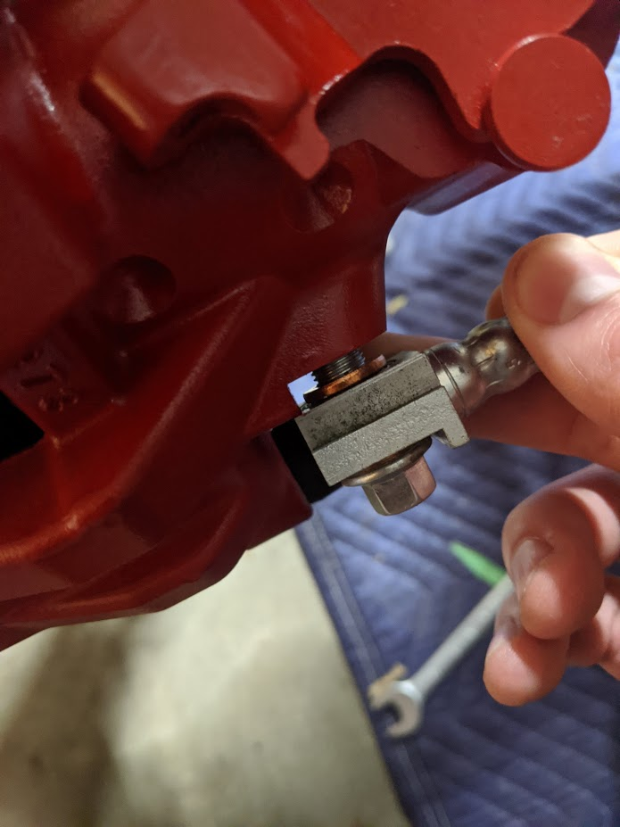

Hey all. Anyone else run into this? I'm trying to install the steel brake lines from DF onto the Solstice parking brake calipers. It looks like... a millimeter-ish too big. Can I just sand this down so it fits? Do I have the wrong orientation? No orientation fits, but I'm pretty sure it should be facing straight out. It would be too short otherwise.

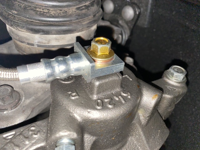

This is how they should go

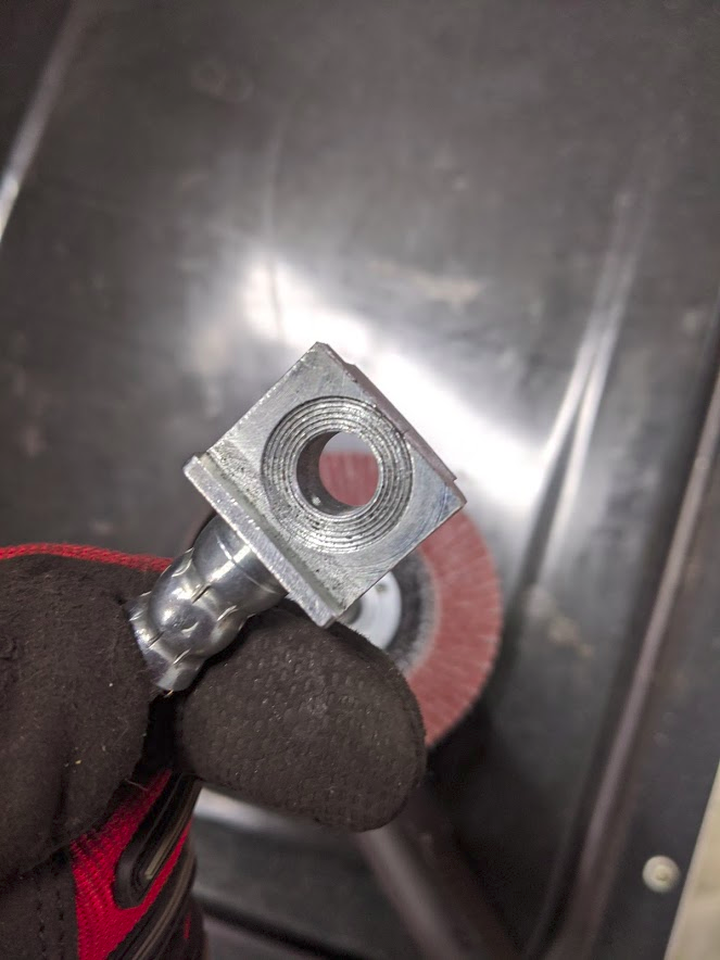

@jirwin the fitting is meant to sit on the ridge like the pic motoracer110 attached, even still I had to shave mine down with a dremel. Put a copper washer on each side of the fitting and tighten it down, crushing the washer into the ridges on the brake line fitting.
