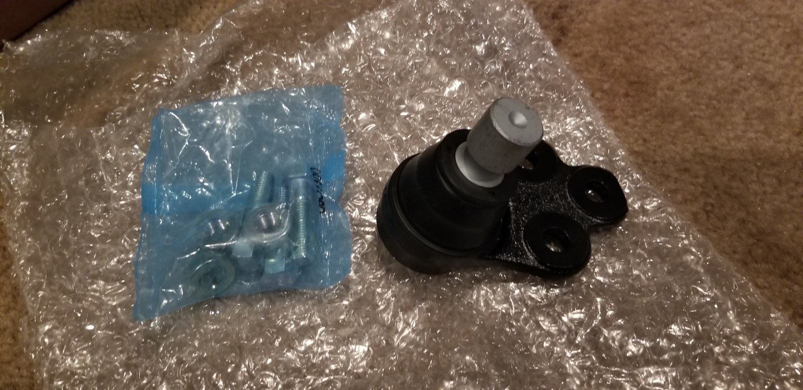

OTTP has LNF ball joints last time I checked. It's a pre-order IIRC, with a ship date in August. Probably more info on their Facebook page.

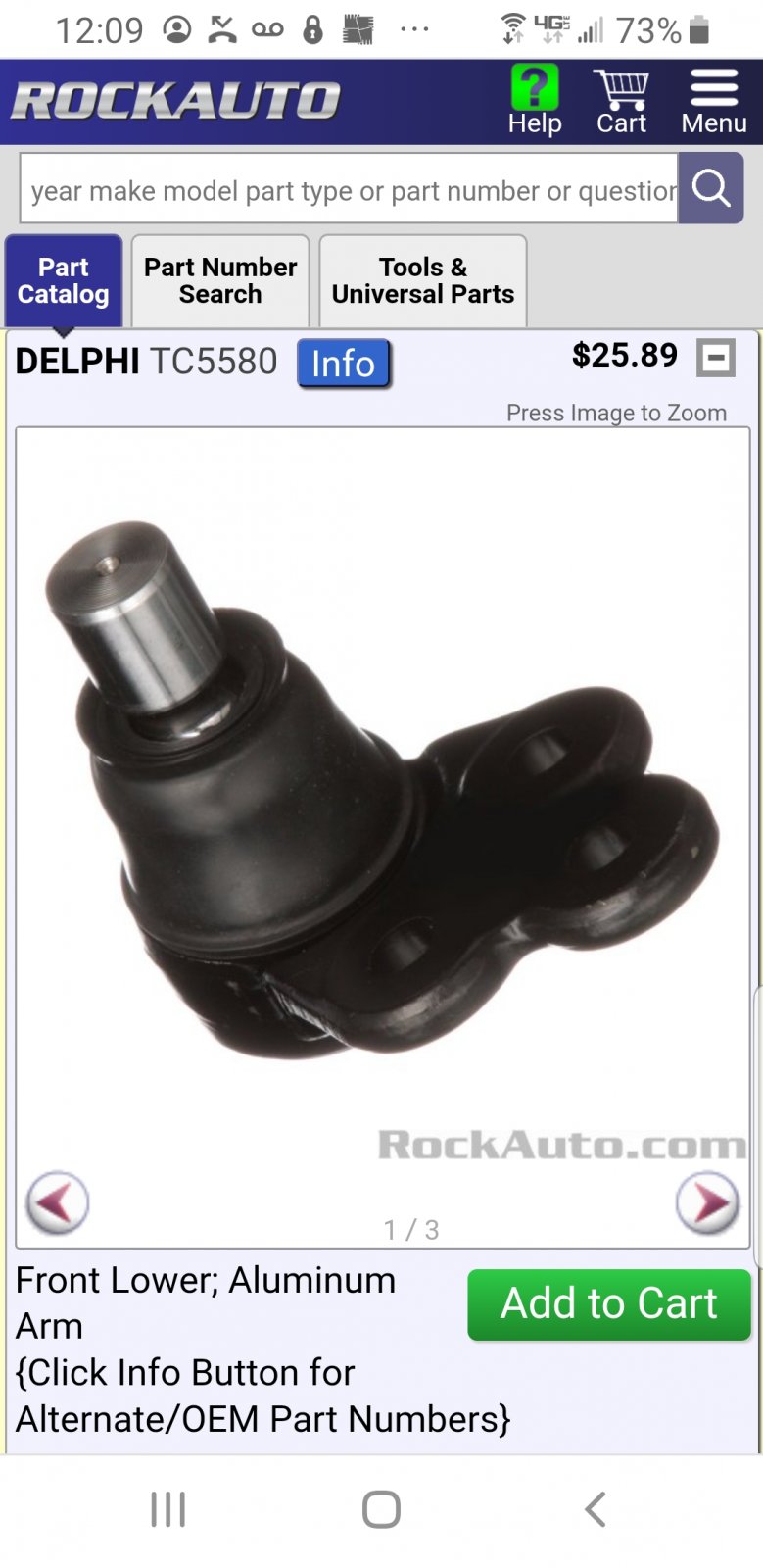

Waterdriver
Rockauto?
You can try them, but the SC cars also had aluminum lower control arms and do not match up to the LNF hub uprights. Too many of us have asked if these are TC ball joints, told yes, then get them and they are too small. Goodluck.:)
Thanks for posting the OTTP ball joints. I think that is the first time they have been posted on here. Although my control arms were replaced when I built the Goblin, I ordered a set to have since they had been impossible to find. Although shipping is getting outrageous, almost $20.00 for the cheapest.

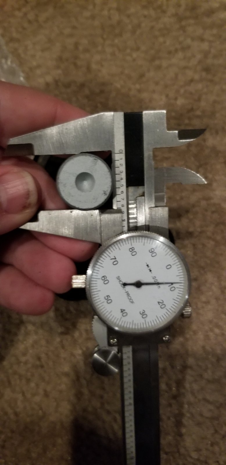

If im reading these manual calipers right, .808" which translates to 20.523mm.
Thats what we're looking for right? LSJ and others are 19.5mm and the LNF are 20.5mm. It appears that OTTP did it right!
