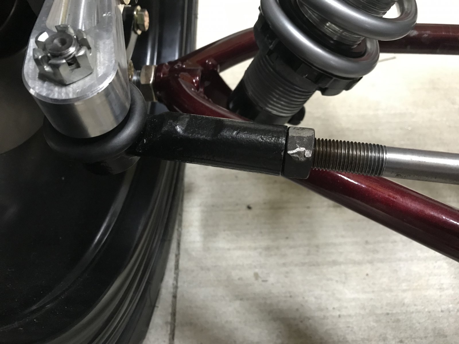

The Tie Rods I have on the front only have 8 full turns on the threads. That seems like it's just not enough. I don't know if there is a spec for this but it just doesn't seem to be enough. Anyone else have this issue?

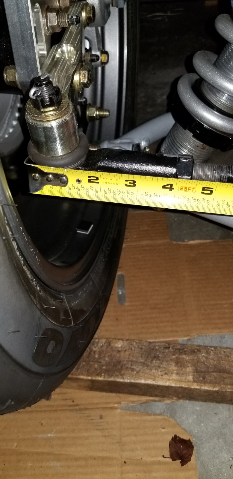

They were KIT supplied. And I believe the box they came in was labeled "Front". I just took it off of the front & put a donor Rod end on and it is around 20 turns (way better). But then swapped the kit supplied Rod End to the rear and it's only 6 turns. NOTE: I am just eyeballing the wheels straight but I'm sure they are pretty close.
