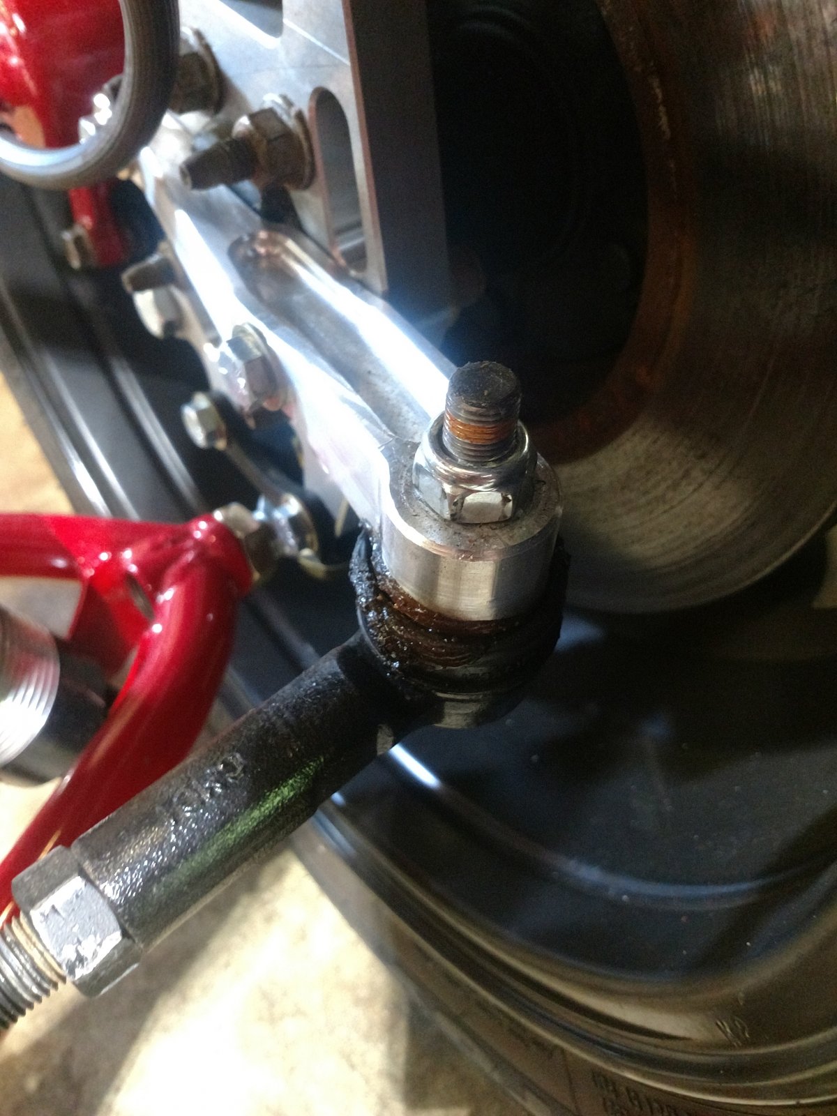

My rod ends are squeaking and groaning every time I move the wheel. Getting pretty annoying when I drive through parking lots etc. I noticed that grease has come out of both of them. Have only run it less than 1k miles at this point.
Anybody else have this problem? Did I put them in wrong or something? Sucks these don't have zirk fittings. Anybody got a part number for replacements?

Are they new tie rod ends or reused from the donor?
These are the new ones that go on front from the kit.

No it's definitely in the ball joint on the tie rod ends. Even the slightest movement on the steering makes them creak. Plus the fact that all the grease is on the outside now. There is no movement in the bolt and I didn't coat the nice billet steering links :cool: I thought that the tapered part went too deep from the beginning because of how much the rubber boot got squashed but didn't really see any other way it should go.

The rod ends included in the kit are supposed to be swapped out with the front, the original ones are supposed to be taken off and put in the rear. The reason is, the original ones are longer and allow more threads to engage to support the torque from the engine.
something there is definitely not right though, locked up ball? I would see if the ball is spinning within the end or if the castle nut it rotating because the ball end is locked up. If you loosen or remove the castle nut and break the tapered seal from the ball end you should be able to easily turn the ball with a wrench. If it does turn, I would try removing it all together and turn the steering wheel. Does it still make the noise? If no, turn wheel/tire manually. Can you hear the noise? Point of all this is just to pinpoint exactly what is doing it. Some noises can resonate through frames making them sound like they are coming from somewhere they aren't

I'm still worried about the grease coming out of my from tie rod ends, definitely going to be a long term issue. Anyone else experience this?
Leaking tie rod ends much like leaky CV joints probably indicates you have a ripped rubber dust boot. You'll need to replace them. Now, if you have tie rod ends with a grease zerk, its possible to put too much grease in there and cause it to leak out.
