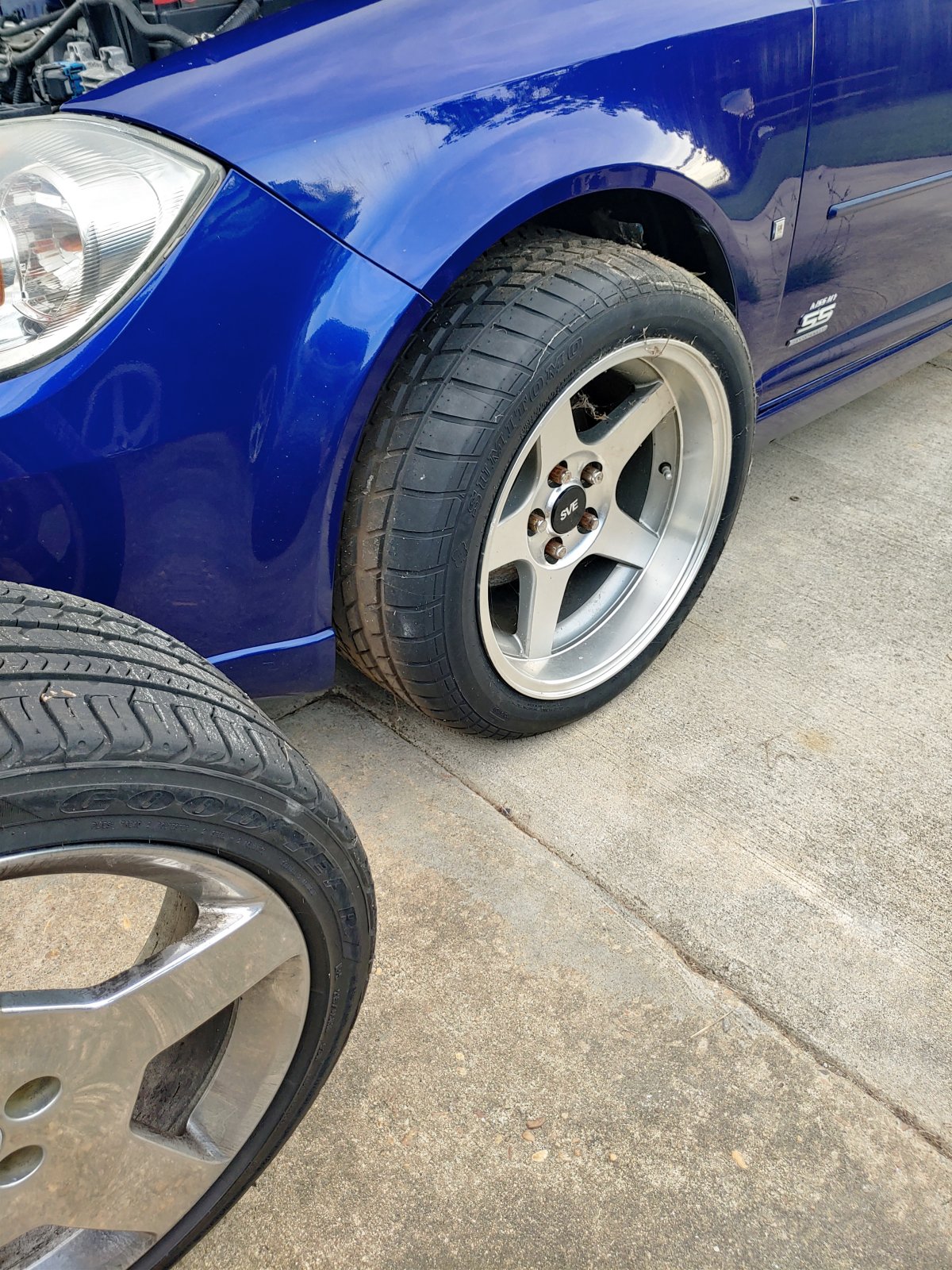

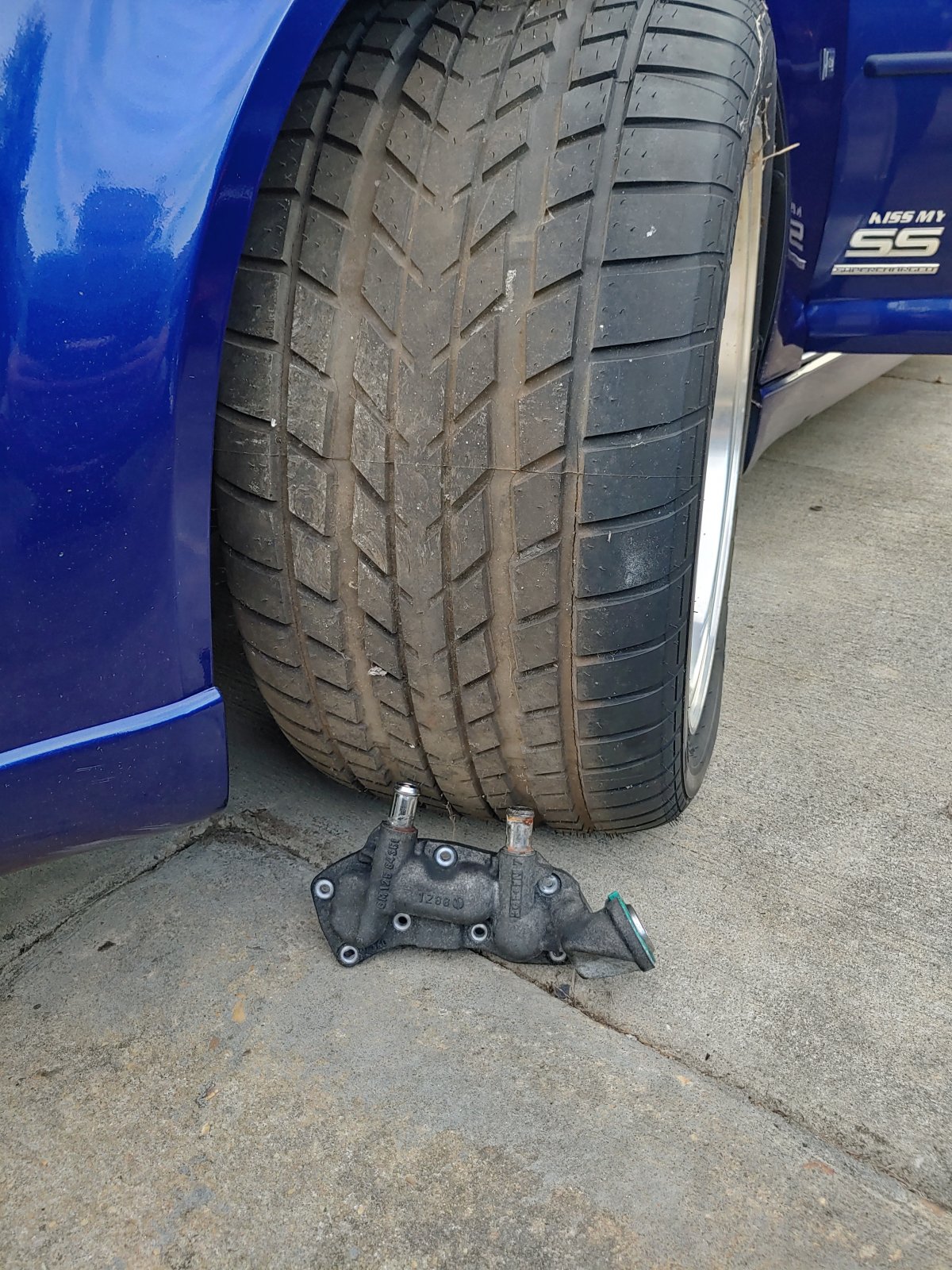

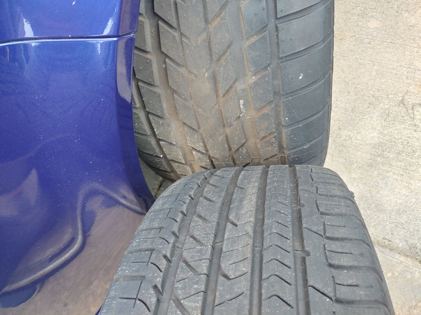

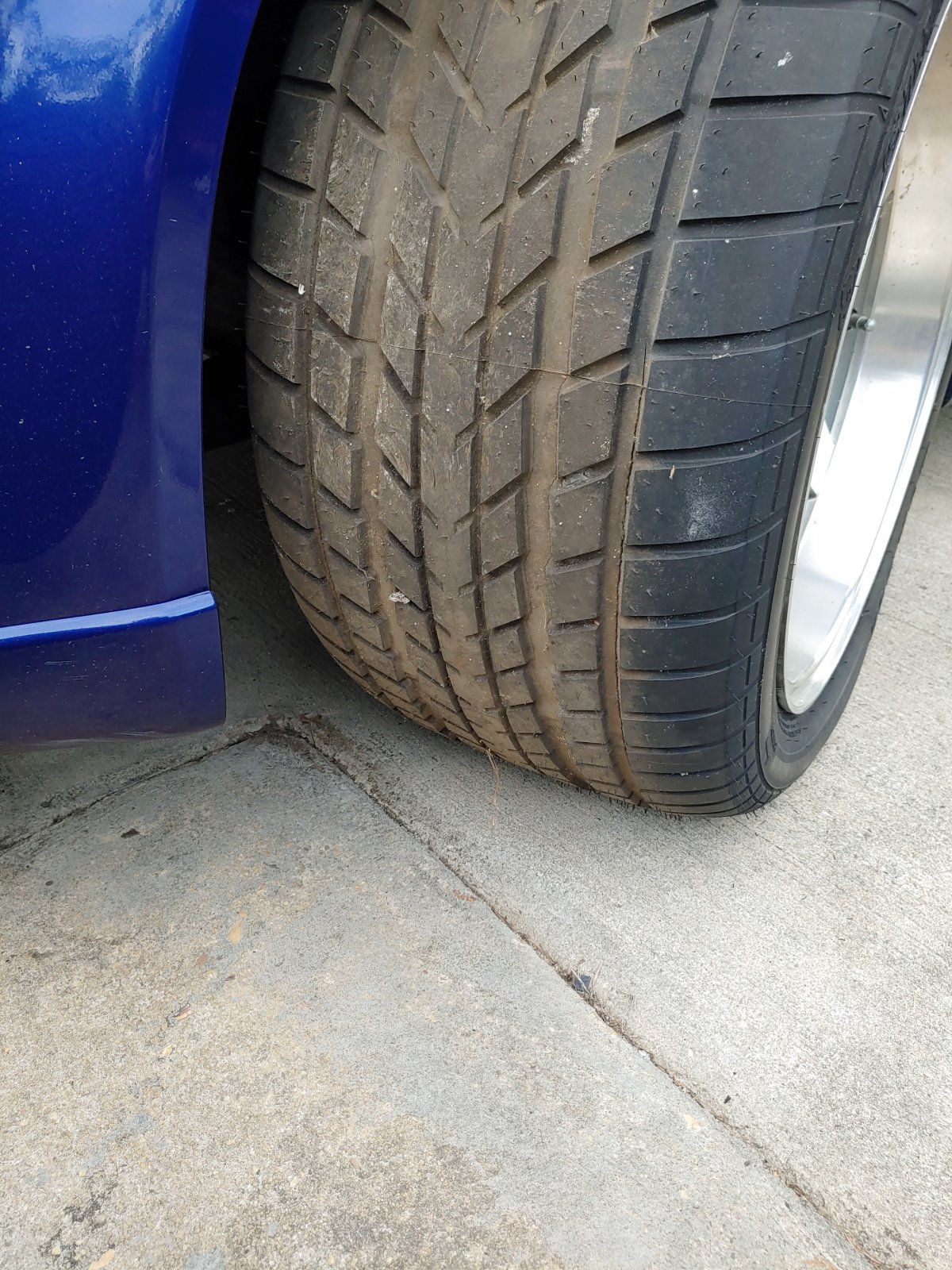

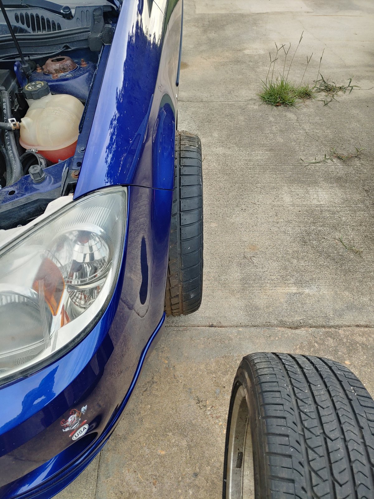

So if it fits a Cobalt it will fit the Goblin right? The tire is a 315/35 R17 the wheel is a 17x10.5 in 5x4.5 The 4th picture show the intercooler endplate for reference i'm sure most of you guys know the size of it. The last picture closest is the stock SS/SC tire then the 315. So whats the word?

When you put the fronts on the rear they don't turn any more so as long as they clear the suspension tower or coilovers you should be fine, right?
I'm assuming they have a substantial offset wheel spacer/adapter keeping them out that far, 315's are fairly beefy even for a 10.5" wheel.
The fronts (cobalt rear), if they're that large, will probably most definitely rub when put on the front... at the A-arm at least at full turn, because mine do as do a few others.
95Blitz
Oh yeah forgot it's got a 1.25" spacer...
I can get my hand between the tire and strut and the tire is under the spring perch. I was wondering about the front guess I could use turn limiters.
