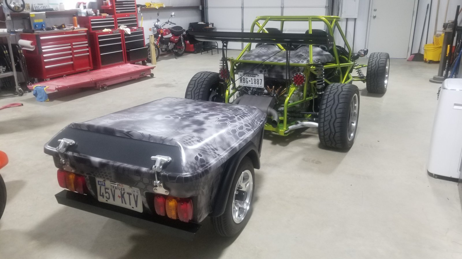

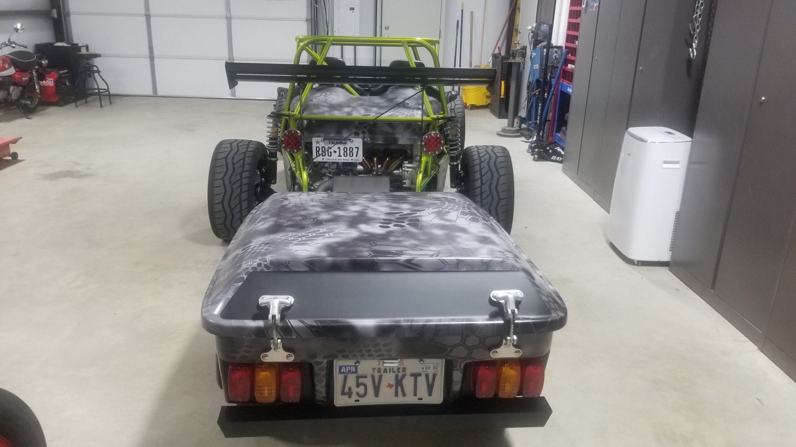

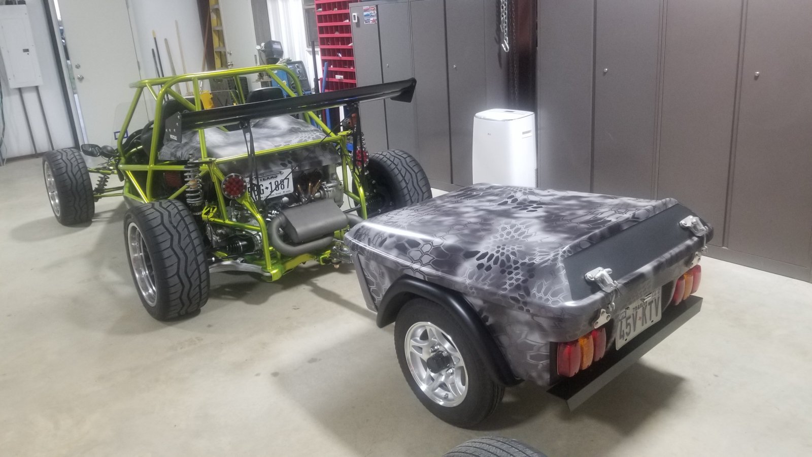

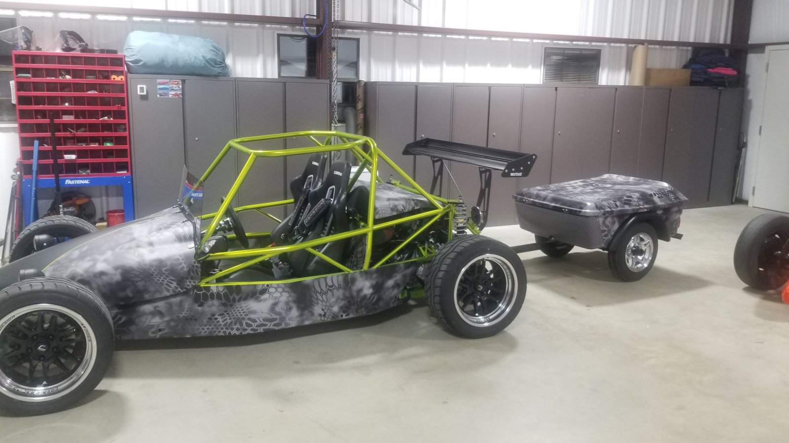

Ready for a road trip

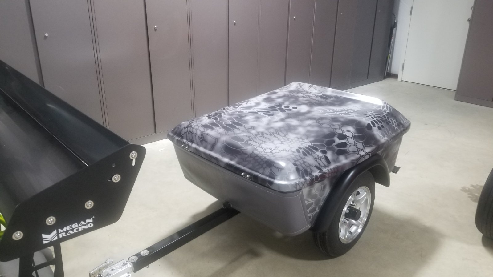

Trailer is wrapped to match the goblin

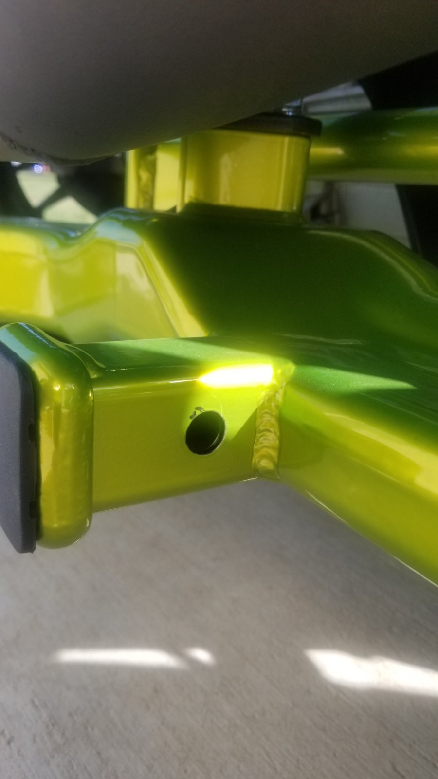

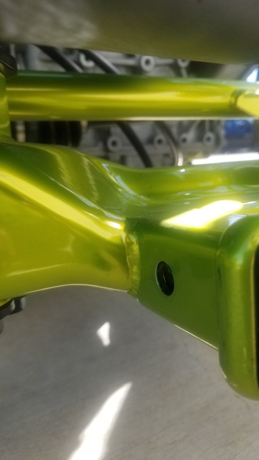

May I ask if you installed the receiver yourself, what was used to cut the opening before welding it in?
I see on Amazon they have 6" and 12" receivers which would I want?
socaljeff3798
Hey Jareth. I did not cut a hole in the subframe. I simpley bought an adapter and cut it the leignth. I wanted it. I wanted it short as possible. Then I used a die grinder to grind it to fit the sub frame. Then just did a butt weld. If you have a good welder do it it's plenty strong. My trailer weighs about 250 and maybe no more than a 100 pounds would ever be in the trailer. Just have to find the center of the subframe and the better your fit meaning no gaps the stronger your welding will be. Pretty simple really. I hope that helps and you are always welcome to call me if you have questions. 951-317-9307
Jareth

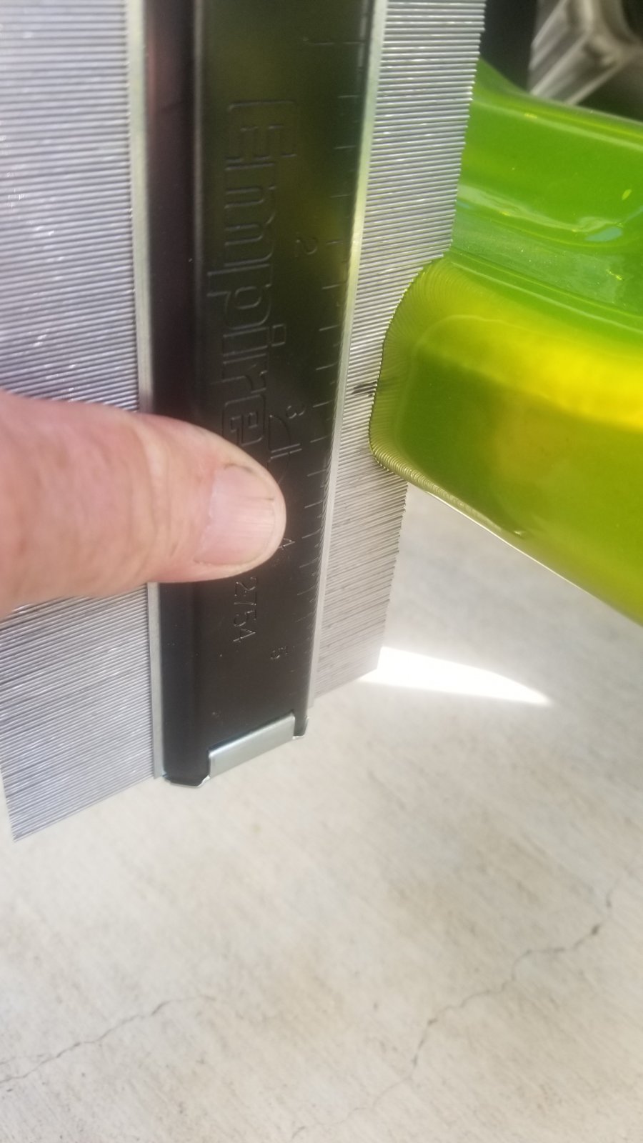

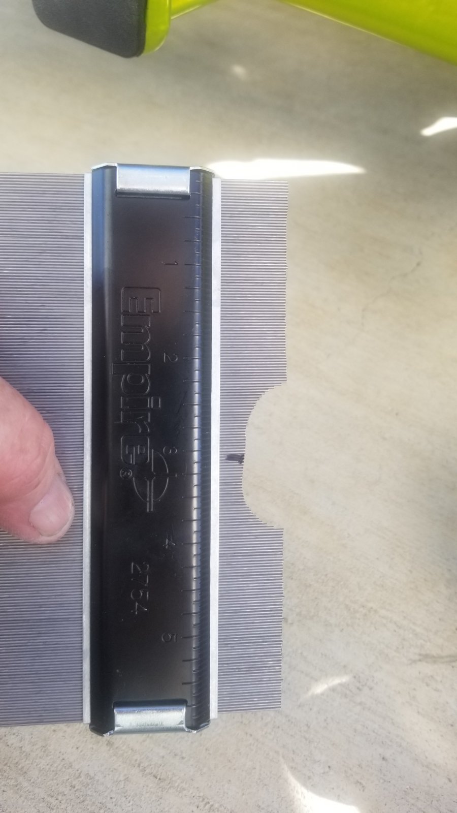

Thanks, that will be easier than trying to cut a square for the receiver to slide into and then weld. I was looking for an excuse to purchase one of those "Contour Gauges" that I keep seeing commercials on. I think it will help to transfer the shape I need to use the die grinder on?
socaljeff3798
Yes here you go.
If you use one of these tool to copy the shape you want it will be easier
