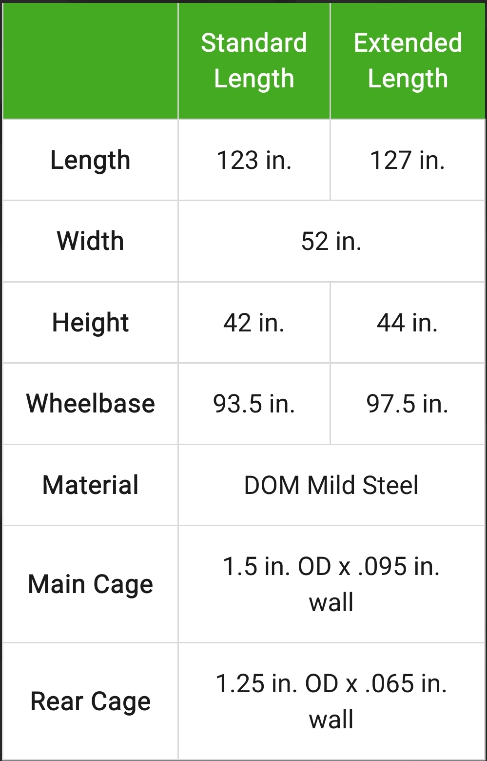

I have not been able to find this via search, but what size/type of tubing is used for the full cage goblin? I wanted to add some additional sections of roll cage to the upper halo. I assume it is something like 1.5 x .120 chromoly tubing?
