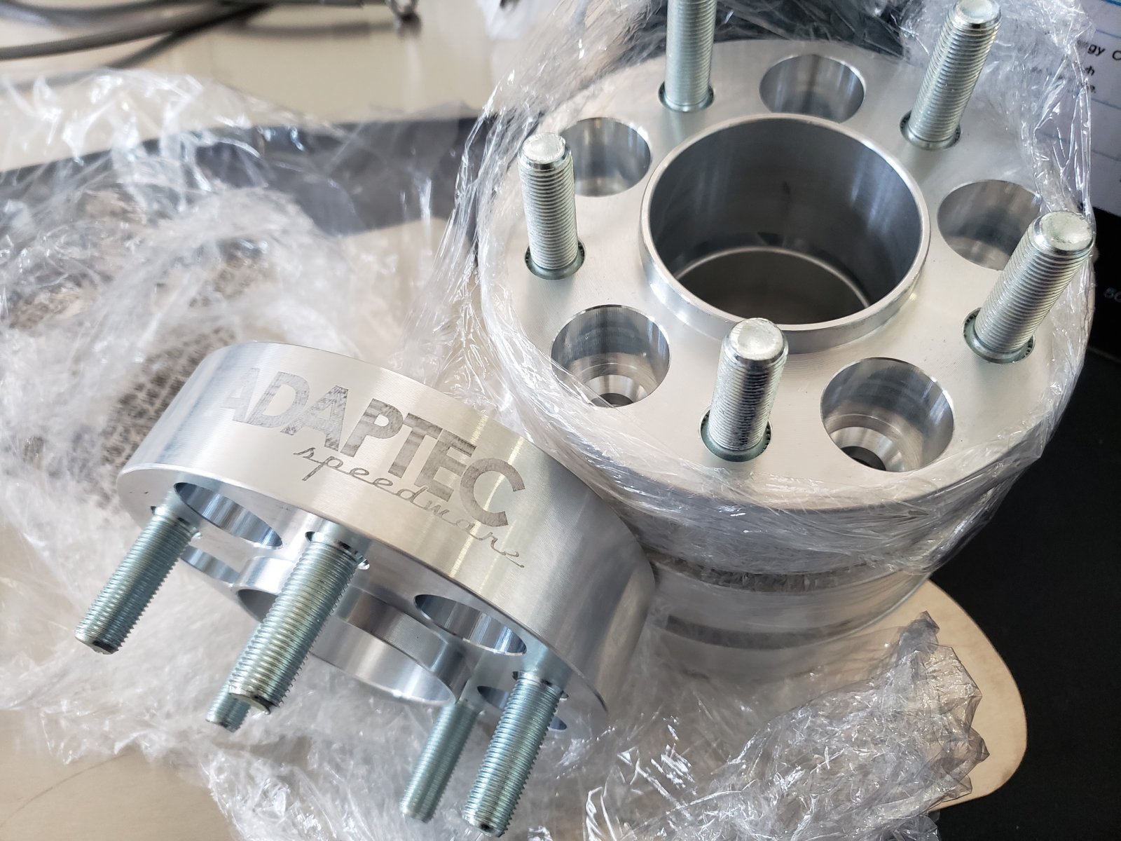

Just arrived:

I have the 5x114 hubs and went with these. The hub on my new rims is 73mm. Only used the spacers in the front as I needed a few mm to clear the brakes.
