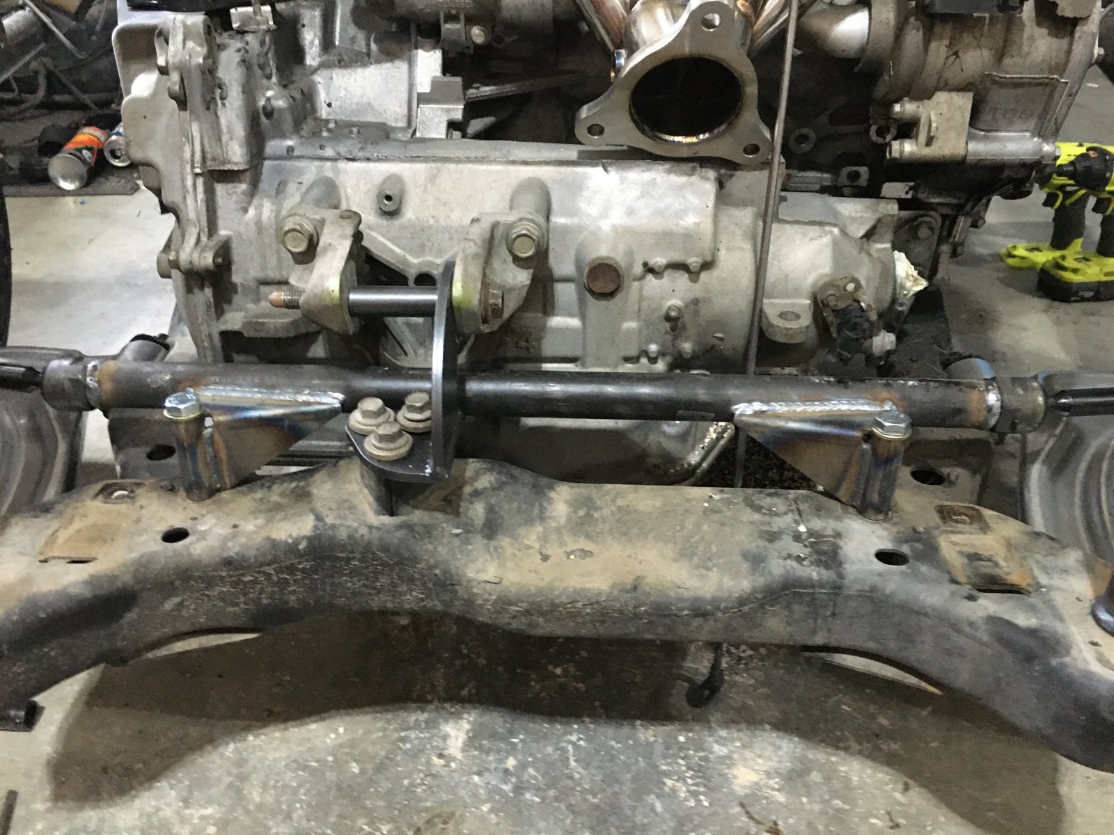

Here’s a pic of the rear toe link and an automatic solid mount put together.
