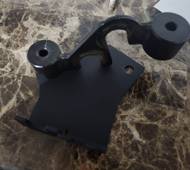

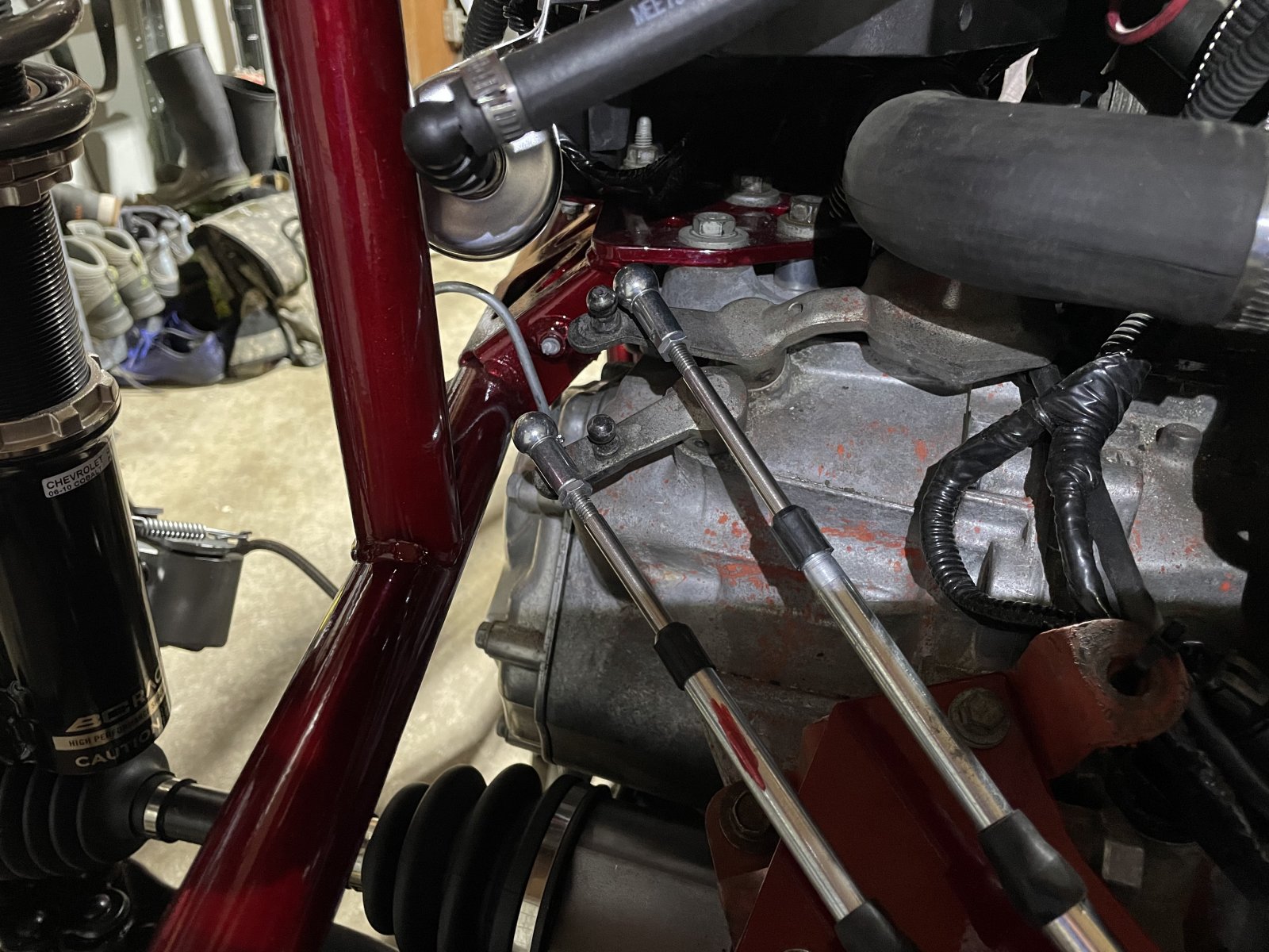

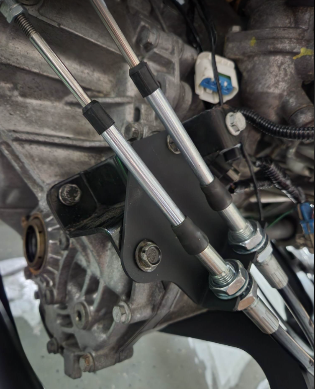

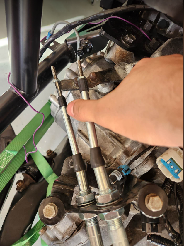

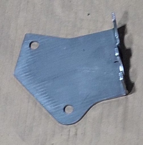

Group, is there someone to reach out too and purchase on of these from? The equipment from the donor doesn't seem like it is going to work for me. It just seems like the angle is going to be too tight and i'll end up breaking something if I add anymore force on it. Suggestions/links would be greatly appreciated

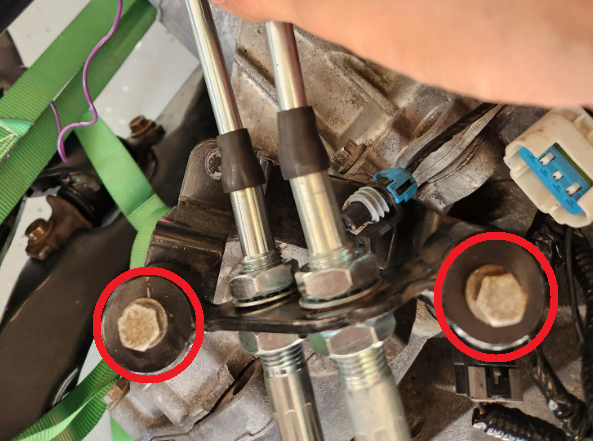

The bolts circled in red get removed and the top half of that bracket comes off.
37672
Then attach the pictured bracket into the same bolt holes as posted above.

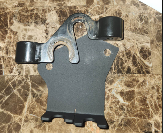

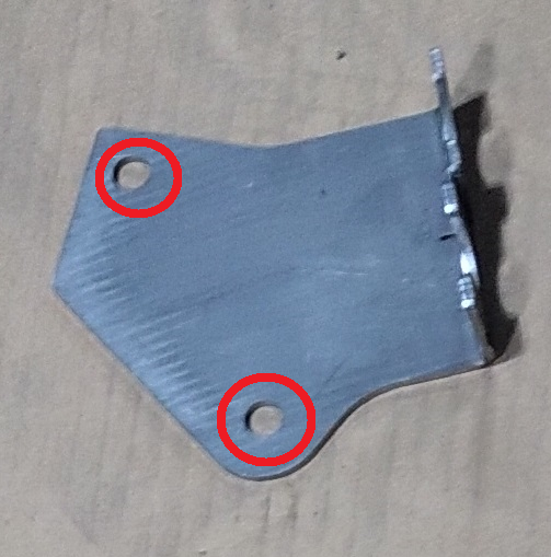

So trying to do this now, but the holes are definitely not lining up. The piece received from DF shows to be to narrow to fit in the previous slot. Even if it were to fit, there has to be some "spacer" to compensate for the difference in height, right? ?

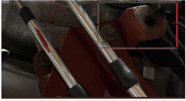

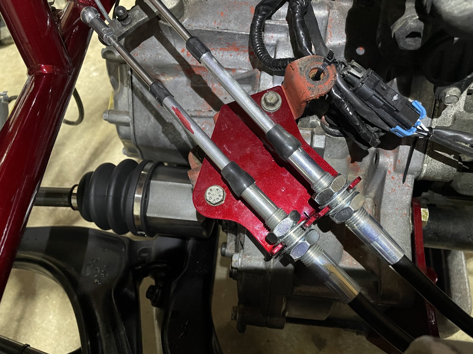

Those two things do not get used together. The small, Cobalt part (shinier part in your photos) doesn't get reused. There should be a metal 'block' from the Cobalt transmission that your DF supplied (bigger/flatter part from your photos) bolts to. I'm looking for a post I previously had as well that talked about this all, I'll edit this post once I find it.....
Edit: It should look like the dull red part in my photo, under the candy red part with the cables attached.

So the way you have it set up is how I set mine up. is that not correct?
The part df sent me i mounted directly on top of the other piece

I'm not sure what is supposed to go there in the red box. I just used it to hold various cables as it didn't seem to attach to anything.
