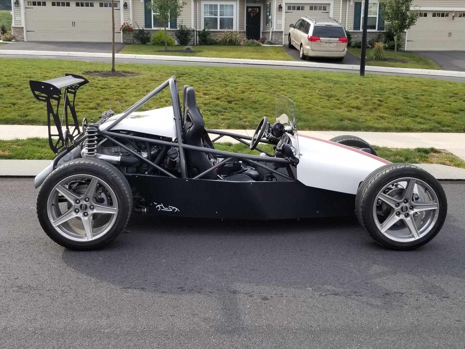

Wouldn't change a thing - track, extended, standard entry - I'm 6'2" and 260lbs. and find entry/exit is fine with the addition of the center 'monkey bar' that I added to the overhead halo. Understanding this is a full cage design there will be some gyrations required to get in and out - the Goblin doesn't have doors.
Additional changes are all mods I decided to make that are not DF design items, because I'm an engineer and I can leave things stock.![]()
What other little thing would you do differently?
Yes, the extended chassis length is all in the cockpit. I sat in the standard length chassis and it was REALLY tight for a person my size.I somewhat like the idea of the extended, Is all the extra length in the cockpit? I was listening to Matt Farah review and he felt the steering wheel was a little close. Not a big fan of the extra height, in picture the goblin already looks a little tall. Is this the experience in reality as well?
What other parts did you make? I'm considering doing my own body work, I have some fiberglass experience. I would also do my own front roll hoop and full cage, purely out of aesthetics, also not sure how soon I'll be doing hill-climbs, etc. where it's required.
I have done some extensive mods to my frame and these are still ongoing. Removed many brackets, added other brackets and extra frame pieces, made low mount seat rails, and have lightened my frame many pounds.
The extra height is usually needed if you are a taller person and need the extra 2 inches of headroom. Otherwise it's a little extra clearance for your helmet to be below the top of the halo. This car is not tall by any means, you need to see one in person to understand just how small it really is. The pictures of a frame are deceiving.
I think that I'm the furthest north in WA, being in Arlington. The only one in Canada that I'm aware of is located in Manitoba. The builder's map shows one in Bellingham, but that one belongs to AleX1/9, who had moved down around Tacoma when I was ordering mine.I would love to visit the shop, I'm in Victoria BC Canada, so crossing the border now isn't an option. I don't know of any around me, never seen one in person. Maybe if someone knows of one around Vancouver BC, and can get me in touch?
Moving the pedal box is a difficult option and would require a lot welding and fabrication - you should check out the build logs for photos. Moving the steering wheel location is far easier and there are at least 2 builders who have moved the steering wheel location forward.My idea if I go with the extended cab would be set the seat all the way back or at the correct spot from the steering wheel and move the pedal box accordingly.
Also as a general rule of thumb a longer wheel base is more stable at higher speeds.
