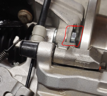

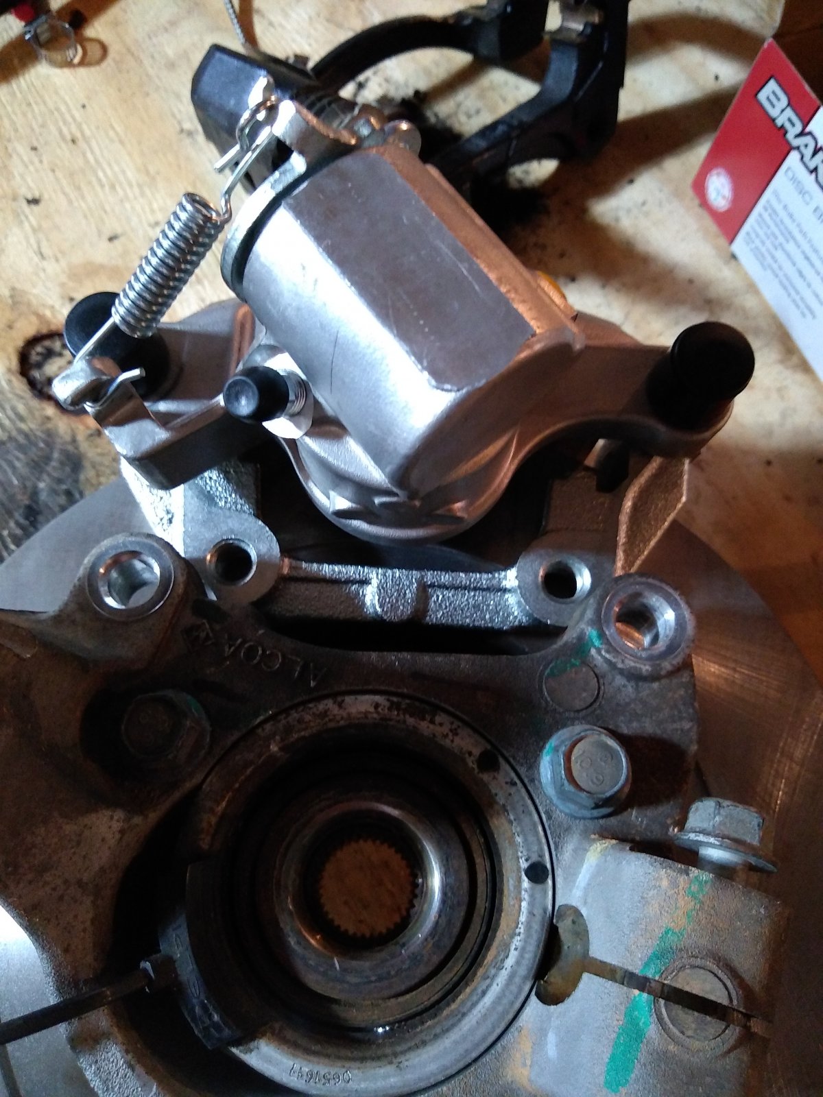

The holes don't line up for the front (now rear) knuckle and the DF supplied rear brake caliper with the emergency option. What are my options?

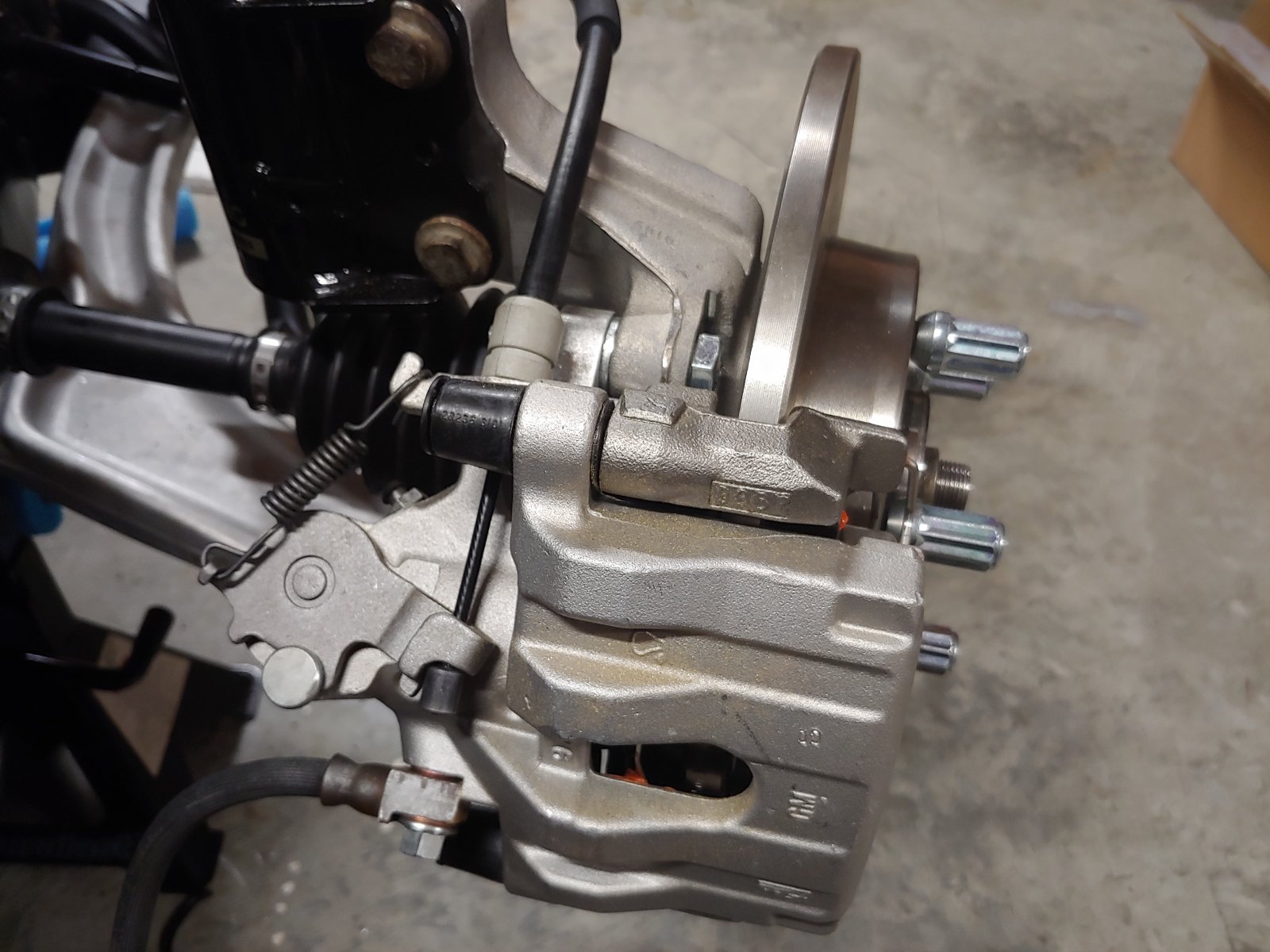

Only picture I have right now:
19874
Note that mine is an 06 SS/SC, I had to add a washer between the knuckle and the adapter, not sure if that is still required with the newer parts.

I have (barely) enough clearance between the rotor and the brass bolts. The problem is neither the bracket nor the knuckle is threaded. May have to go to the auto store to get hardware to fit.

I think I remember needing to buy the high strength bolts you can see in that picture:

Thanks for the info, SM, but I just got back from O'Reilly and they had exactly what I needed. One issue I was having was no clearance between the rotor and the bolt, but the guys there test fit and made sure everything worked.
