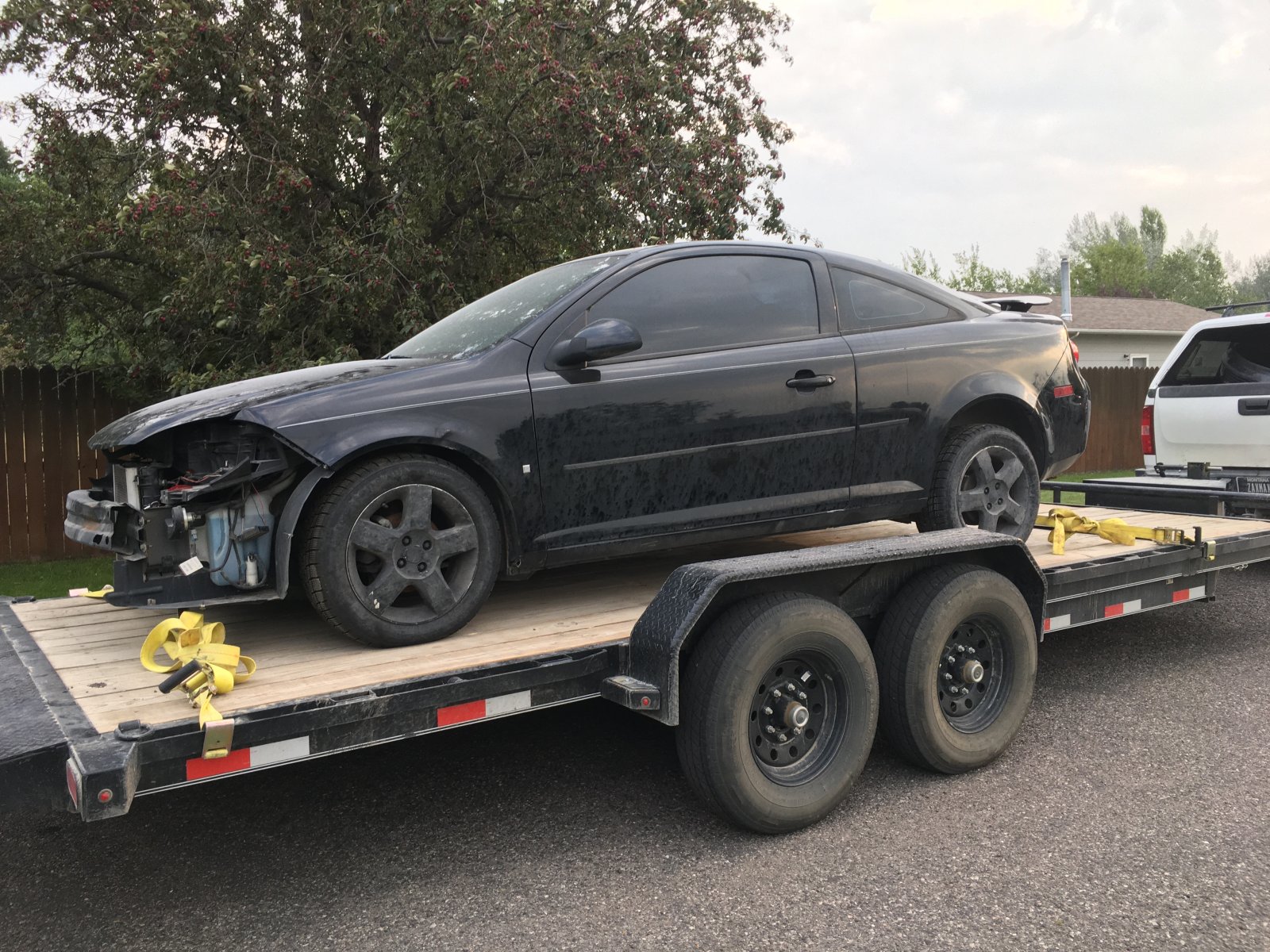

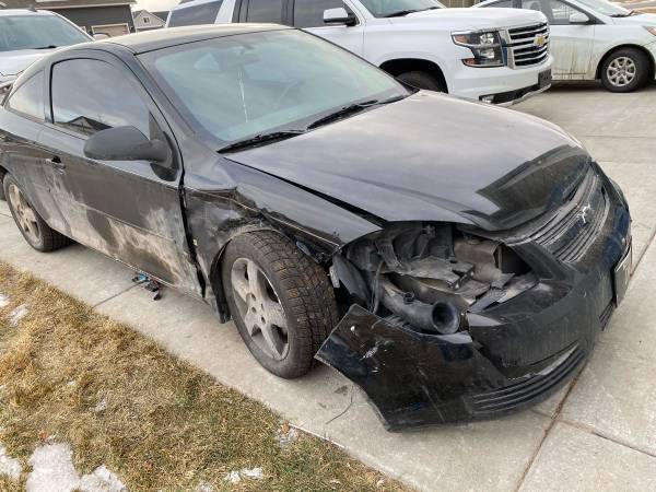

I found a wrecked 08 Cobalt 2 hours from my house for $1,000 the next weekend so it was game on. I’ve never been so excited to load up a wrecked pile of crap, but my wife was seriously questioning my sanity when we got there. Is this thing really worth $1,000?!?

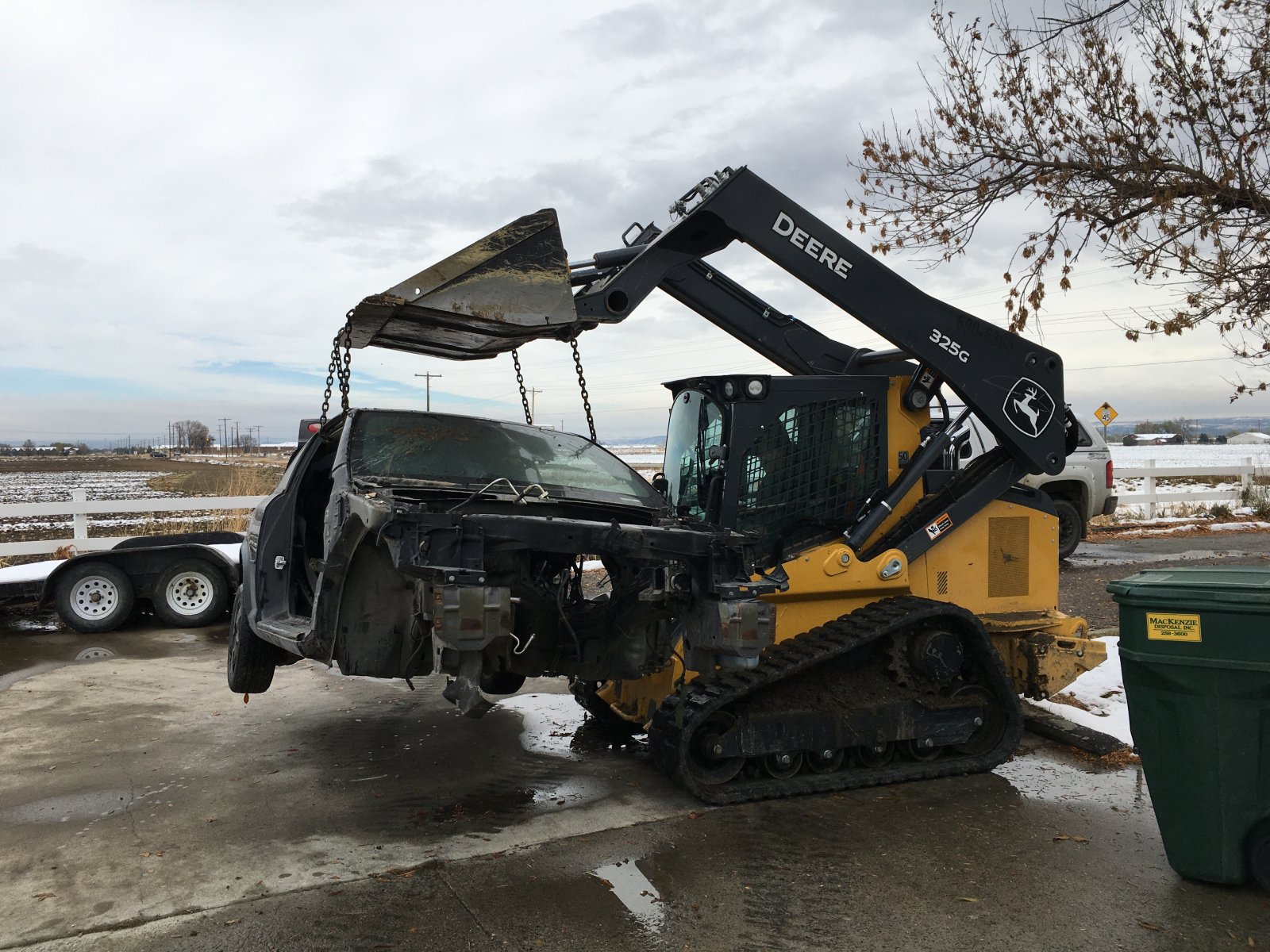

The donor is now completely stripped and thanks to my little brother stopping by with his Deere it’s now back on the trailer. I’ve been slowly working on my wiring harness and it’s almost done. I’m taking my time with it not cuz it’s hard but because I really don’t want to clean up all the gross donor parts yet.

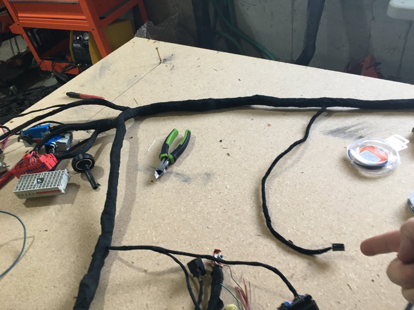

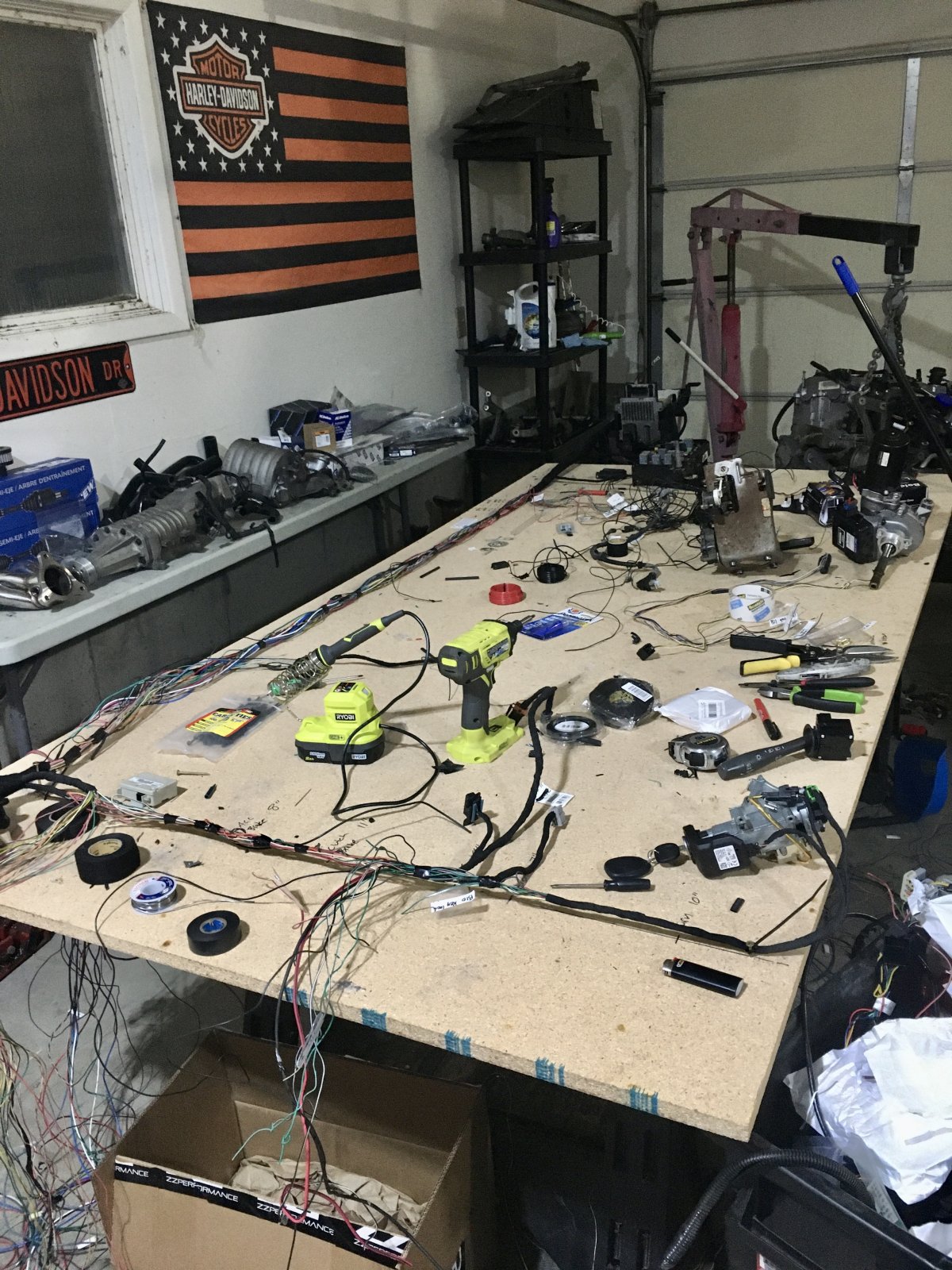

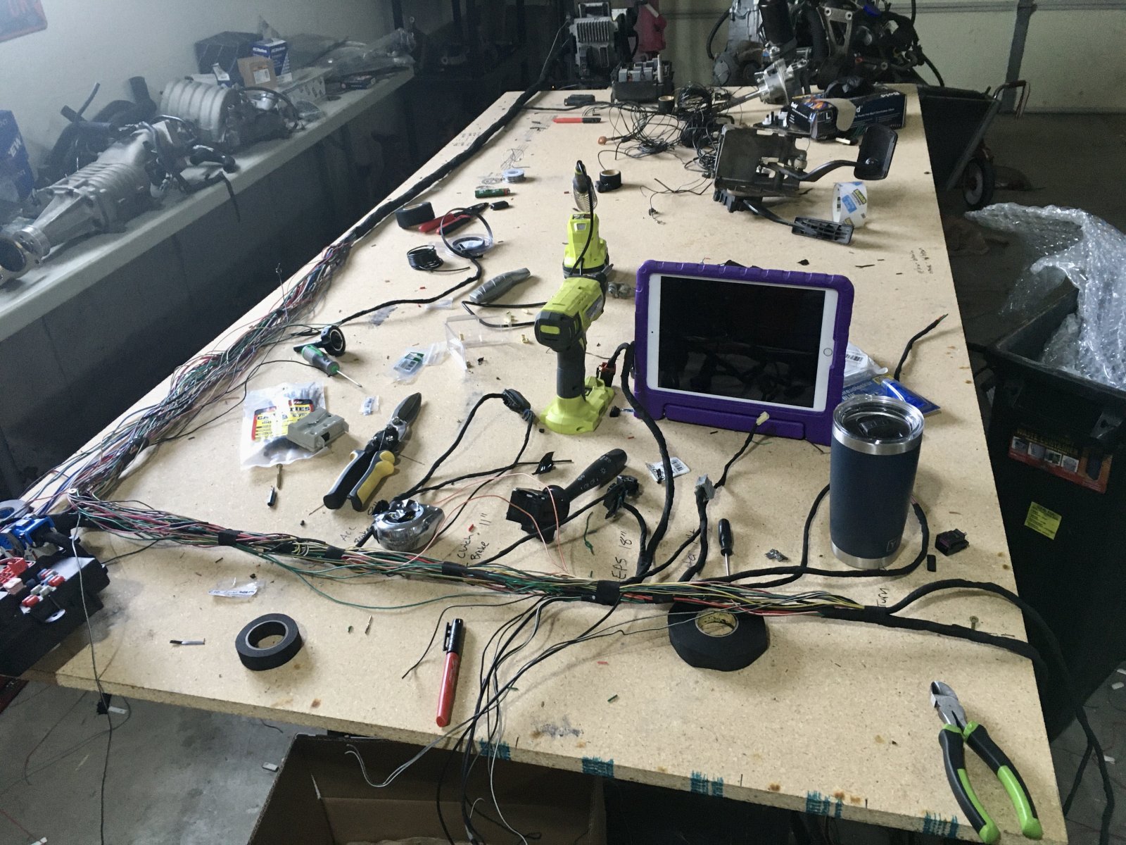

Made it to the end of the ninth harness video. My table looks like a disaster but the harness is looking good. I did make a huge mistake last night and cut off the EPS data connector. I didn’t just cut it out either. I cut one of the pairs of data wires super short on the BCM plug. Luckily the parts manager at the GMC Cadillac store I worked at forever was working today. He just let me go back and grab a handful of pins for free. Crisis avoided

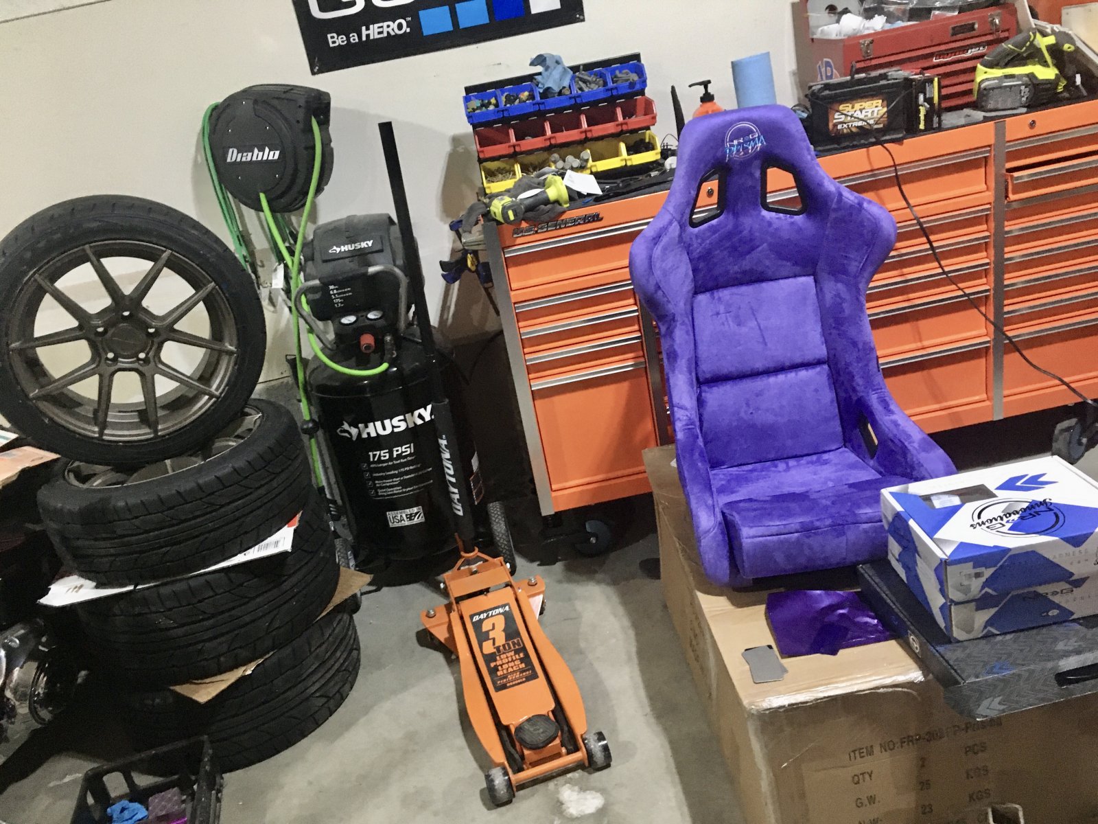

Here’s also a sneak peak at the color scheme. Matte purple ghost metallic vinyl for the hood and sides, purple NRG seats and quick release, and some bronze Avid1 wheels. I’m still undecided on the chassis. I’m thinking either satin black or going wild and trying to match the bronze on the wheels and do black control arms. I have some prismatic samples ordered to see if something stands out.

Here’s also a sneak peak at the color scheme. Matte purple ghost metallic vinyl for the hood and sides, purple NRG seats and quick release, and some bronze Avid1 wheels. I’m still undecided on the chassis. I’m thinking either satin black or going wild and trying to match the bronze on the wheels and do black control arms. I have some prismatic samples ordered to see if something stands out. View attachment 18087
Looks like it'll be stradman approved! (For those who don't know stradman is a youtuber)

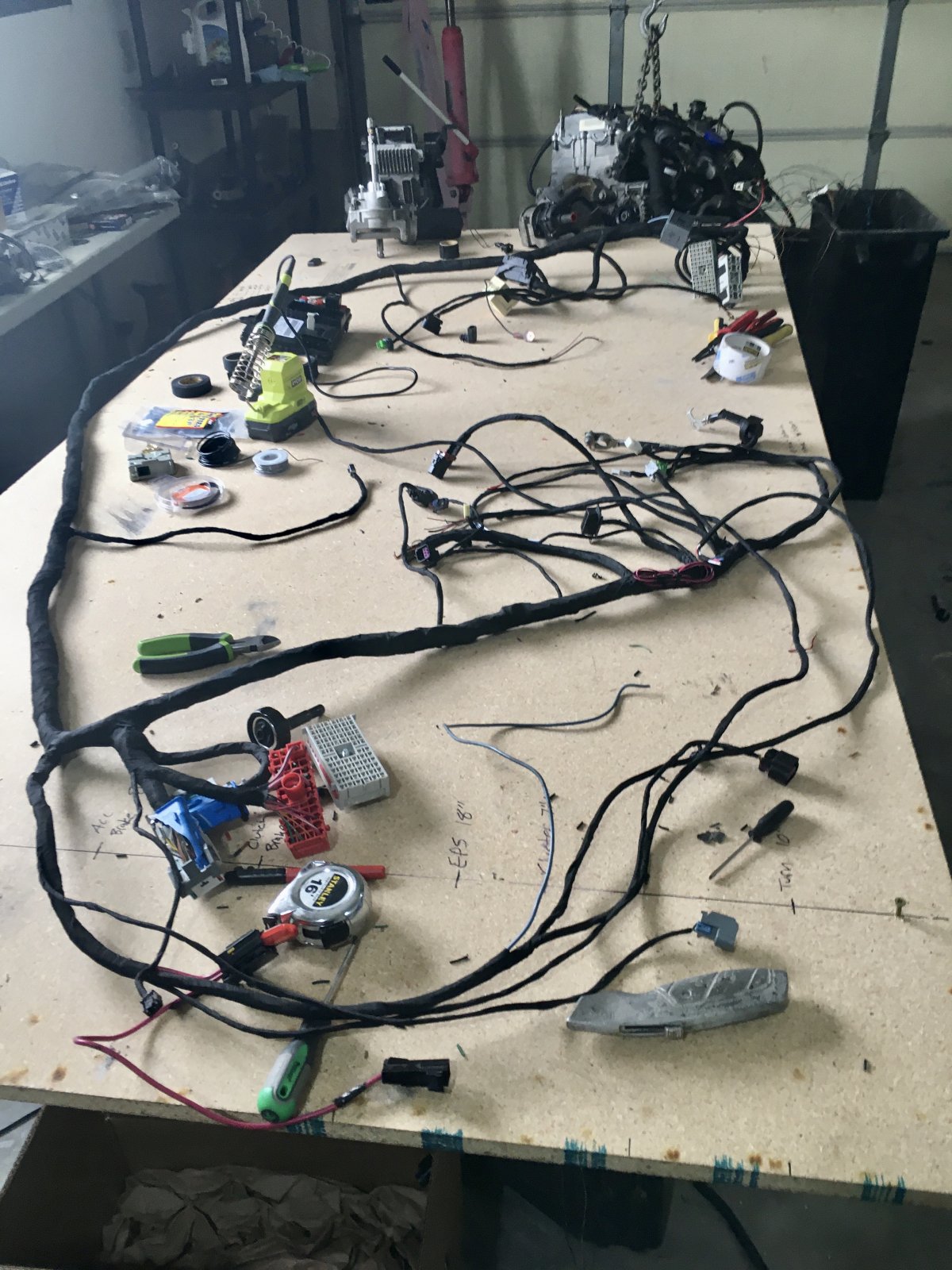

Got through the 10th harness video. It’s getting real close now. One thing I don’t see addressed in the last video is the handful of loose grounds I still have in the main harness between the fuse block and BCM. I found an old wire harness map picture and it shows a tunnel ground coming out of the harness. This doesn’t seem to be in the new video series. Should I put a ground lug there or just tie all those to the grounds in the dash?
The tunnel ground was eliminated shortly after my frame #121, as it was a difficult location to get to.
I used 3 grounding spots in my car: 1. on the battery box, 2. on the pedal box, 3. on the driver's side transmission mount.
The grounding wires were routed to the nearest one.
Goblin Graber
Thanks Ross. I’ve got the same spots you do so I’ll stick with those and not add the tunnel ground. In the video he tells you to knot them up and that they will be dealt with later. Then later he just taped up the harness.

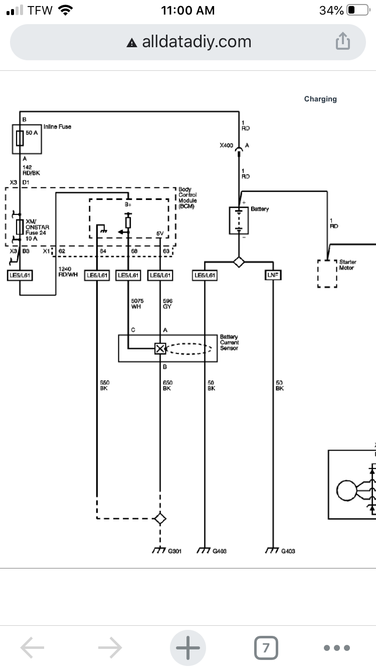

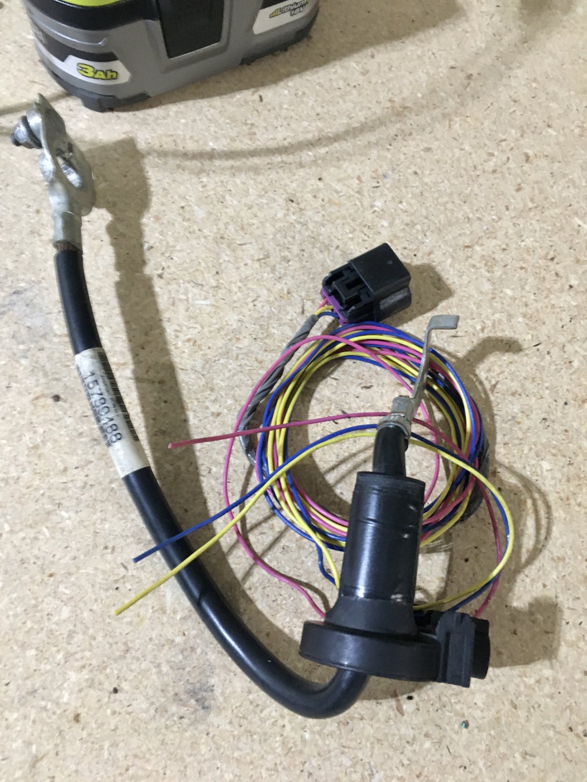

I did want to share 1 another mistake I made, 2 why I think I did it, and 3 how to fix it. Hopefully this keeps someone from making this same mistake.
1. At the end of thinning the main harness I had another 3 wire plug with a grey, white, and black wires near where the taillight plugs were. I couldn’t think of a use for any more wires that were back there so I removed it. Turns out it was the Battery Current Sensor connector. This is an essential circuit to regulate alternator output.
2. I did some research and this is on all base model cobalts. Lonny is working on a turbo harness, so it’s never mentioned.

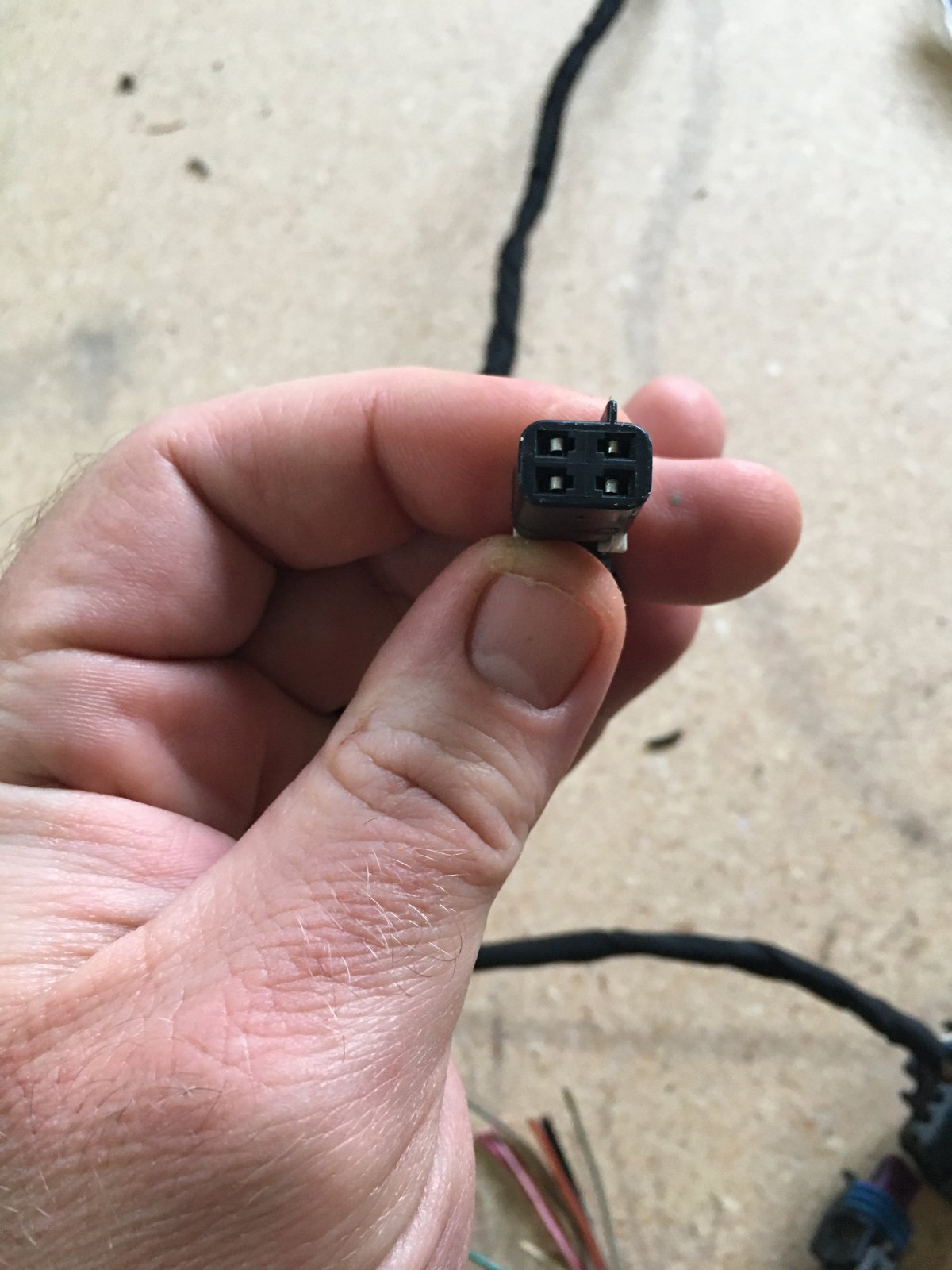

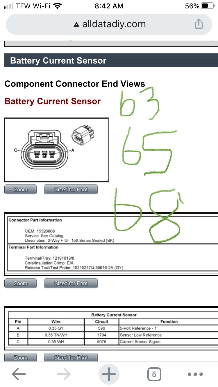

3. Now on to fixing it. Sure you can solder wires back to your connector and bcm plug but I found a better way. You should have this plug with about 5 feet of wire attached to it that was for the passenger seat weight sensor.
This connector is the same as the one used for the current sensor. This lets you keep one clean factory end. Here are how the wires need connected. The connector pin out in all data shows pin B should be tan/white but it’s actually black.
Pin A Dark Blue - BCM pin 63 Grey
Pin B Pink - Ground near the dash harness
Pin C Yellow - BCM pin 68 White.
Here is the diagram for the connector. I added the schematic as well.
Hope this helps someone.

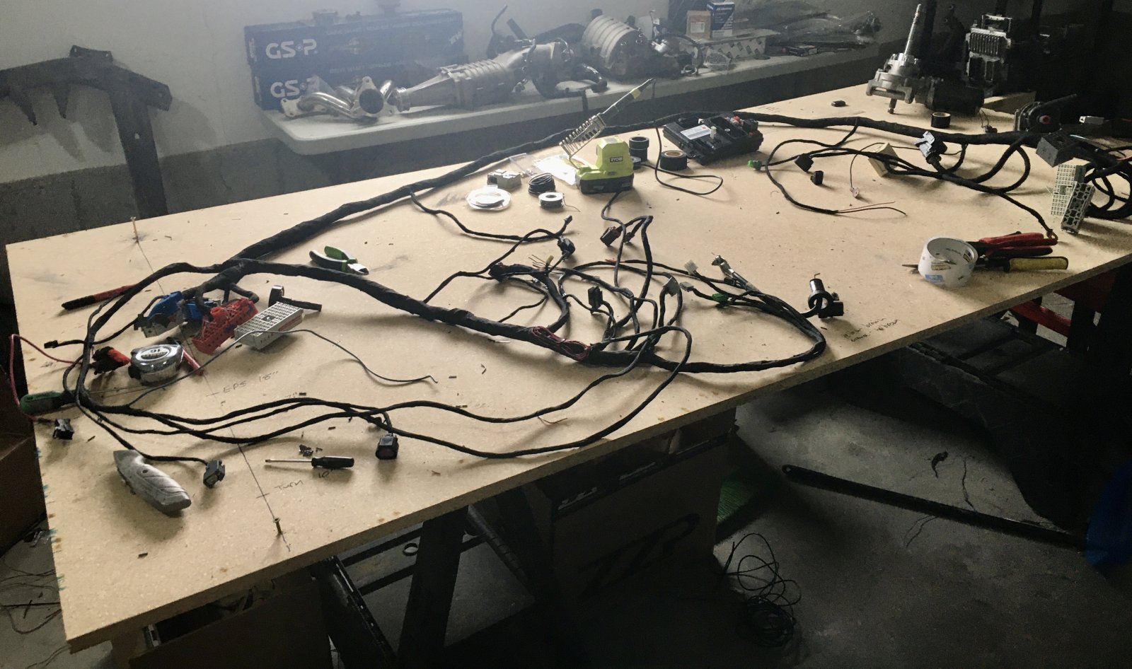

And now your Goblin harness is ready to go! Now on to cleaning up and painting the donor parts. This thing should really come together pretty fast once I get the kit.
Goblin Graber
If you’re on the fence at all about doing your harness or sending it off save the money. You can totally do it! If you have a turbo SS it should be as easy as following along to the videos. My harness was definitely different in my donor so here’s some stuff to help someone that doesn’t have an SS/TC get their harness done.
If your car isn’t turbo charged it should have a battery current sensor. Make sure you keep that in the harness. Pull the plug back to the BCM and tape it up when you tape the headlight wires in the last video. Tie the ground wire from that plug to one of the dash ground wires.

4. You will have a small 4 pin connector left in your main harness that will trace back to the BCM. That connector is for the shift interlock solenoid on your shifter. Add 18” extensions to these. Start pulling those back toward the fuse block. Split them from the harness when there’s about 20” of wire left from the connector.

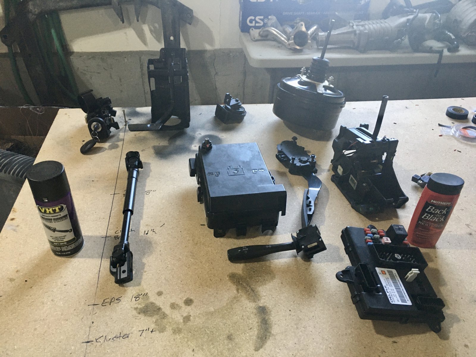

Decided to go out and cleanup and paint some of my junk parts. I mean donor parts. A little VHT satin black epoxy and some Mother's back to black has this stuff looking good.
I still have the steering rack and the brake calipers to paint. Those things are pretty gross and are going to take some serious cleaning!
