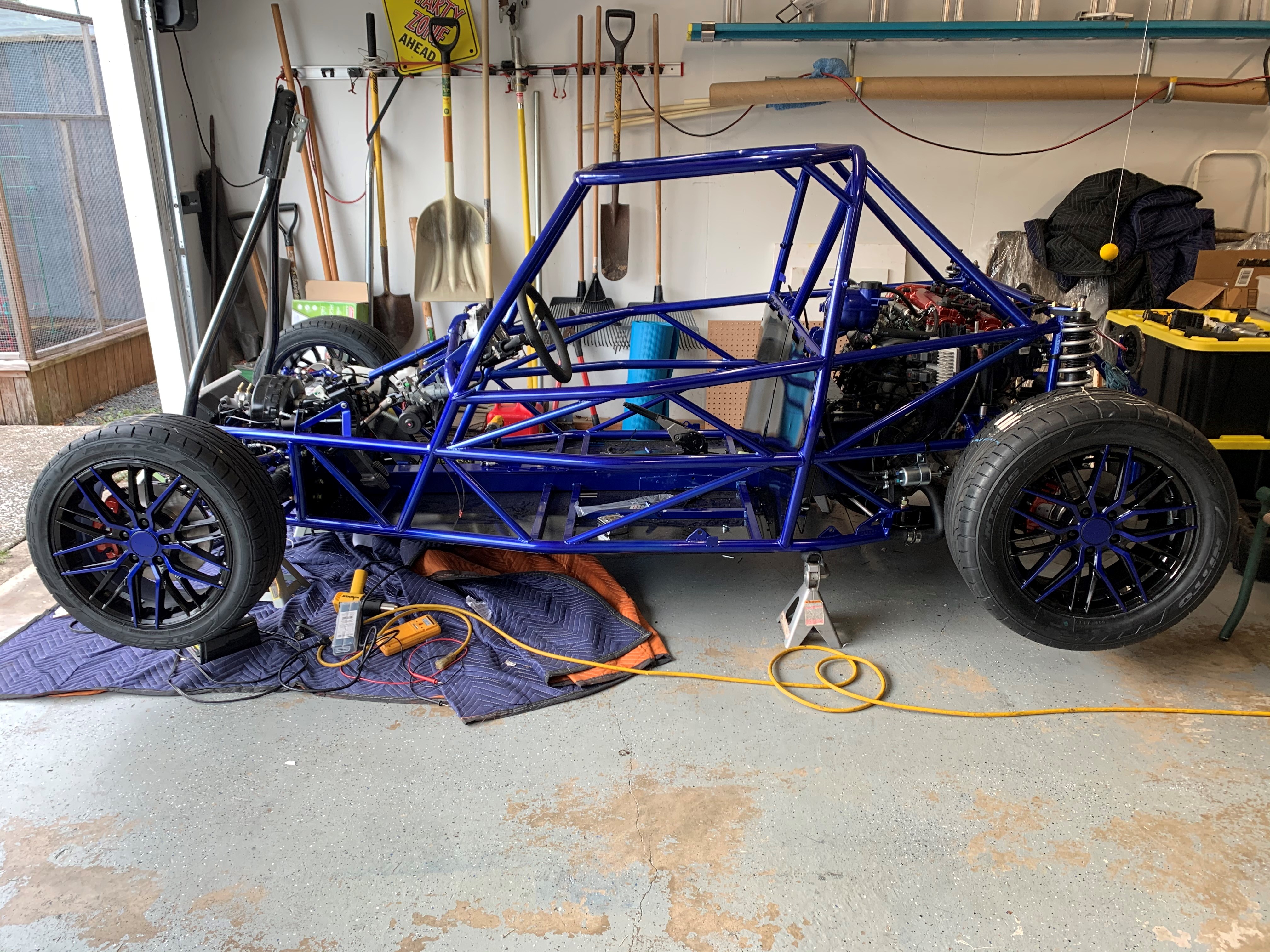

Looks great. Also having a hard time getting seats from Braum, Braum harnesses & the rims (AVID.1 AV06) I need in a custom size. Not to mention wheel spacers on 10 week backorder.
hey devonrex, have you mounted your seats yet? Mine arrived today and it doesn’t look like a simple bolt in project like I was hoping for.
Yes, I got them mounted but used the mounting brackets from DF which bolt in. Althought I had an issue with all the holes lining up on the shortest and longest postion, middle position works fine. Might have to attach the brackets to the seats first (instead of to the car first) then install the seats.
Also I have an extended frame so I am having to swtich out the standard brackets to a new DF seat bracket designed for the 4" extention. I could not reach the pedels with the standard brackets.
I also have the df brackets for the extended frame however I ordered the wide seats and they just don’t fit between the supplied mounts. I’ve contacted Lonny to see if they have a solution just waiting to hear back. Glad yours went ok.
