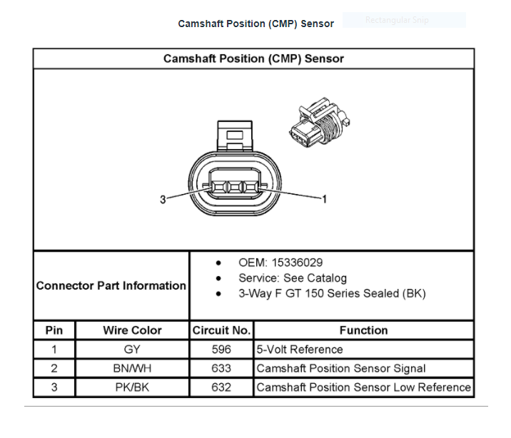

I had a pressure plate failure and replaced my clutch, trans, starter and now the car doesn't start as normal.
The motor turns over a good 15-20 times before it will fire. Once the car starts it runs well so Im not sure that it may not also be an issue with fuel or a weak starter/wiring. Noticed that my cam position sensor wires were completely ripped out of the plug and not sure how to wire them back up.
Does anyone have any pictures of the cam position plug with the wire colors in the correct locations they can share. Not at the car at the moment. But I believe there is a pink, green and black on mine, 07 ss/sc motor.

This is from Alldatadiy for the 06 SS/SC
