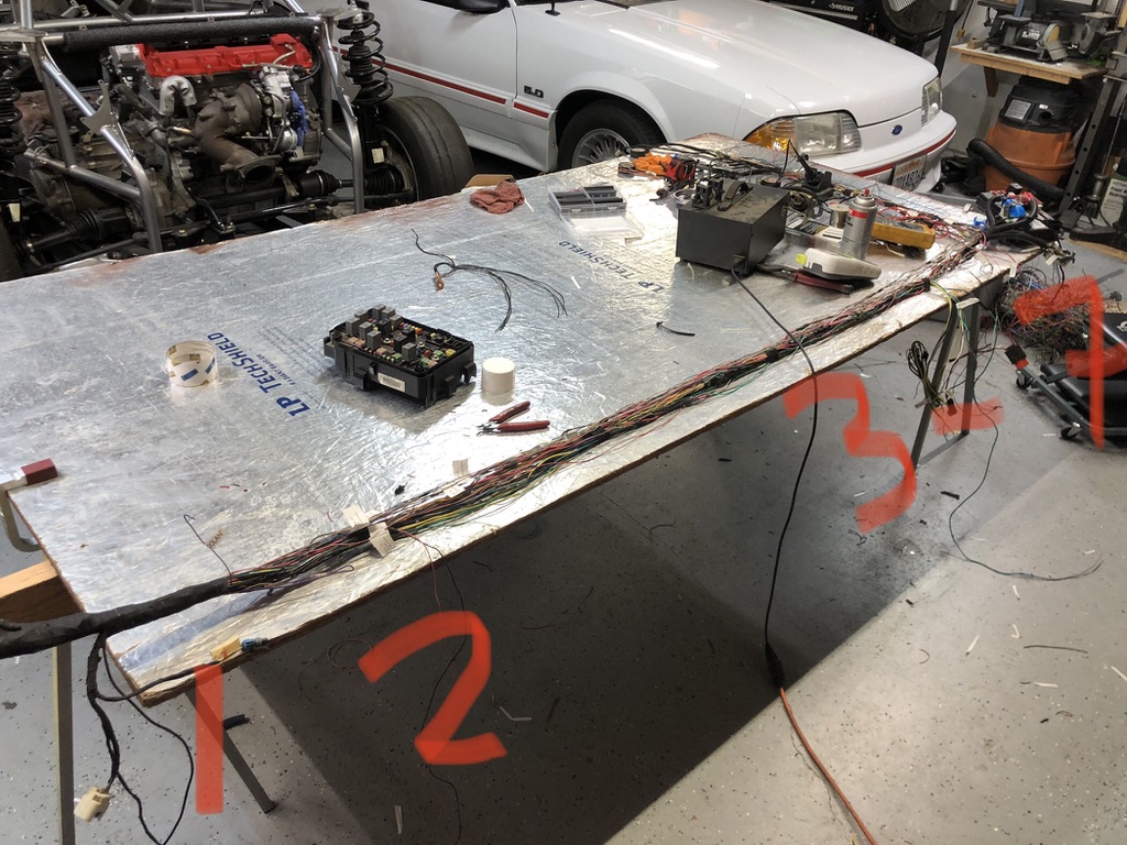

There are 7 wires, as you can see in the pictures questionable wire #1-2 are at the fuse box side, and 3-7 are at the BCM side.
Fuse box side:

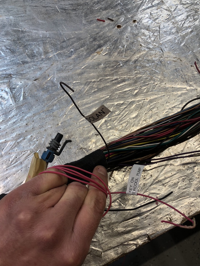

1) Brown wire: the other end of it goes to the coolant tank plug. However, I don't know where to land the wire to. The second wire on this plug is grounded.
2) Pink/black pair. I labelled this "B2 key on intercool pump." I believe I'm supposed to run this down the main harness, and drape it over the BCM to be taped into the headlight harness?

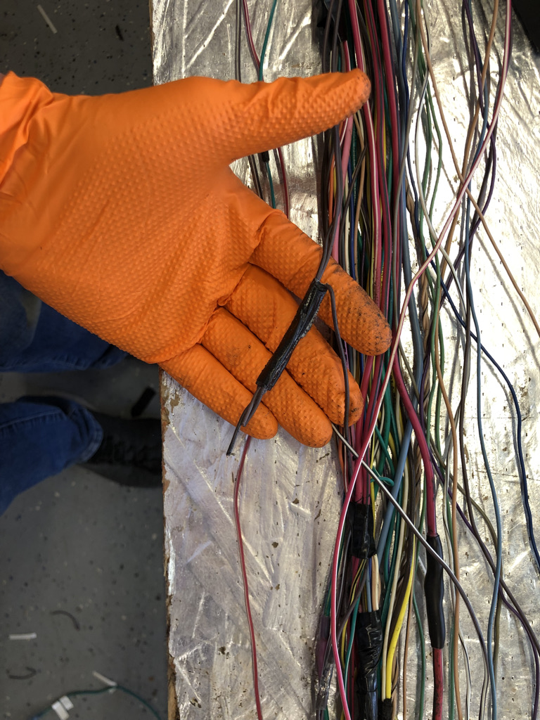

3) Thick blue wire. The other end of it goes to the fuse box side to a female quick disconnect which I believe is for the radiator fan... but what do I do with the wire at the BCM side?
4) Two brown wires that were knotted together. They seem to run down the main harness to the fuse box side.

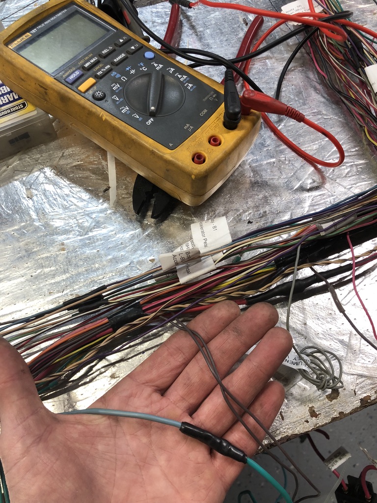

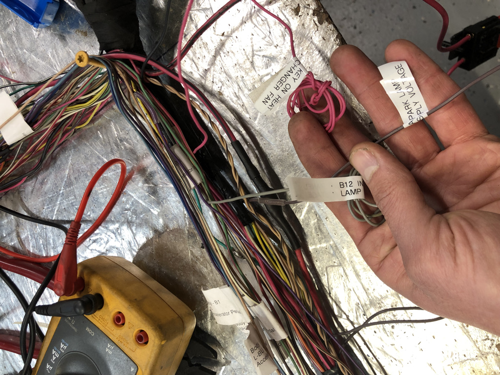

5) Grey wire, coiled. I traced it back to BCM connector X3, pin B12: Instrument panel lamp supply voltage.
6) Brown wire, knotted on the end. Traced back to BCM connector X3, pin A7: Park Lamp supply voltage.
7) Pink wire: I remember this being brought up in one of the early videos, and I labelled it as described in the videos as "D7 Key on heat exchanger fan."

Rough locations of mystery wires:
50454

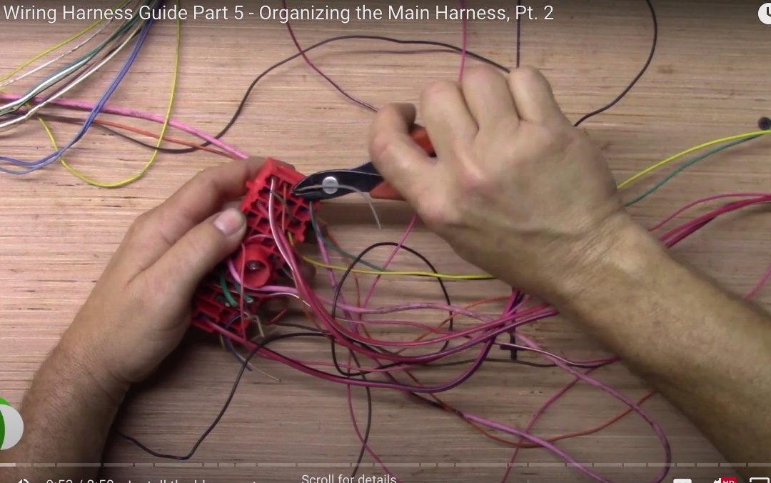

The coolant level plug is cut and pulled back to the BCM and later extended to the fuse box side of the car. "Wire Harness Guide Part 5 - Time Stamp 7:00"
This wire is to power your intercooler water pump when the key is turned on. This pair stays at the rear of the car. A red extension wire is attached in the video. "Wire Harness Guide Part 6 - Time Stamp 3:00"
The BCM side gets attached to the radiator fan wiring, the fuse box side gets tied into the black plug. "Archived Goblin Assembly Videos Part 20 - Time Stamp 5:00"
The two brown wires are more than likely going back to the fuse box for the rear brake lights. Watch part 5 as they talk about what wires to pull back to the fuse box as you are cleaning up the harness. The wires get taped and organized with the other tail light wires in "Wire Harness Guide Part 6 - Time Stamp 4:20"
May need to be tied into the cluster plug. My cluster was not lighting up and it was because of the missing wire and a missing fuse. http://dfkitcar.com/forum/index.php?threads/traé’s-goblin-06’-ss-sc-501.4766/post-100603
Seems like it is powering parking lights for the front. I would think there would be two wires coming from a brown junction. Watch "Wire Harness Guide Part 10" as they start to combine everything.
Powers heat exchanger fan at the front of the car behind the radiator. When wiring this, it is recommended to install a diode to keep the car from running for a few seconds after the key is turned off. I have a few leftover and can mail you some.
BCM Side:

1) The issue was the previous owner cut this wire a few inches proud of the BCM connector, taped it into the "leg" of the harness, and also lost the original coolant plug. So, to anyone looking at this later... the wire should be light green all the way from the BCM-plug (as shown in the video)... mine is brown because the PO used a different plug, and I'm not seeing anywhere that you're actually supposed to even cut the plug.
2) This pair is good as-is.
3) This blue wire is good as-is.
4) Brown wire... this one was fun. Traé directed me to the video which led me to trace down the junction which the PO taped up. I cut open the tape... aanndd...
50464
This has been par for the course. I guess the PO decided to cut all the wires out of it and dead end both sides, but still leave it in the harness. In the videos, they runs 3 wires out of this junction to the fuse box side (for license plate/left+right tail lights [parking lights]), and 3 go to the BCM side, where 2 are dead ends and 1 still looks connected to something in the video. The 1 that is connected to something in the video likely goes the BCM. For the two dead ends, I was originally thinking they were for brake lights as you said. They are switched to red for for turns signals in video 10 @ 2:00. The brake lights also have brown wires but they are extended off fuse box X3 pin C1 at video 7 @ 1:00. For the 1 wire that goes to the BCM, per wiring diagrams, there is 1 brown wire out of connector X3 that powers park lights (Pin A7). This explains my mystery wire 6! I gut all this out and ran 1 wire to A7, junctioned it into a bundle of 6 and ran 3 for tail lights [park lights], and 2 for the turn signals.
5) I went to the grey wire at the cluster plug and traced it back into BCM connector X4 pin C2, which is actually labelled the same: Instrument panel lamp supply voltage. So I checked continuity and there's continuity between the grey wire at the cluster plug, X4 C2, AND X3 B12. I'm assuming Traé wired the cluster connector to C2 as nature intended, which leaves B12 still in question. I rewatched the videos and found this. The PO was supposed to remove this wire.
50466
6) see above @ 4.
7) Good as is.
