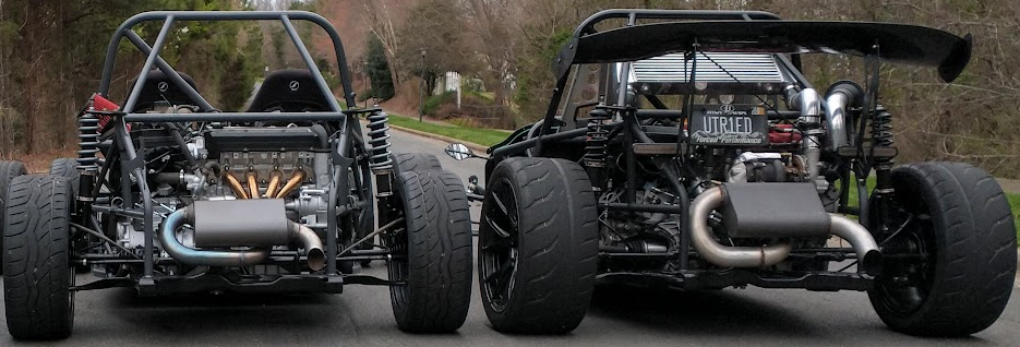

For reference, this is a view of that car next to mine from behind. I'm running a 225/45R17 which is 25" tall, same height as the Cobalt, next to a 285/35R19 which is 26.9" tall. With 19s you're going to have to run a taller tire or less sidewall. A taller tire is going to effectively lower your final drive and put you in each gear longer, in this example is the equivalent of about a 7.5% extra overdrive. Optimize has run into this and was part of the reason he sought out the 4.17 final drive HHR F23 transmission.
Also, I looked at a Falken RT660 of the same width and diameter in 17" and 19" and they weigh the same, meaning the 19" wheel and tire combo will weigh more, and the 19" tire is $300 vs $180 for the 17".

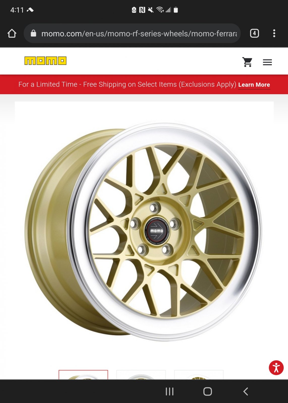

I couldn't help myself, it was such a good deal. I ended up buying 19x8.5 and 19x9.5 Momo Ferrera wheels. I'm going to have to go with 30 series tires but oh well. Cost wise, since the wheels only cost $400 for the set it should actually end up cheaper. My other option was the Momo Heritage 6 which are $1,400 for a set.

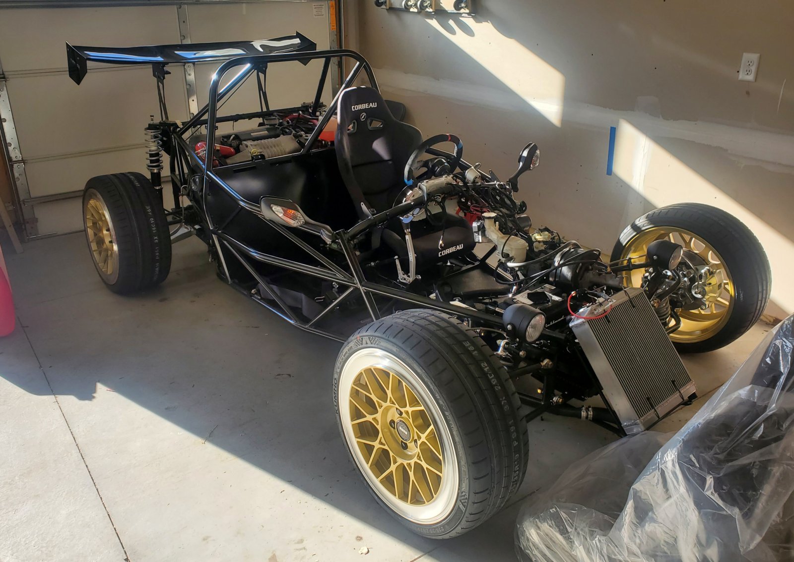

In case anyone else is considering 19 inch wheels, I finally have mine mounted. They look okay to me.
I think it looks pretty decent but I've always been a fan of gold colored wheels. Who cares what we all think, it's your project. Now, cleaning all those spokes is going to be fun.
