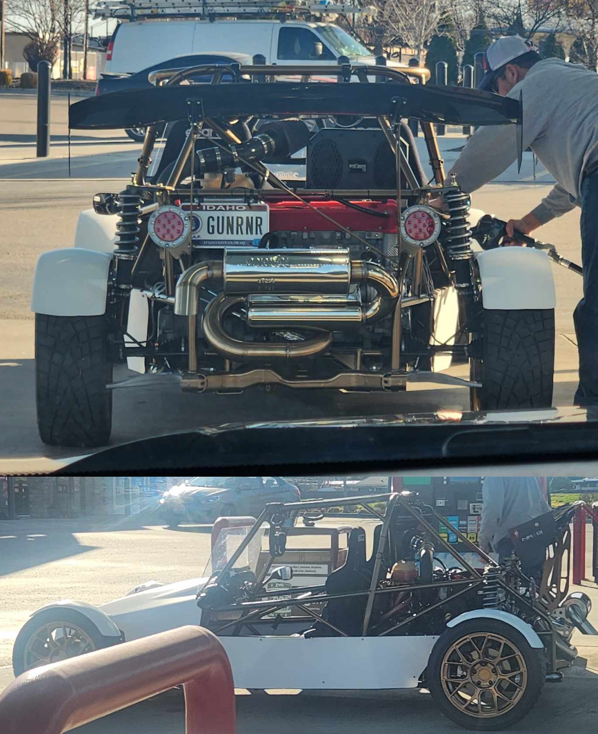

J
Spotted you out in the wild :D
Well the wife did.... she sent me a text saying "I think I just saw a goblin"
