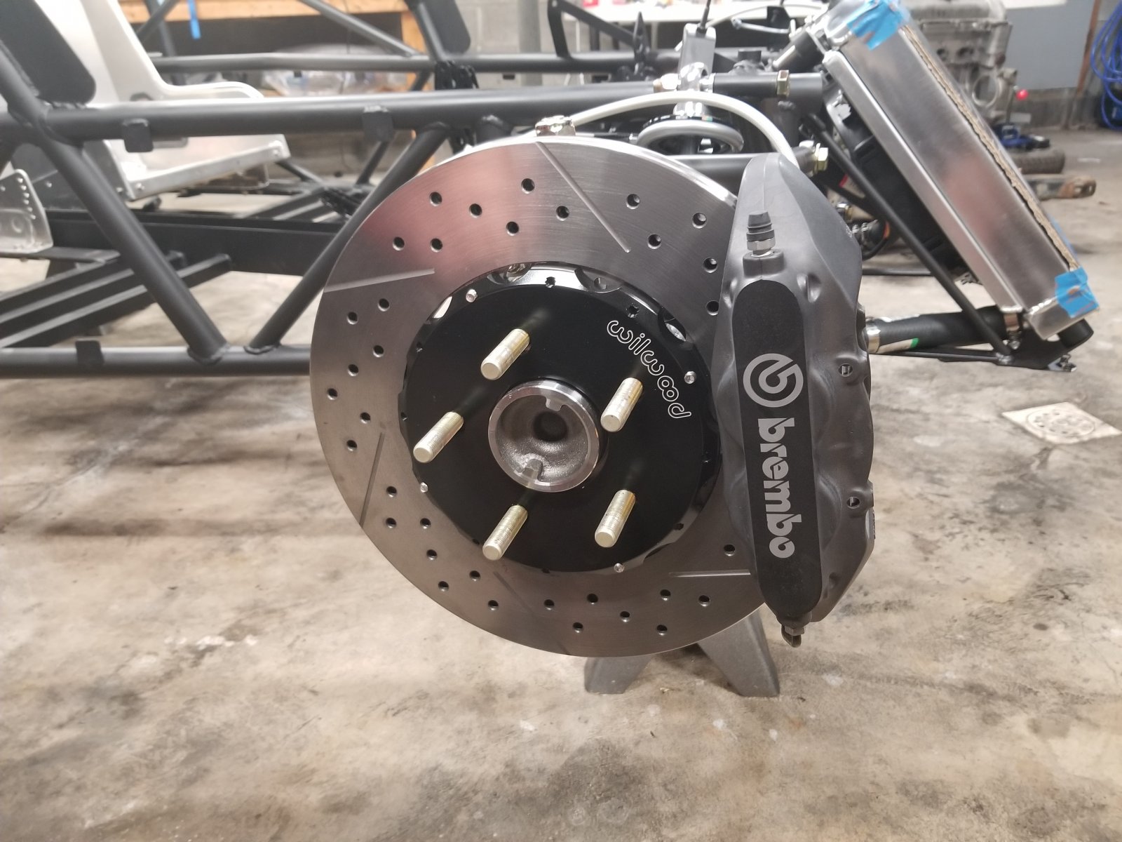

Currently I only have the front rotors for the Brembo calipers spec'd out. I am working on spec'ing out the front rotors for the normal calipers.
For Brembo Front Calipers:
This hat from Wilwood: PN#170-12159
www.wilwood.com
These are 5x114.3 hats and would have to be redrilled to 5x110 or 4x100 if you haven't made with switch to 5x114 hubs. I ordered them from Jegs.
The rotors have to be custom made, but the cost isn't too terrible. Wilwood recommended Colman Racing Products.
This is the rotor they recommended to use as the "blank" and the one I went with. PN# B810-1000-150. Just download the spec sheet I attached and send that to them.
www.colemanracing.com
Colman also offer options for each rotor. I went with drilled, slotted, and balanced.
And lastly you will need some 1/4-20x1" bolts to bolt the rotor to the hat. I chose 18-8 Stainless Steel because that is what the bolts are the Wilwood sells for this application. The only thing I have not worked out are "registration rings" to take up the difference in hub sizes, but that is a simple task for anyone with some fabrication skills.
The whole "are Brembos worth it" has been beat to death, I just want to provide this info to everyone in hopes it makes someone else's build journey easier. I'll update this original post as I figure out the specs for the other rotors.
