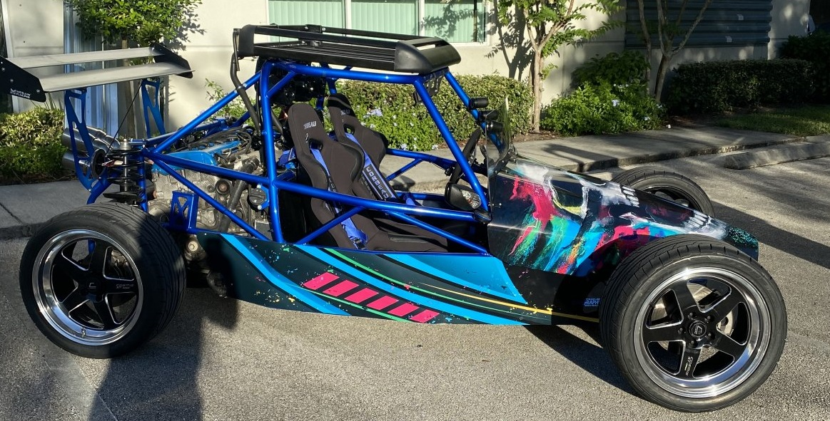

So I am doing the research for a custom brake set up and am trying to size the master cylinders.
I've contact Tilton for some guidance and they need some information.
I think I've tracked down all the right info, but if anyone knows for certain if these answers are right or wrong, please let me know.
I am planning on using the LNF SS Front Calipers.
Front Calipers:
4 Piston, 1.5" Diameter each piston
12.25" Diameter Rotor

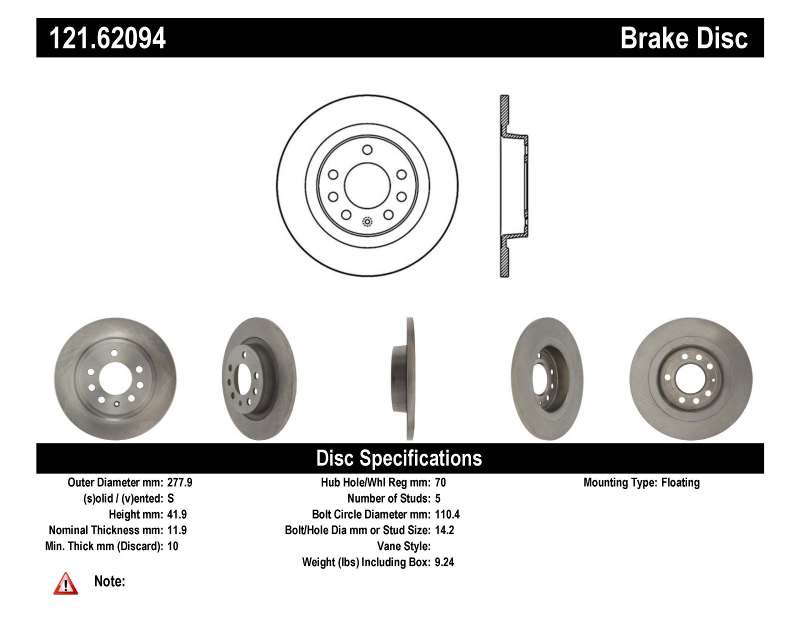

I order the parking brake kit with the goblin, so I believe I'll be getting Pontiac Solstice rear calipers and rotors"
Those appear to be a Single 1.570" Piston with a 10.93" Rotor
Does 1950lbs seem about right for a complete Extended Frame Track Goblin with 300lb driver and a full tank a gas?
Does a 40% Front 60% Rear weight distribution seem about right as well?
Wheelbase for the extended Frame - 97.5"
