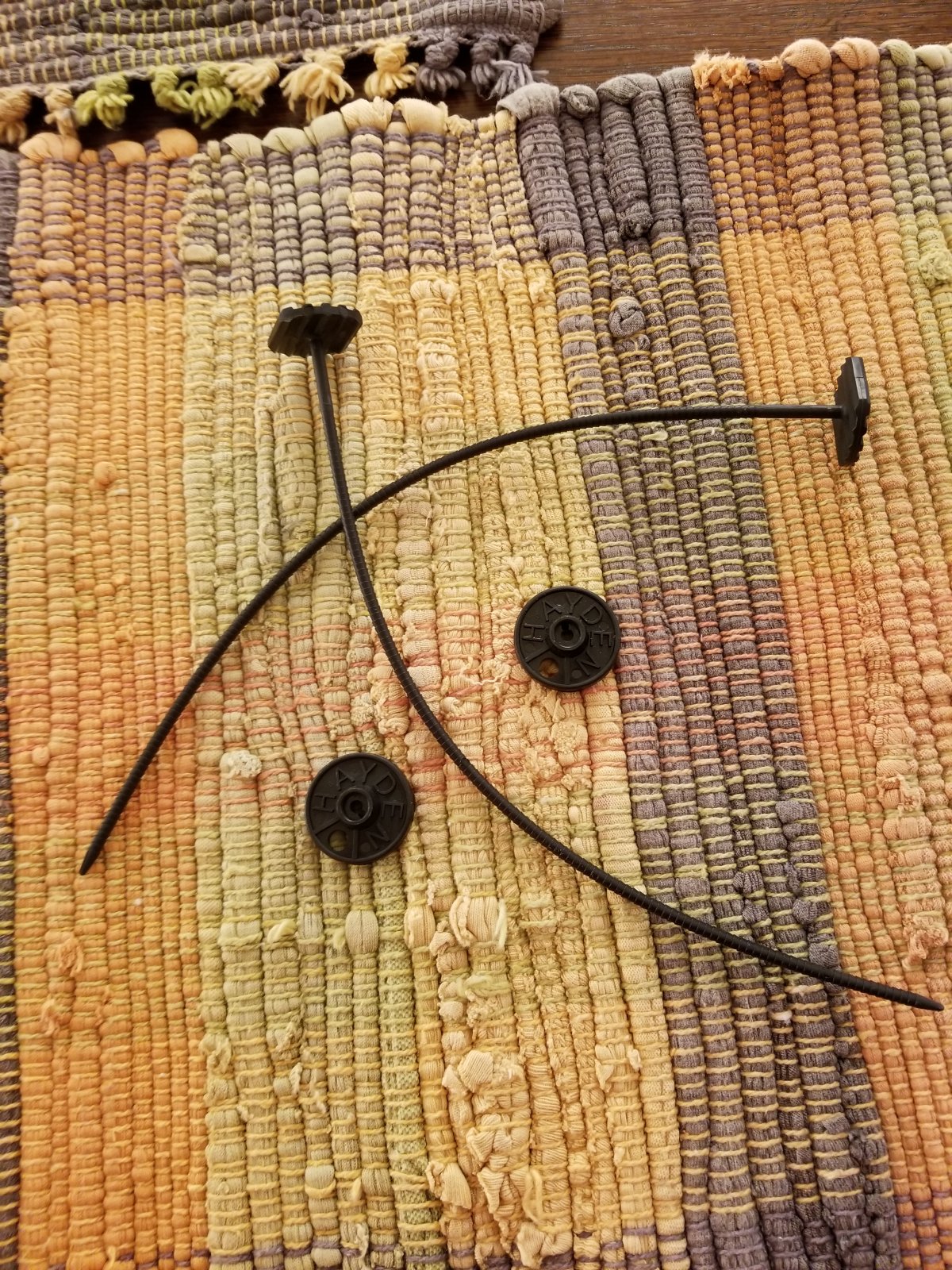

1: One of the locking discs to hold the fan to the radiator was defective. Does anyone have a part number to order a spare? I couldn’t find it online.

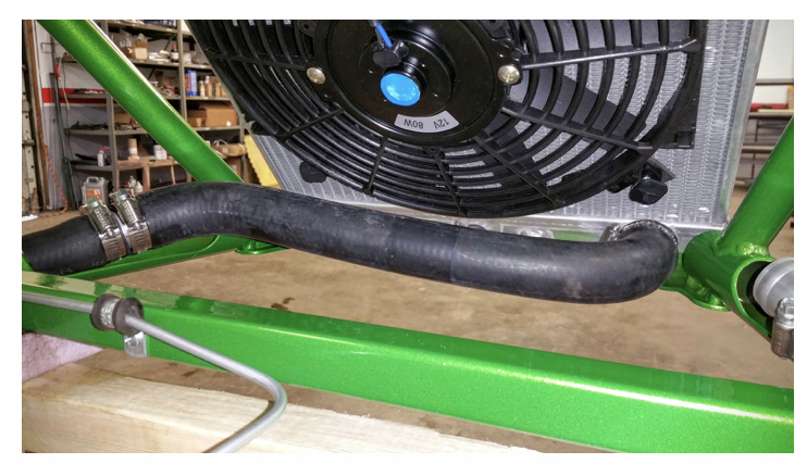

2: The build video shows the radiator hoses one way but I’ve seen it documented the opposite as well. Which way is right? Does it really matter? I’m guessing it doesn’t.

Found a couple discs with the plastic rods. Send me your address and I can get them sent off on Monday afternoon after work. Don't worry about the postage, you can buy me a beer if we ever get to meet in person.

As far as the orientation of the radiator hoses, yes it's been done both ways and the opinions are split as well. This is one of those areas that you will probably have to make your own opinion and go with it.
I personally stuck with the DF way and run the engine output (passenger side) to the lower port to push the water up and out of the radiator. The original radiator came with a cap and the air could be purged at that point but the new radiators do not have the car. I don't know if the air will go back down the radiator hose but air in the hose is not going to cause a cooling issue as much as air stuck in the radiator. That's my theory, yours may vary as so will others. I know one this for sure, never had any heating issues, not even close! It's amazing how well this cooling system does for me. I don't think the fan has ever come on.

As for the radiator hose connections, it has been a debated topic here.
As a recommendation I would follow what the auto manufacturers have already figured out and have been doing and what gravity dictates.
In other words, the coolant feed line thats goes to the water pump be connected to the radiators bottom connection. (If the radiator has coolant in it, the pump will have access to it. The radiator could only be half full, and the engine will still get coolant.)
Top radiator hose connection to be connected to the outgoing flow from the engine.
On one hand, the water pump must have a constant source of water so it doesn't cavitate trying to push air. On the other hand, heat rises and pulling water from the bottom of the radiator is where the coolest fluid will be pulled from. Every radiator I have ever worked with puts hot water coming from the engine in the top and pulls it from the bottom where gravity and thermal dynamics puts it - and there is a radiator full of water above this point to keep the water pump in fluid, not air.
The radiator plumbing has work both ways so your overheating problem is probably not related to the radiator plumbing.
