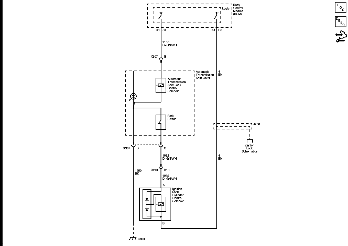

I cut some wires that I should not have on my donor. I have found the connectors and pin locations. I have a sub to ALLDATA. I also have the maintenance book. I am looking for circuit #1932. Its the circuit that connects the Shift Select Switch Park Signal from the shift selector to the ignition switch. Neither of these show me where this circuit is. I could run the wire straight but I am afraid that it runs thru the BCM and that would not fix my problem. Anyone have any idea where 1932 is runs? Thanks for any help.

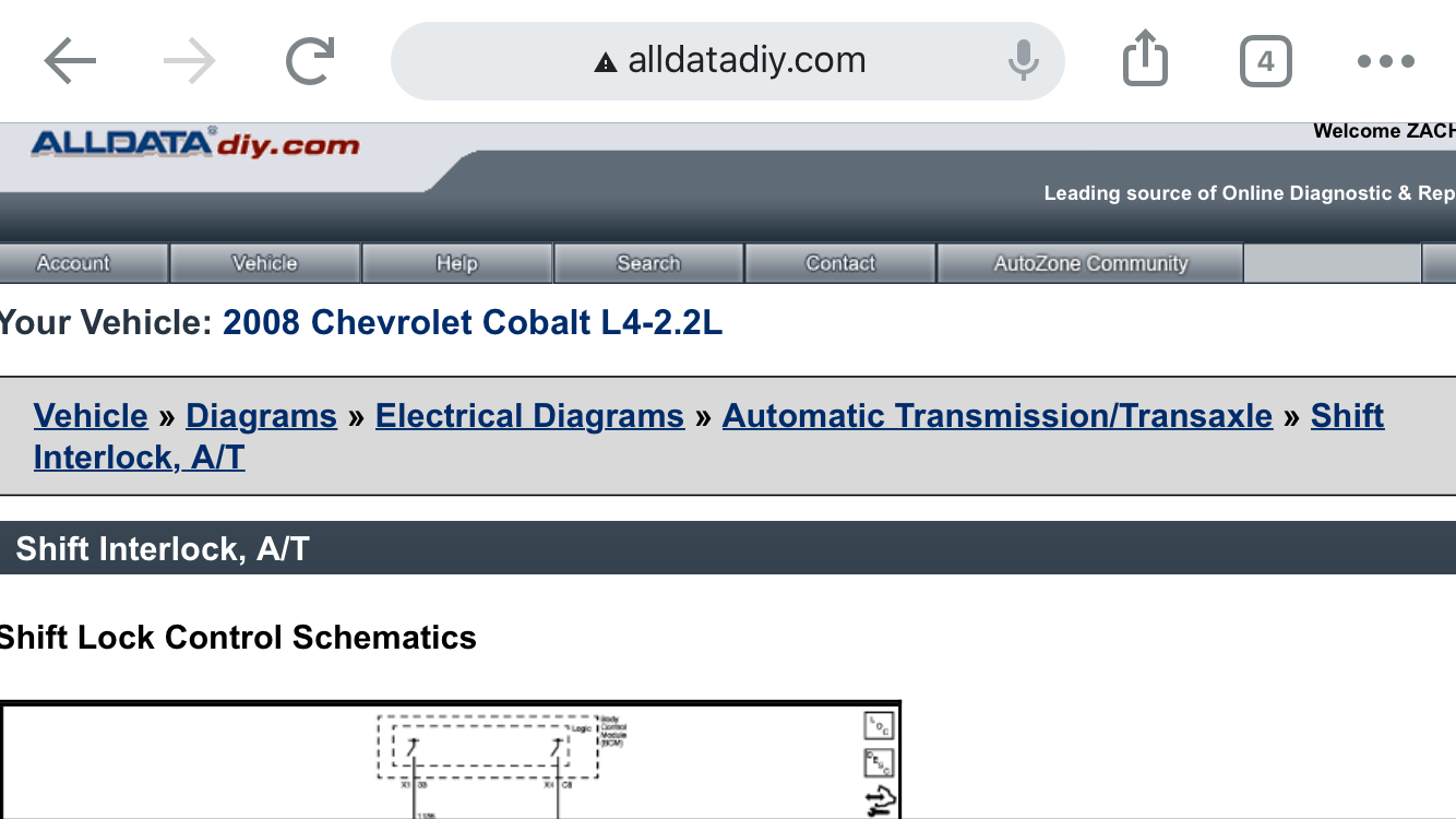

Here’s the schematic for a 2008. Yours might be different so I also threw in a screenshot so you can see how I got there in alldata.
