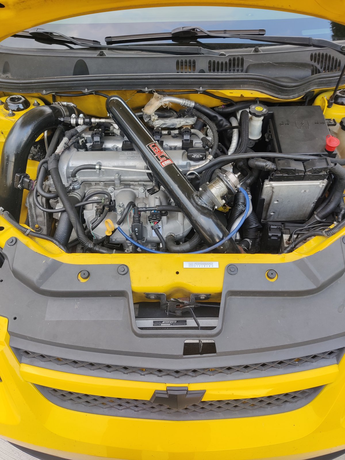

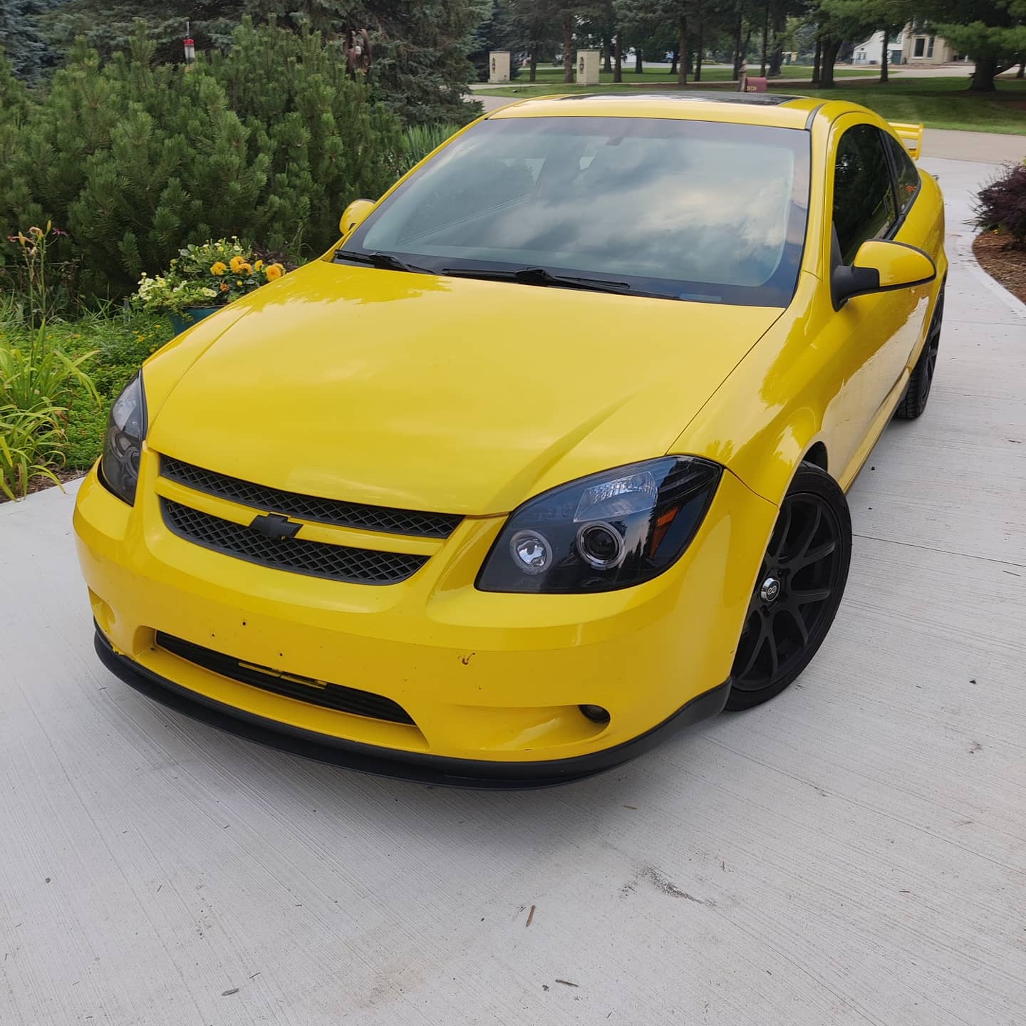

Well boys. Probably paid too much but picked myself up a donor. 2009 ss. 92k with one of the cleanest engine bays I've ever seen.
L
You will do very well selling many of those parts and help to cover the purchase price.
I hope so too! I figured I will drive it this year and put in a build order over winter for spring time delivery. I have a spare turbo, fender, and some clutch pedal adjuster thing that the prior owner said was like $150 laying in the car.

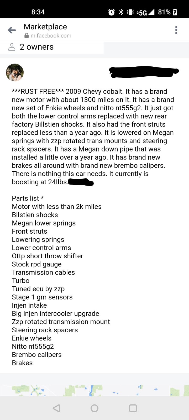

Be sure to measure the ball joint stud diameter since you have an ss/tc and indicated that the lower control arms were replaced. The TC's have a 20.5mm ball joint stud while the rest of cobalts have 19.5mm ball joint studs. Some suppliers just sell the 19.5mm for the TC's and they end up causing issues. Specifically, this can cause some play in the front end of a cobalt and the back end of a goblin that is undesirable.
You can also resolve this issue with DF's rear suspension that is in development. Looking at your build time frame and I bet it will be released by then.
L
Thanks! I will check it out and see if the correct spec was replaced.
