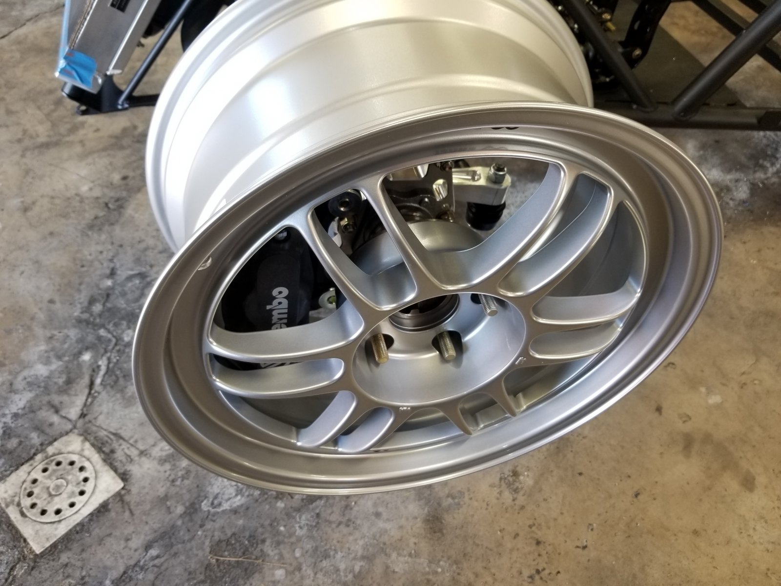

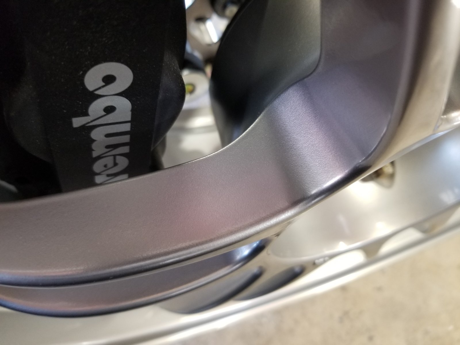

Why should the Enkei RPF1 be avoided?
I have yet to see someone run them without needing a spacer.
My RPF1s have tons of clearance with my Brembo calipers. IIRC from the Cobalt guys the Brembo are the biggest clearance issue with aftermarket wheels for them. This is without a brake rotor. I'll gain atleast another 1/4" of clearance with a brake rotor installed.
