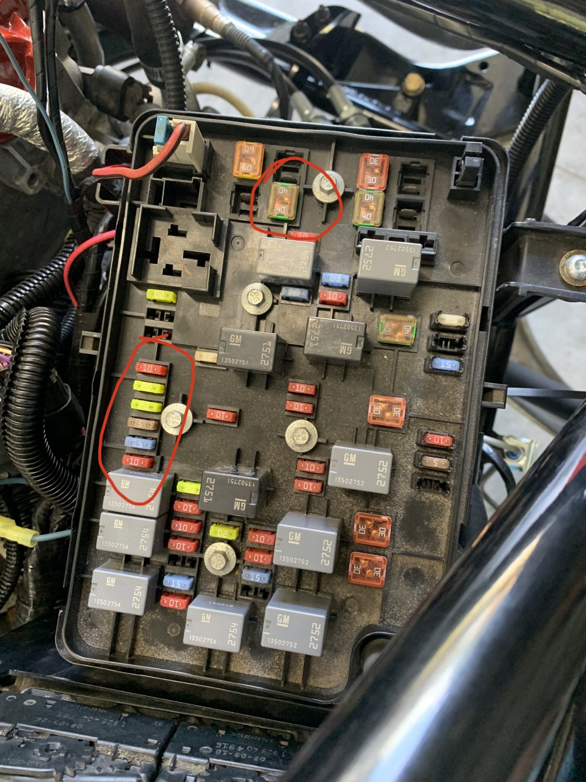

So I’ve finally wired up the heat exchanger system and have the pump connected to the main abs block. The issue is that it’s not key on, but just on all the time. Does anyone know if it’s a ground issue or does it need a separate relay?
My notes show it should be on fuse block X5 pin B2 which is ignition voltage so should only be powered when the switch is on. It should be powered by the run/crank relay. Pull that relay and see if the pump cuts off.
Stretch2126
The 40 and the other pins as well as that whole row of fuses stay hot regardless of the key.
