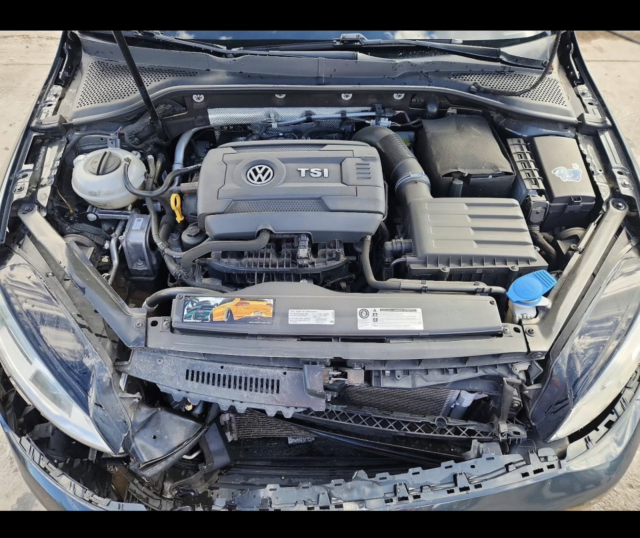

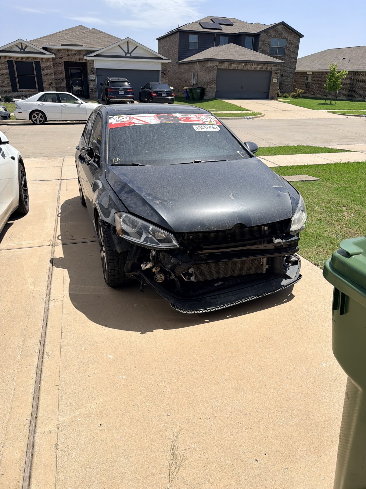

Here’s the donor the day it made it home. Hopefully the next pictures will involve a lot fewer body panels and a lot more progress!

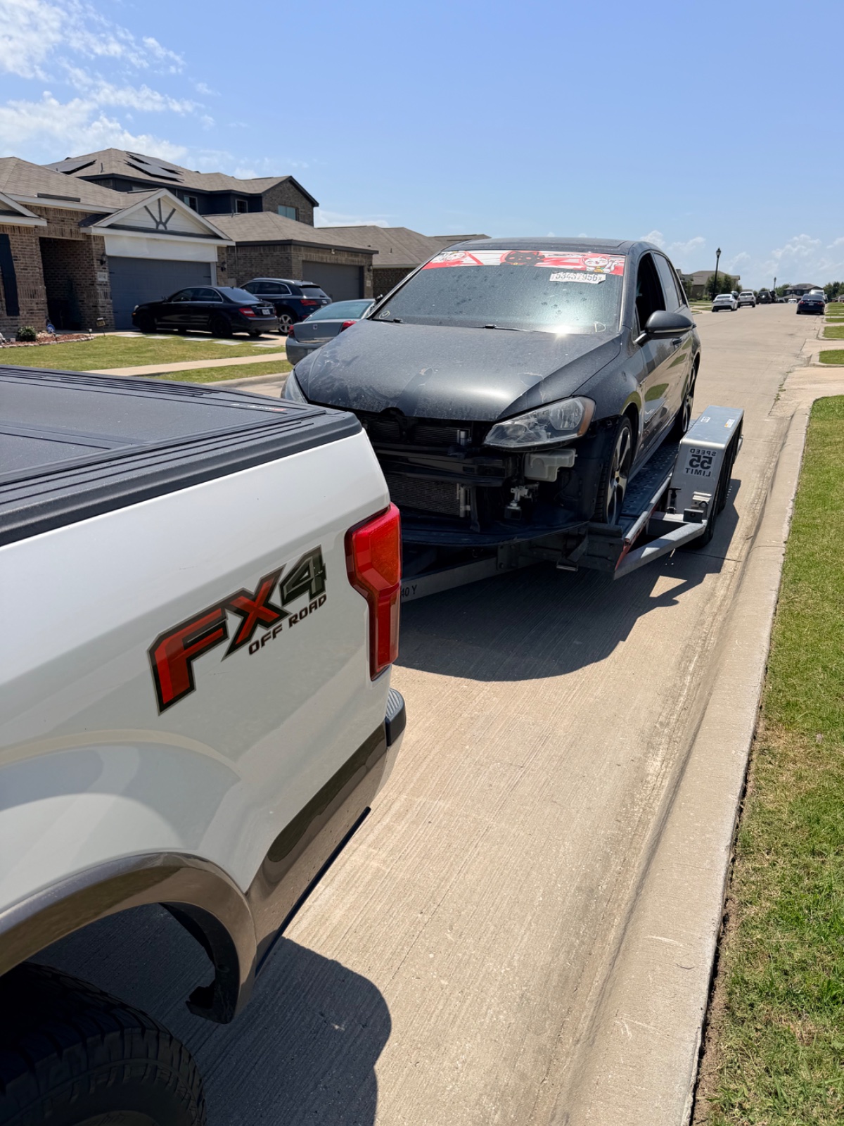

I heavily considered trying to drive it to Adam instead of trailering it. However, I was worried that with the radiator cracked from the front impact coupled with the wonderful Texas summer, the engine would overheat and cause damage.
So in erring on the side of caution, I probably won't do too much testing of its running state prior to the tear down. I plan on taking it to the Red Oak shop next week.
