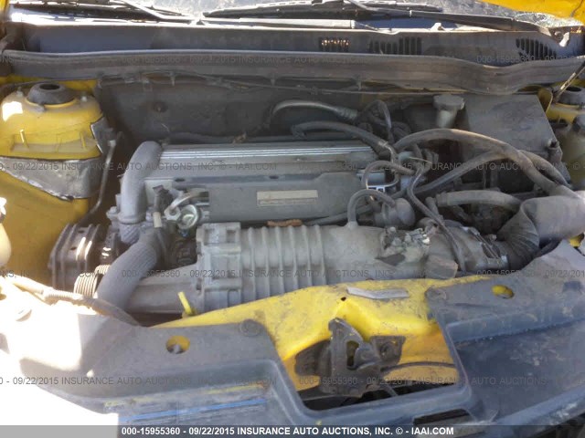

I'm planning on checking out a potential donor at a local IAAI yard. The front took a substantial hit like many have. Does anybody have the measurements for the front sub frame bolts so I can check if it's still square?
Also, does anybody have experience inspecting a vehicle at an IAAI yard? I want to know if they'll let me try and crank it over. It's listed as not running, but looking at the photos, the intake tube is pinched off right before the throttle body due to the accident. I'd like to remove the intake tube and crank it over if can, to see if it will fire. Think they'd let me?

When we get back to the shop in the morning I will pull some dimensions off one of our spare sub frames.
If you find it is deformed we can send you one of ours when we ship your kit,
