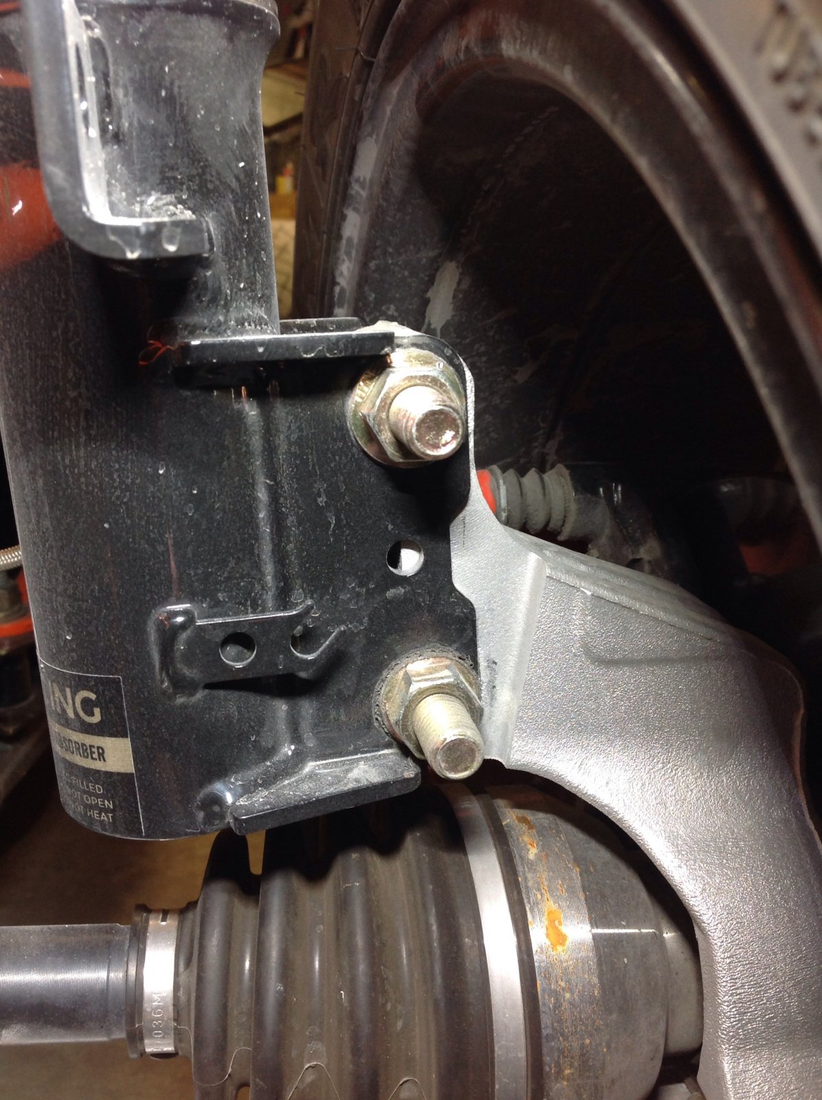

I dumped the adjustable bolts. See my thread about them being loose and causing all kinds of problems. Went back to solid bolts and adjusted the camber using this sight hole (between the upper and lower bolt) in the BC coilovers. Make it the same on both sides and that should get you **** close. If you need to tweak it more, the slots in the BC should allow for adjustments.

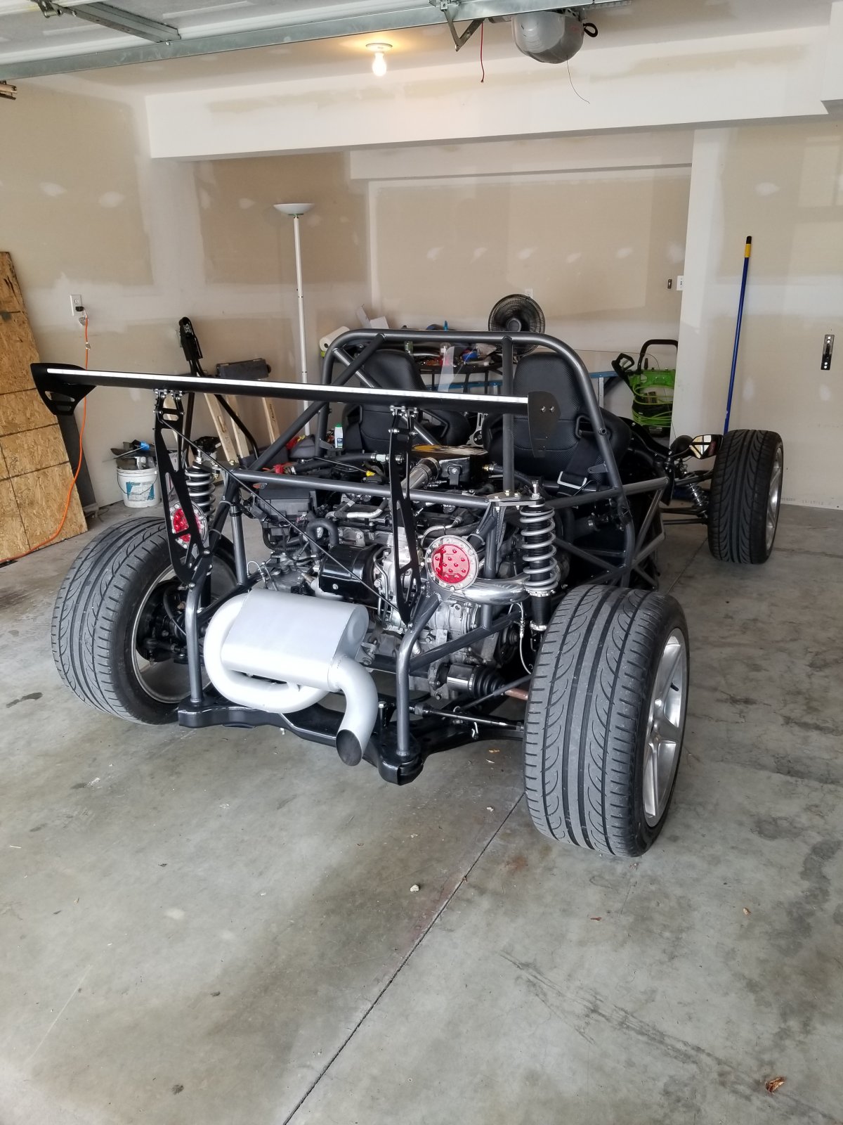

Also finished wiring up my wing as well as the resistor to enable cruise control. We'll see how that works once I have my button panel.

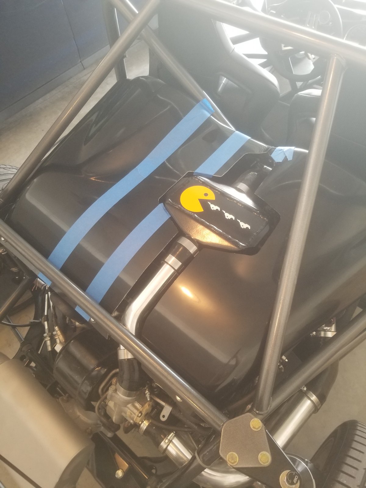

Finally, I cut and test-fit my engine cover. It's not perfect, but it's pretty close.
What's left?
  1. Trim off a little bit of the front third of my tunnel cover then rivet it on (my harness isn't shaped perfectly up there)
  2. Take my seats out (again) and untrap the crotch belt from under my seat brackets (woops)
  3. Drill the holes for the side panel rivets (yes, I will avoid drilling into my coolant hoses)
  4. Wrap/mount side panels
  5. Wrap/paint hood/engine cover
  6. Wire up license plate light/drill holes for future license plate mount

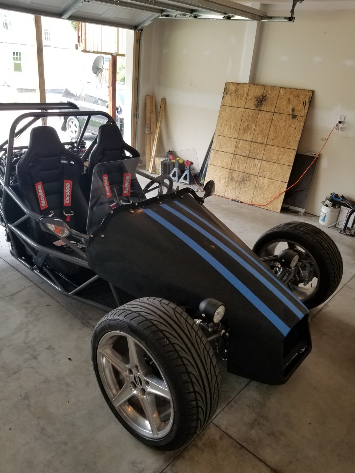

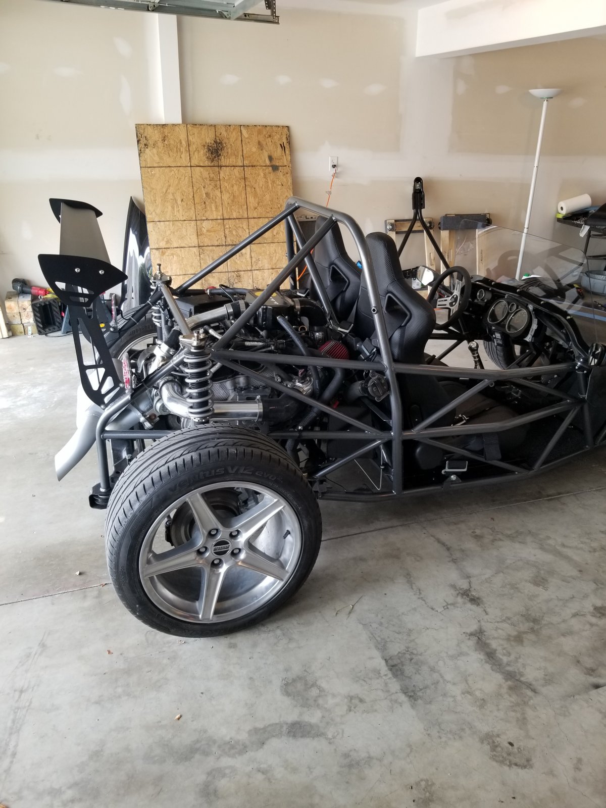

Some obligatory "almost there" pics. It's very difficult to resist the urge to drive this thing out on the street, but I MUST resist!
