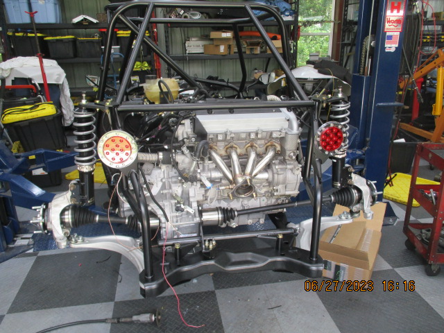

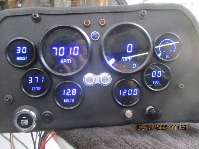

wallace58
Affordable Fuel injection did a stand alone harness for my LSJ , we used the GM ECU. I did my own dash and wiring for the rest. If you are sticking to the GM dash the BCM must be used unless you are a tech wizard, LOL. ;)
