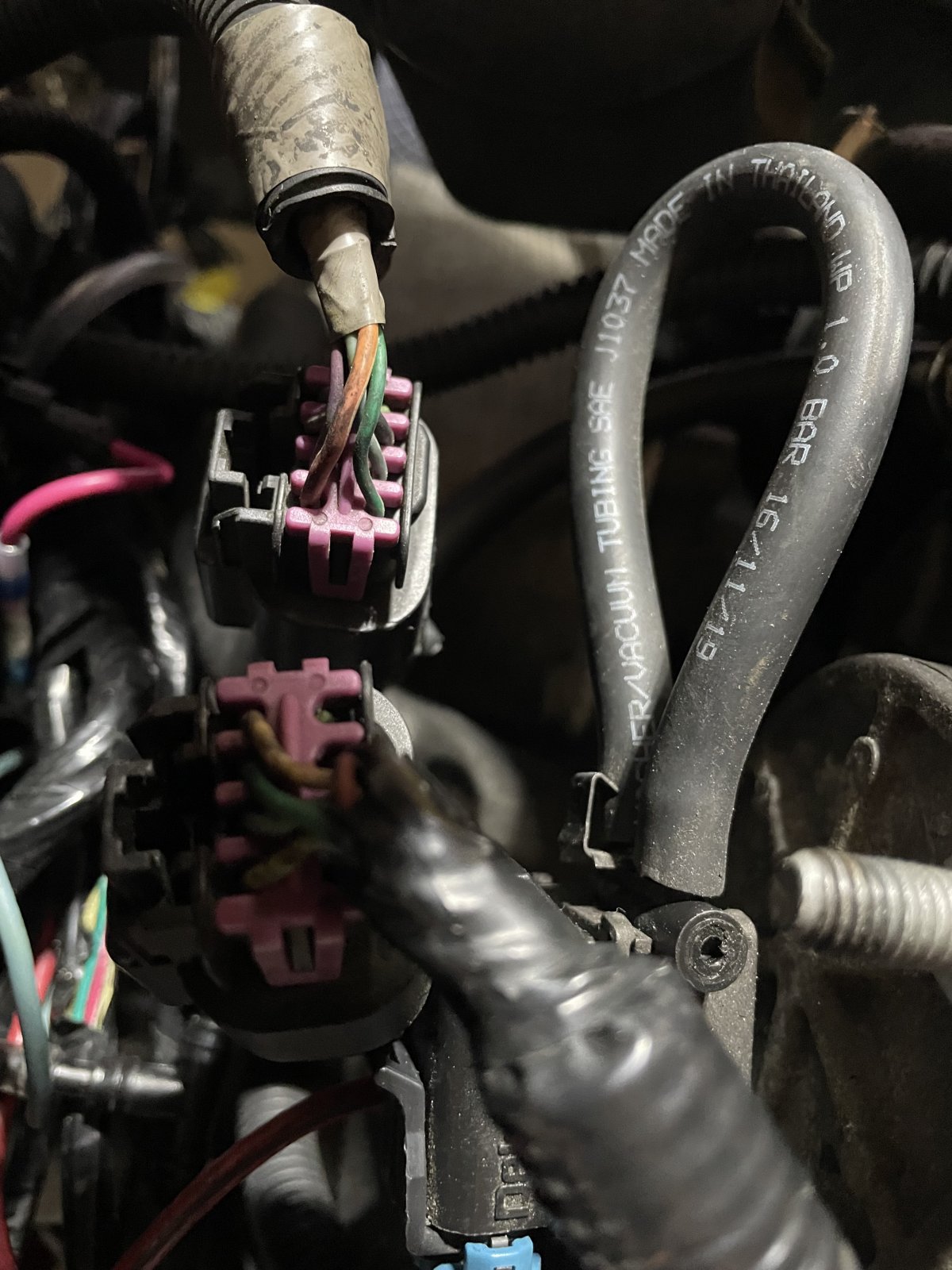

On my 2006 SS/SC there are two black connectors with purple insides. They are both between the engine and fuse box space. They will allow interchangeable connections, how do you tell which one is right? Of course, I didn't label anything here like I should have....

In Position A (should be marked on the connector somewhere), the Engine Harness to Ignition Coil Harness connectors should have a Pink/White wire.
In Position A on the Engine Harness to Body Harness connectors, there should be a light green wire.
Basically if you have the engine harness side of the connectors in your hand, one goes to the the body harness and one goes to the coil pack harness. The coil pack harness connectors have the same colors on both sides, while the body harness connectors have a couple colors that change on either side of the connector.
I'll give this a look tonight. Thanks for the direction.
escapepilot
Someone correct me if I'm wrong, but it also looks like the boost solenoid is in your pic and has a hose looped from top to bottom. The bottom should be open to ambient air. Mine had a filter on it. I think the top goes to the black cylindrical valve on the supercharger. I can check when I get home.
Yeah, that's the way I got it so I'm leaving it. It made 15 psi boost like that, but I do recall the kid saying something had failed. That this was a way to bypass the item that was messed up. I'll play with it more once the Goblin is rolling, but I didn't want to mess with anything beforehand.
Adding this in the mix, if your SC Goblin doesn't fire after turning over a bunch of times then swap your two identical black w/purple connectors by the fuse box area....
