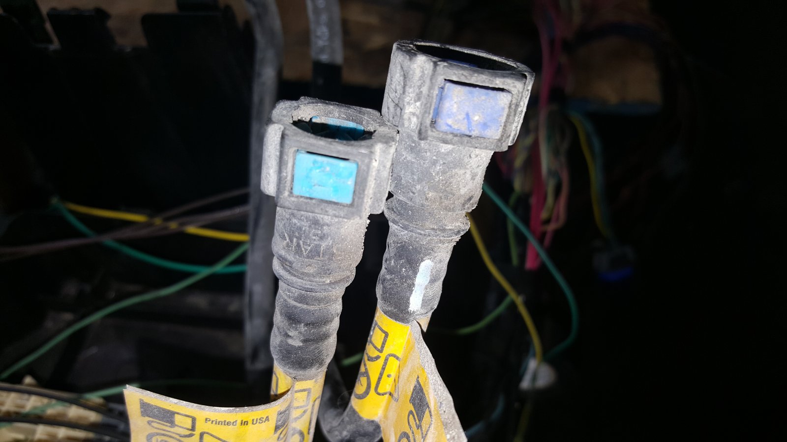

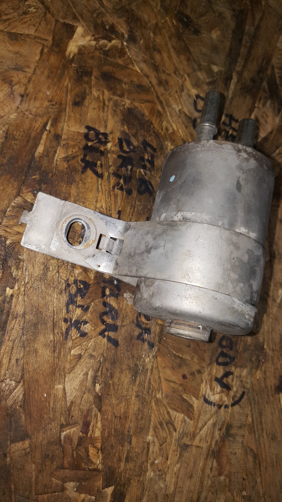

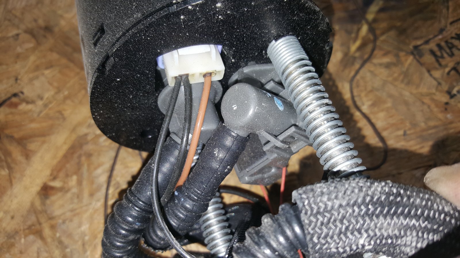

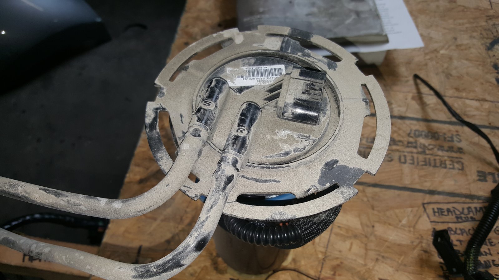

The fuel pump is marked supply and return.
This image shows the fuel pressure regulator.
These are the supply and return lines that go to the filter.
This is the filter, it free flows through all three ports.
If someone wanted to use an external pressure regulator and needed a return line they could remove the internal regulator and hook to the return port on the top of the pump.

Good info here. I understand now how the regulator works in this system. With the return line at the filter, I guess it just loops the fuel there after the pressure is at it's limit.

As you seen with Lonny's post, there are two lines going to the filter. One is a return.
