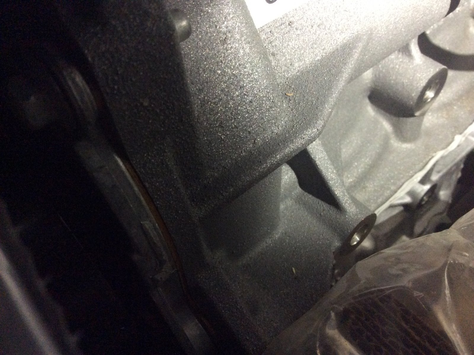

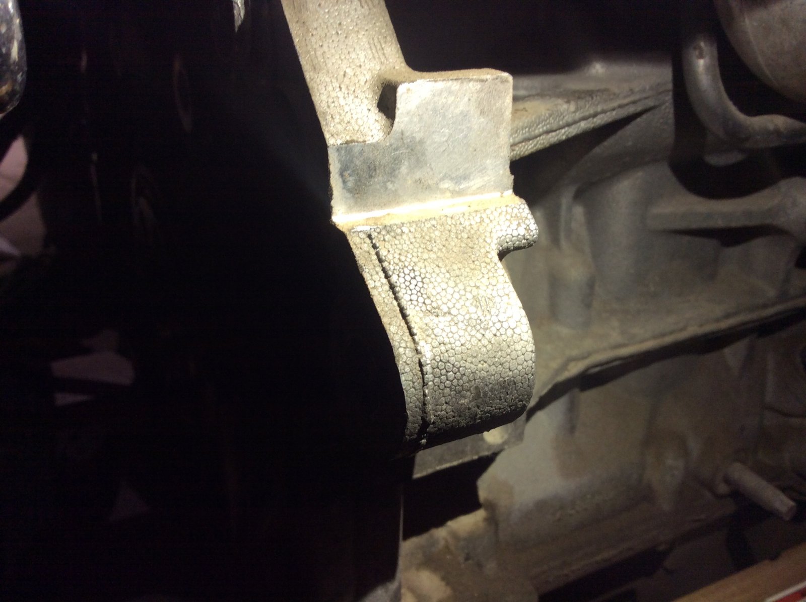

I just received that eBay motor as well and i am very pleased. You can tell right away the casting on the block is much better than the motor out of my donor. I read that the euro engines are a much better cast and stronger I can physically see that. Here is a photo of the old engine block you can see all the gaps in the metal

Here is a photo of the new eBay euro engine. A much better casting
That auction looks 100% legit. A good motor at a great price and it looks like they're going fast.

It’s a great deal the turbo swap alone is about 1k and this comes with the new turbo. I talked to a shop owner who said GM closed a bunch of small car plants So these have flooded the market at a great price. Not sure how long these will last, but it happened at a good time for me. Here is my old engine number 1 cylinder

Sand casting versus foam casting: please note this is from GM. The external appearance of a cast part does not affect the integrity of the part unless it is very thin - not the case with an engine block casting. The difference in strength between engine blocks will be derived from the casting thickness and structural webbing of the design.
A Design Study in Aluminum Castings - GM Cylinder Block
Green Sand versus Lost Foam
The traditional method of casting cylinder blocks is green sand casting, where the mold cavity is formed in sand with a wood or metal pattern and multiple sand cores to form the internal passages.
A comparison of green sand casting to lost foam casting shows a number of distinct advantages for lost foam.
Property
Green Sand Casting
Lost Foam Casting
Complex Internal Features and Part Consolidation.Complexity determined by sand core limitations -- geometry, strength, and cost. Extensive and complex internal features (as small as 0.20") available in lost foam, based on detail duplication and pattern assembly in foam.
Dimensional Tolerances+/- 0.030" is typical depending on part size, complexity, and geometry +/- 0.005"-0.010" is typical depending on part size, complexity, and geometry.
Surface Finish Capabilities250-600 microinches typical. Depends on grain fineness of sand. 60-250 microinches typical. Depends on bead size and ceramic coating grain fineness.
Feature AccuracyCore movement and shift between mold halves across the parting line limit feature accuracy. No cores or mold halves to shift and degrade feature accuracy.
Parting Line and Draft AnglesParting lines and draft angles are necessary for molding. No parting lines in the mold and minimal draft on tools.
Environmental CostsSand recovery requires binder removal and time consuming sand clean-upSand is binder free, so it can be easily and rapidly recovered at low cost.
Tool LifeWear on wood and metal tools from sand abrasion Low wear and long life with aluminum tool
15
Copyright 2004 by the American Foundry
Society All rights reserved.
Address comments to: [email protected]
Last Modified:August, 2004 by STG​
Page 1
